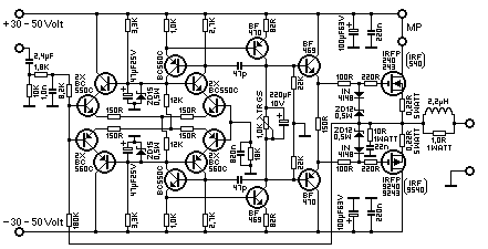

If I parallel with another pair,
where can I connect?

That amp will blow up after time because it has no thermal compensation.
Are you going to try and lay that board out yourself? Because it will be quite sensitive to board layout, a simpler design would be advised.
You would add additional parallel output devices by replicating the gate resistor (220R), MOSFET and source resistor (0R22).
I suggest you just build a proven design that is right for your needs and skill level, or you will simply waste time and parts and get frustrated.

I already test that.
Not Use Relay at SPK out.
In bridge circuit
USE normal buffer & normal inverting OP amp.
So I want to test in safe mode
1 amp fuse blown out with 2X 8ohm 100 watts spks.
Which fuse must use for that circuit ?
What RMS will out?

I have already told you my thoughts on this circuit, you are experiencing exactly what I predicted. The power of the MOSFET is not the issue, the flawed circuit is.
I think it can stable in normal ( not bridge ).
My bridge burn out that I predicted in above.
Is that because of Mosfet?
Is that because of driver circuit?
richie00boy
Do u mean my hole circuit is not good ?
OR
Is the only problem driver ciruit ?
Can MOSFET handle more power than I predicted ?
In bridge unstable
Can anybody redesign my circuit in bridge mode?
Can that be stable if I parellel MOSFET ?

richie00boy is right, you're wasting your time and money on that circuit.
If you want a bridge amp to run on ±50V, I suggest you use two pair of the MJ15003/04 per half bridge (a total of eight outputs per channel). Crown does this in their Macrotech 1200, a good design.
Depending on how 'stiff' your supply is, you will get about 500W~600W at 4 ohms.
