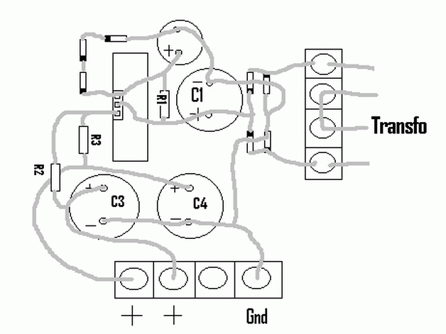

you have to post a drawing of you power supply circuit _exactly_ like you built it.
you have to post a picture of it.
if you tell "i built like in the article" it will not help, because like in the article it works.
I made a dram on "paint" of my "board" but the image is to big, I can't put it on the forum, how I can do to reduce this image ????
Yes but it work !!!!!
For R2 and R3 I use 52 ohm resistor, and there 2 V between each when the circuit is connect !! !!! This is normal ???
