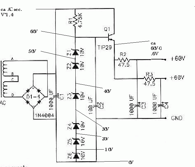

arold19 said:I need some help please !!!
At the output of the power supply of my Bridge of Zen, I have 60 V, but when I connect it to the circuit, it drop to 28 V.
Can you help me, I don't understand....
I tried it with no cd player and with no amplifier....

ok, you gate ist ok at 7,5V. The drain is at 60V instead of 20V. This means there is no current flow trough the FET and the 1k resistor, because else there would some voltage of these 60V get lost across the resistor (40 of them ). This means a) your Fet is dead because with 7,5 V over the source at the gate there should flow current or b) you wired it not the right way/ check pinout, is there a connection between source and GND.

but now, I have a serius problem with the power supply, When I get off R2 of the power supply, all was Ok, The 60 V at the output was perfect, but when I get off the resistor of the other channel. the TIP29 broke in fire !!!! I realy don't understand ! Now, I change the TIP 29, this new TIP29 doesn't burn but I don't have 60V at the output, I have nothing.
All the 93 V is in R1. I have nothing in the zener.
Do you know what is happening ???

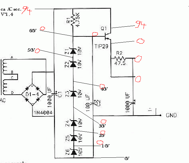

You mean you have 93v across R1? If that’s what you mean I’m guessing something is shorted or C2 arched.
When I look with my multimeter, the resistance between the base and the ground is 0 ohmm this is normal ??? what mean arched ???
You have 93V out of the power supply, and i think 93,6V or so at the base of TIP29?
The connection in the chain of zehners is broken, maybe because one or more zehners is smoked.
arold19 said:When I look with my multimeter, the resistance between the base and the ground is 0 ohmm this is normal ??? what mean arched ???
Arched may not be the correct term, I mean "welded", closed by too much voltage.
If you take it out of the circuit and measure it with a ohm meter, and you get a low ohm reading it’s closed, and needs to be replaced.
No. Zero ohms to ground is Not A Good Thing.

Today, I take out the capacitor of the circuit and the value is 2,3 M ohm I thing that the cap is Ok !!!
It is not normal to have 0 ohm between a zener ???
To see if the zener are ok, I can try the power supply without C2, I suppose to have 60V !!!!!

be more precise in your description so it will be easyer to help. Where is 0 V at the zehners? Make a drawing of your circuit and points you measure some voltage and post so we are enabled to understand. A cap shouldn´t have Ohms but Fahrads.
or otherway: this means there is no connection between the R1 at + and the zehners, or the zehner chains resitance is 0. I don´t think you damaged all the zehners in the way they are 0 Ohm resitors now. So R1 needs to be replaced - or there is another reson why there is no connection -> check the connection.
