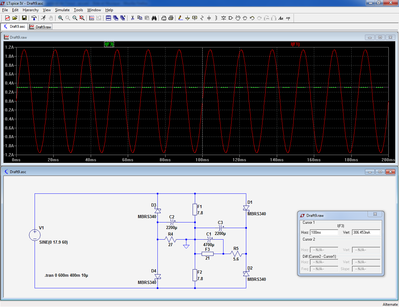

I have a transformer with just one 12.6V winding. I really want the first stage's heater supply to be DC (6.3V) for noise reasons. The second stage (2x ECC99 PP) draws so much current that regulating is impractical and AC is fine there anyway. Is it possible to properly use one winding for both regulated DC and AC?? How about ground reference. Charging peaks etc.

Yes, that's what I did. And I tied the DC 0V line to the GND of the rest of the circuit for reference. But I'm getting a lot of 50Hz interference and suspect the culprit being the unbalanced AC heater wiring. The AC before the rectifier is no longer a nice sine wave and I don't see a way to balance/ reference it.

Here is a "creative" solution: it is not too wasteful, it remains balanced, and all filaments share a common that may be grounded if desired.
I assume the 12.6V filaments F1, F2 have a CT.
F3 is the 6.3V 300mA filament. The current can be fine-tuned with R5.
R4 is a dummy load, required to rebalance the bridge formed by the two high current filament.
The dissipation is the same as in the low-power filament, which is still tolerable

Exactly! The AC becomes so f'd up, I tend to think the interference is I'm hearing is at least partly caused by this. Plus the inability to connect a humdinger between the AC leads (because the DC part is already grounded). worsens this effect. The transformer doesn't have a CT, so that's not an option.
This variant reduces the peak currents in the windings:
How do you come up with this stuff! I'll breadboard the whole thing and report back.

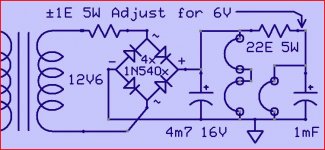

A simple way to do it is like this.
The resistor "1E 5W" (1 ohm) depends on the (unnown) losses in the transfo and diodes.

Ah, a DC option, without the use of a regulator. That would resolve the issue with high current demands etc.
