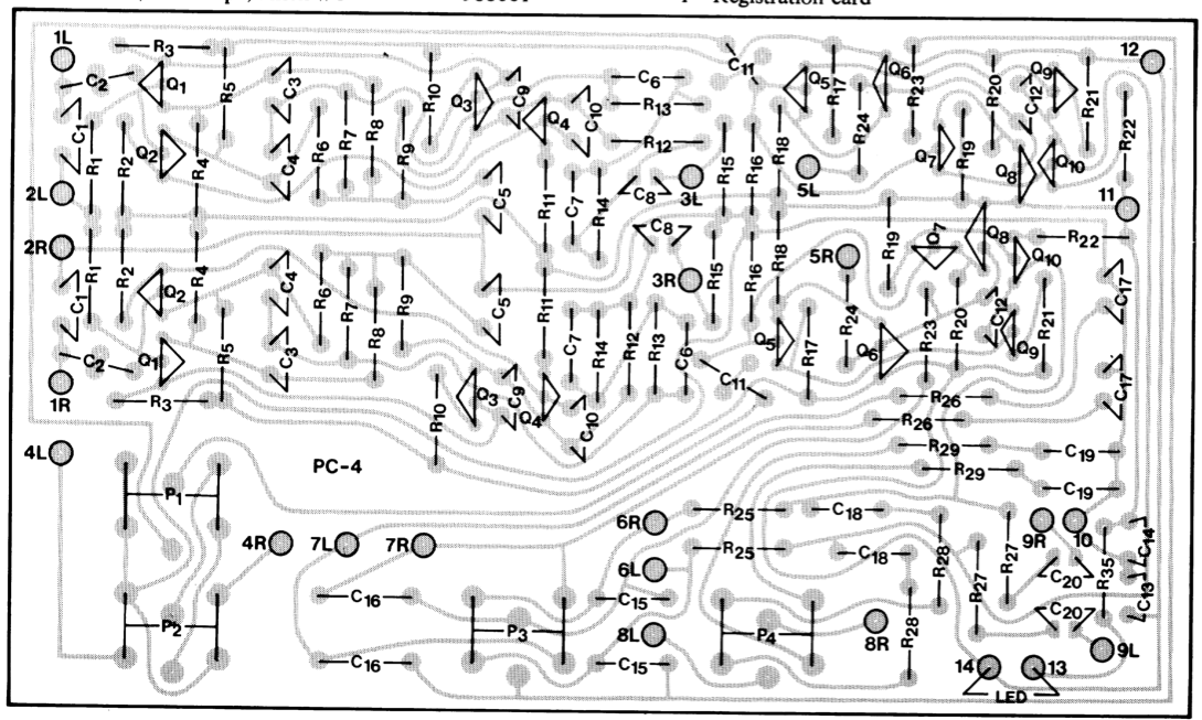

Could you circle the phono sections (probably easier to do on the board layout, and not the board photo) and also what things I could (if I should bother) to remove so the phono preamp section no longer is part of the preamp? I ask as I'm going to replace the resistors with 1% metal film ones, and only want to replace the resistors in the line level, tone, and output circuitry.

This thread looks familiar. Now that I understand what you want to do, and can almost understand the schematic, can maybe help. The eyelets are marked in the schematic as small circles with an x in the center. Both phono inputs go to the first set of switches, then to eyelets 1 and 2 of the pc-4 (left is 1l and2l, right is 1r and 2r. Eyelet 1 is the signal 2 is the ground. The output of the phono preamp is (this is missing in my copy which is probably the same as you have) are eyelets 3l and 3r. Simple way to bypass phono preamp would be to disconnect eyelets 1 and 3 from each respective channel, and connect them together. Resistor components for tone and high level can be determined from the schematic.

Main line in would be eyelets 4l and 4r next to the balance/volume pots on the board.

Staring at the schematic some more. It seems (please correct me if I'm wrong) Page 12 is the phono section of PC-4, and Page 13 is the part of PC-4 that I care about. So the phono section is comprised of Caps C1-C10, Resistors R1-R15, and Transistors Q1-Q4. And IF I removed all these components, I would still have a working preamp with no phono section?

eyelet 1 is the phono input, eyelet 3 is the output. removing these will isolate the phono preamp, except forconnections to the power supply. Removing the resistors listed in post 3 will totally isolate it, but IMO is not necessary. Ifyou connect the wires going to 1 and 3 together, the phono inputs would become high level inputs.

I did part of what you want to do to My Hafler back in '83 when in was 4 years old and I got my first CD player. I disabled 1 phono input and added 1 line level input while you just want 2 lines and no phonos. You don't need to remove the phono preamp, just completely bypass it though removing the power to the phono stage assures no chance of spurious noise. It would require no trace cuts or jumpers on the PCB, just changing a little of the chassis wiring to the back panel connectors and the input switches. Electrically trivial but mechanically only a bit tedious. To disable the phono preamps I would lift (unsolder) one end of resistors R2, R3, R10 and R11 which disconnects power for both channels but if you ever want to restore it you'd simply reconnect the components. Disconnect the wires to 1L, 1R, 3L and 3R so you get no signal to and from the now disabled phono preamps. Connect the wire removed from terminal 1L and connect it to the wire removed from 3L. Do likewise for 1R and 3R. That should do it and still be 'restorable' if you ever want to sell it. The signal path for the new line inputs will be going through a lot of switches but no worse than unmodified.

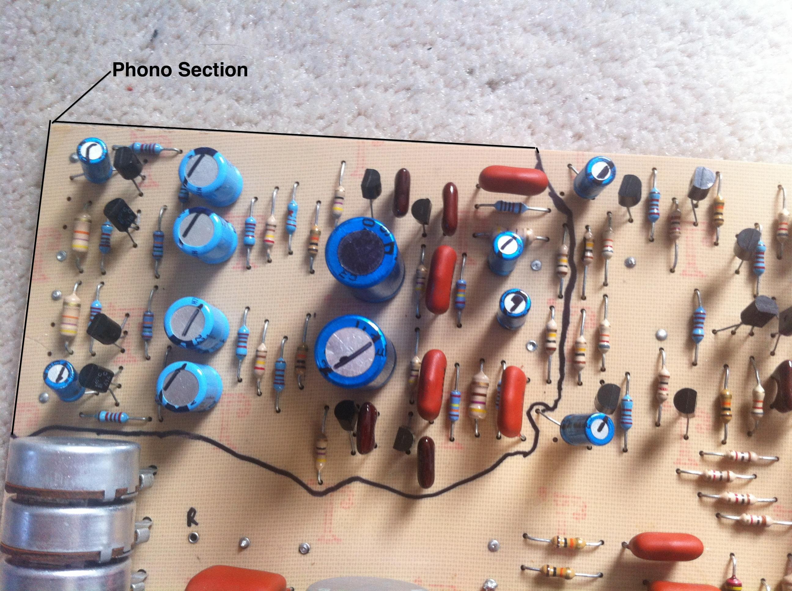

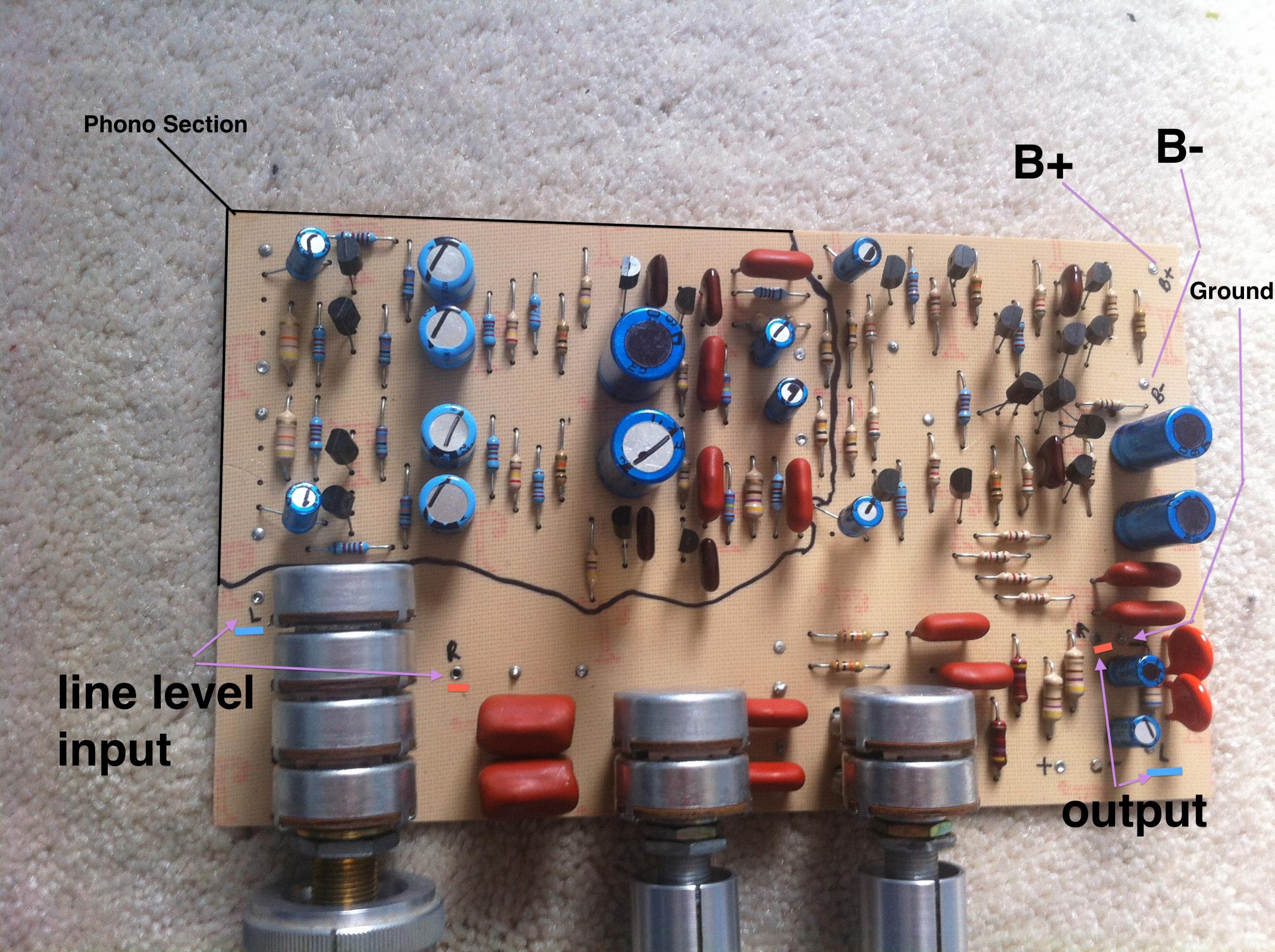

Well I had an extra PC-4 board laying around (Pervious owner had butchered some traces, so I don't care about it.
I drew and labeled the phono sections, line in eyelets, and the output eyelets.
Also labeled the B+ and B- as well as ground.
Just wanted to make sure I got it right.
How does it look?
