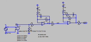

I'm putting my bets on something simple like the signal not making it into the first opamp, or from the first to the second stage. With plainly audible interference, the circuit seems to be powered and doing something at least. That may also be an indication of it oscillating wildly though. Breadboard is breadboard after all and has a few traps to offer. It certainly can't hurt to check all resistor values either.
BTW, that circuit is not very well optimized. Its distortion performance and noise floor should actually improve when swapping the two stages around, at the cost of a single extra resistor for the output (big deal). Right now the noisier stage is at the input and the broadband amplifier is subjected to high levels. I've tweaked resistor values a bit and moved the 75 µs pole into the (now) first stage, the result being:

Try some basic DC voltage tests with a meter. Use the input ground as a reference point and confirm that both opamps have a correct plus and minus supply voltage on pins 8 and 4 respectively. Also check that each opamp output pin is within a few hundred millivolts of zero. The type of 1uf cap won't make any difference, you could use a correctly polarised electrolytic.

I'm interested in using this circuit.
So you have taken out what I assume to be the RIAA equalisation at the end of the original circuit (C4, C5, R9) and suggested I put it at the beginning? is that what V1 and E1 represent?
I'm a little unclear what E1 and V1 are. do I just put any old passive riaa inverse circuit in there?
I'll grab the new value capacitors/resistors and try the new circuit out hopefully sometime this week.
No, what I did was (in terms of the ESP schematic) :
* Move U2A including R6/7/8L and C3L/C4L in between R2L and U1A input.
* Tweak C2L/C3L for subsonic suppression (note: use bipolar types or two polars back-to-back)
* add R9 for output isolation (that's the single extra resistor I mentioned - note: chosen depending on opamp type, this value would be fine even with a TL072, one could go as low as 47R with a 5532 or OPA213x, and 100-220R would generally be fine)
* Downsize R values around U2A (for reduced noise) while adapting C3L, assuming a somewhat beefy opamp (original values would still be fine for TL072, but NE5532 should be fine with these)
* remove C4L and add new cap in U2A feedback path to replace it (C5 in mine, note time constant is given by C5*R7)
* Adjust R6 (R8L) for better impedance symmetry around U1L (anything from 3k3 to 4k7 should be fine)
V1 is a plain ol' voltage source, and E1 is a voltage-dependent voltage source that applies an inverse RIAA by means of a Laplace transform. These are just for simulation and checking (ideal) RIAA accuracy.
Note that right now, the 2k2 input series resistor is limiting noise at mid-low frequencies. More elaborate (L-C) input filtering may be used if it is to be reduced.
And yes, as mentioned earlier, grounding and layout better be sound. A grounded metal case is also recommended (ohmic connection at one set of inputs or outputs, a few 10 nF elsewhere), and don't forget a ground screw (connected to circuit ground via maybe 1k||100nF).
