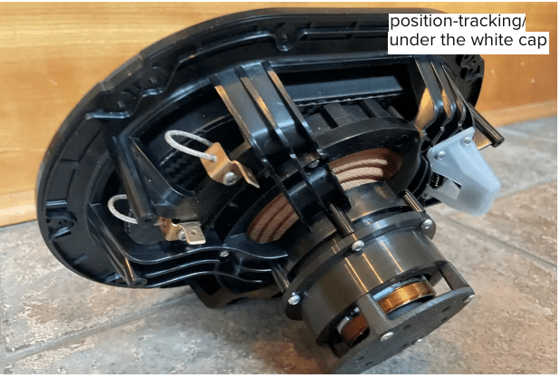

Another catch is the Repulse Attract Driver (R.A.D.) “magnetic negative spring” (MNS) does not center the split voice coils, and requires a position tracking sensor and DSP for that function.The catch of course is yes, the efficiency is higher than expected, but the peak SPL is still limited by the driver's linear excursion.

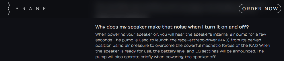

When unpowered, the driver has a rear offset, requiring a moderately noisy internal air pump's pressure to center it from its parked position to overcome the MNS forces of the R.A.D.
The pump also operates when powering the speaker off.
The rear coil is forced completely out of it's magnetic gap in its "parked position":
This would counteract the inevitable cone sag from a horizontal woofer...
The radial "H" shaped permanent magnets between the coils do appear to have enough repel/attract force to counter the internal air pressure. A double spider is employed to keep the coils and magnets centered.

How do you know it has an air pump? I haven't seen it mentioned in any of the reviews so far (granted the reviewers I've found all seem to be amateurs)?When unpowered, the driver has a rear offset, requiring a moderately noisy internal air pump's pressure to center it from its parked position to overcome the MNS forces of the R.A.D.

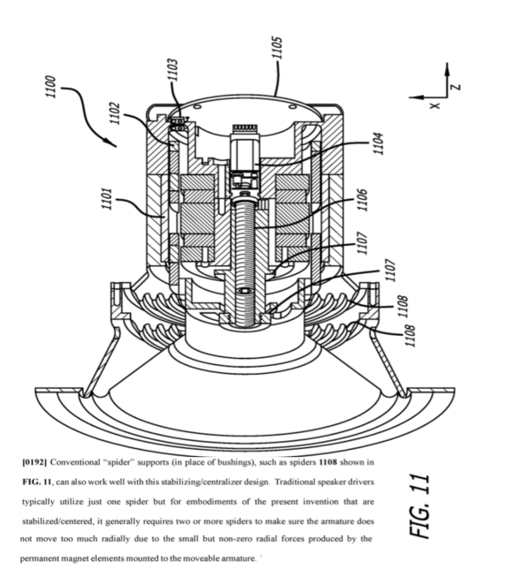

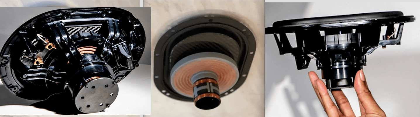

Also, I only see one spider (the one with the light grey band still attached in the image with the cone/vc removed from the frame). Where is the other, or is that two spiders stacked right on top of each other?
This TechHive review mentions the air pump and other details:How do you know it has an air pump? I haven't seen it mentioned in any of the reviews so far (granted the reviewers I've found all seem to be amateurs)?
https://www.techhive.com/article/2189886/brane-x-smart-speaker-review.html
as well as Brane's website FAQ:
https://braneaudio.com/support#faq
The picture with the grey band surrounding the spider does only show a rear spider.Also, I only see one spider (the one with the light grey band still attached in the image with the cone/vc removed from the frame). Where is the other, or is that two spiders stacked right on top of each other?
I'm guessing from the Patent Application #20230345180, the limited centering that a racetrack surround would provide, the distance from the voice coils, and similarity to double spider packaging seen in other drivers that the RAD driver uses a double spider.
That said, nothing in the patent application looks quite like the RAD used in the Brane X.
The centering drive screw motor 1104 and screw 1106 depicted in Figure 11 would be examples of ideas Joseph Pinkerton did not use in the Brane X.
An air pump, position sensor and their operational processing are part of the list of unusual elements in the Brane X.

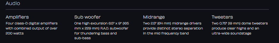

apparently more bass extension at higher volumes than any other portable speaker of this size. Even though the driver design may be highly efficient, they are then leveraging that efficiency to crank out a lot more bass than their competitors, which normally would use an amount of energy that could not reasonably be packaged into something of this size and weight. But measurements of actual bass performance are lacking at this time so we have only reviewers' words to go on so far, and while they resoundingly report that this thing cranks, measurements would be more convincing.Why does this speaker need 200 watts if this driver is highly efficient?
Very much. With 200 Watts you could hit xmax on typical 8 inch drivers in a sealed box, so I'll wait for measurments to show this actually has a benefit.
The four amplifiers used combine to a total of 200 watts (peak..) no more than two of the four are used for the mono woofer, since the top end is stereo.Why does this speaker need 200 watts if this driver is highly efficient?
Anyway, consumers expect to see a high power level for "thundering bass".
With the 72 watt hour battery, and 12 hour play time at "moderate volume", the average is only 6 watts used in an hour.
Ahh right if it's 200 Watts peak that could mean anything really. 6 Watts average ain't bad if it's putting out low bass at 'reasonable level' from a tiny box.
