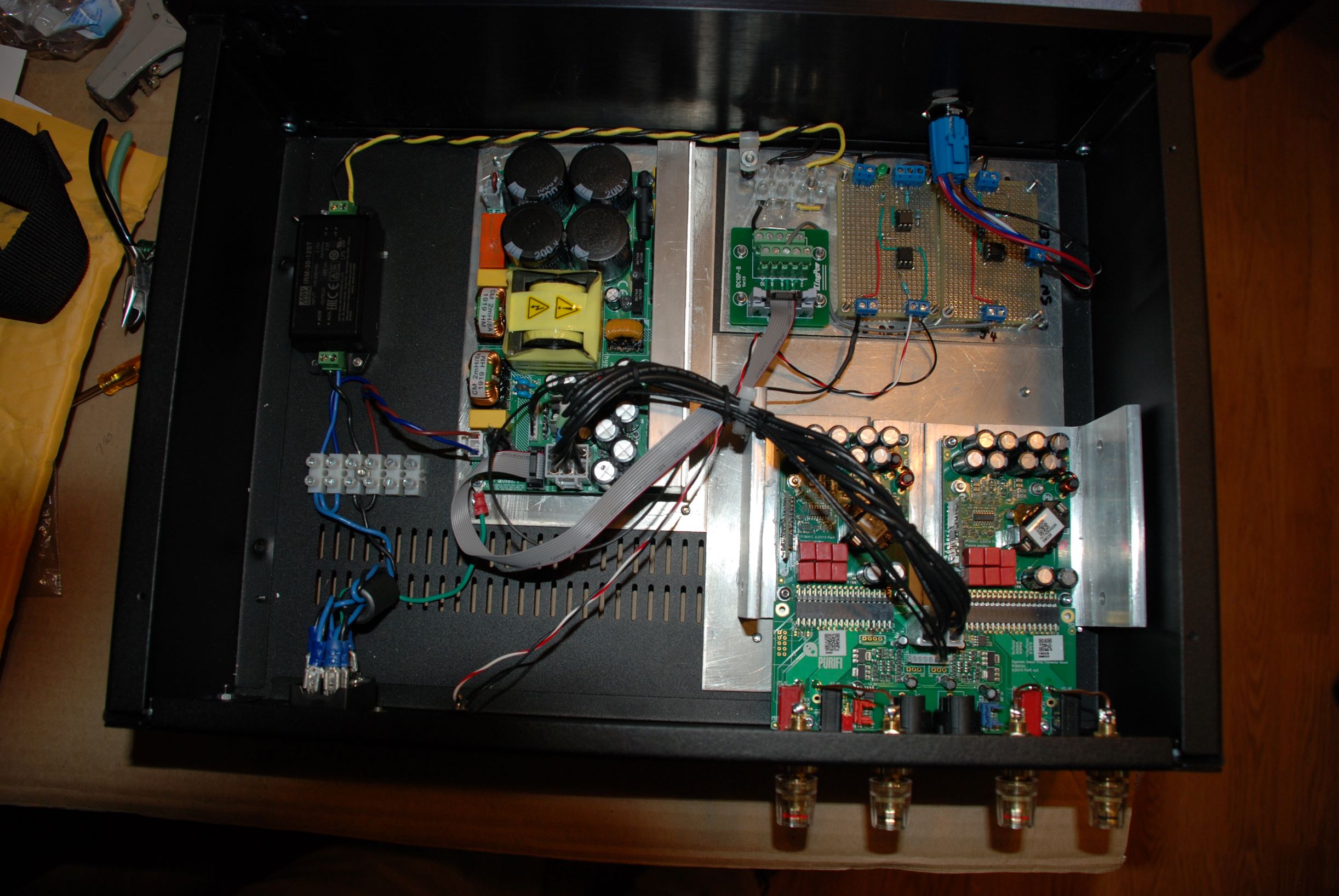

Soft Start
A convenient way to soft start is to use the feature that is built in to the 1200 power supply. It will control the 400a.
Pins J5.1 and J5.5 (ground) on the smps.
Applying a 3.5v - 5.5v at this point puts the smps in standby and soft starts/stops the module. More data on both the info sheets.
I simply recycled and old dc wall wart supply for this purpose. Mounted it inside the case at the power in location. Controlled by faceplate switch. Simple and works perfectly.

What is all this concern RE soft start? The Purifi eval board has the NAMPON switch, which defeats the output of the amp. For "soft start" all one has to do is turn the NAMPON "off" and then apply power to the amp. after everything is powered up, then enable the amp via the NAMPON switch. There is no need for additional circuitry or anything.

My Purifi build, ordered the Purifi EVAL1 with cable kit, Hypex SMPS1200A400, and DIYaudio PESANTE chassis. I planned to drive the EVAL with a Benchmark DACHGC set to 0db on output and bypass the EVAL preamp buffer. Received all the parts and modified the chassis to contain the SMPS and EVAL module. I wanted to turn the amp on and off both with power on switch and the remote turn on/off from the DAC, so purchased a Meanwell – IRM-30-12ST 12VDC power supply for standby power supply. First implementation on turn on/off was using relay and IDC breakout boards, and switch with LED from off the shelf parts from Amazon and Digi-Key (block diagram and parts list available). Worked as intended which is to control the SMPS with SMPS standby J5.1 and use Amp enable from SMPS to turn on LED in switch. Wiring was a little messy so second implementation was just 4N35 opto isolators to control the signals (schematic available). Both methods work great with no turn or turn off pop. Very impressed with the amp I have built and owned many class A and class AB amps, but this is the first-class D with high power I have owned, very neutral of you don’t like the sound change the pre amp. Picture 1 relay implementation picture 2 opto implementation. Would like to do a shout out to the guys on Audio Science Review forum for all their help. Any questions please post.
