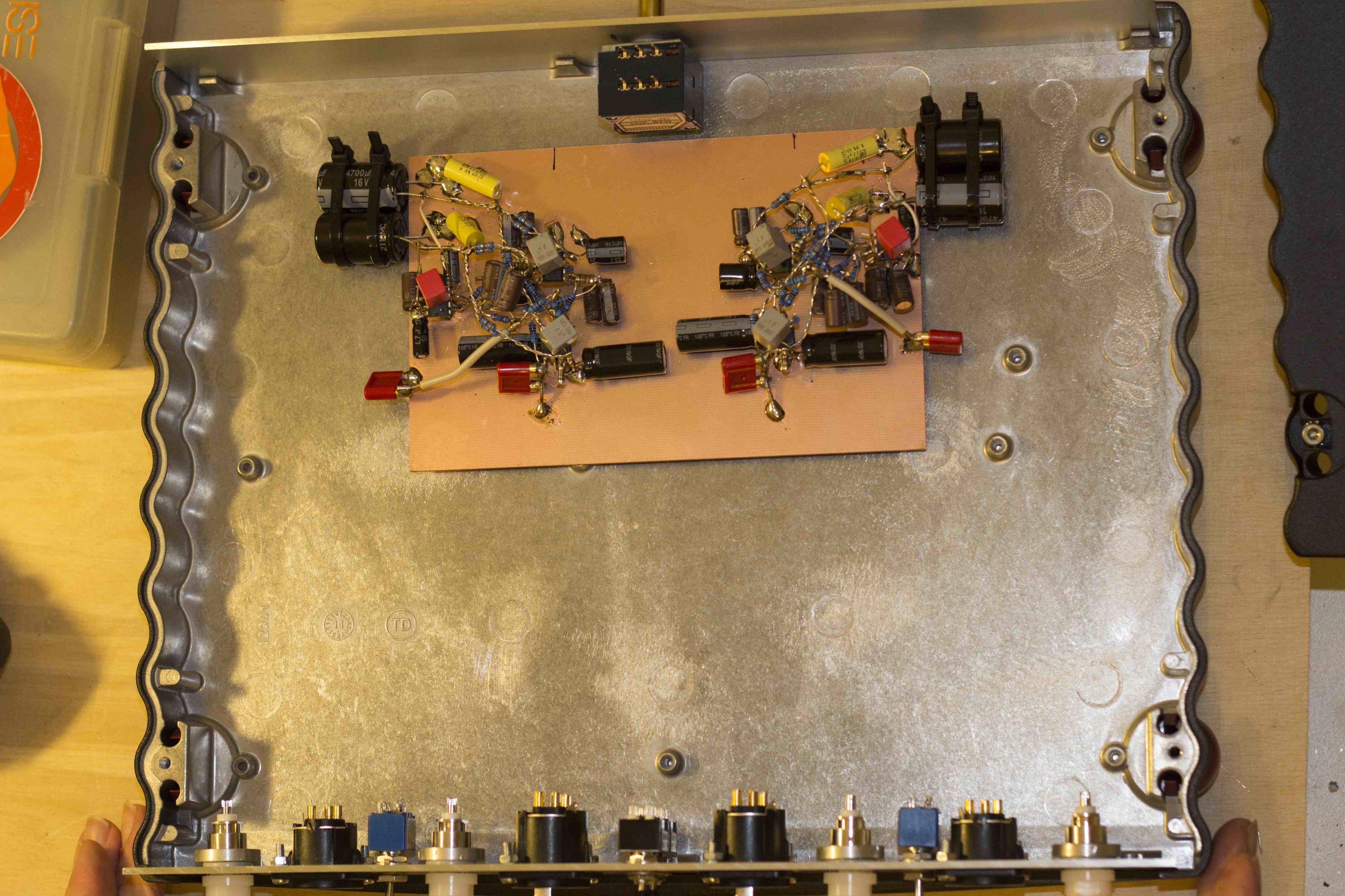

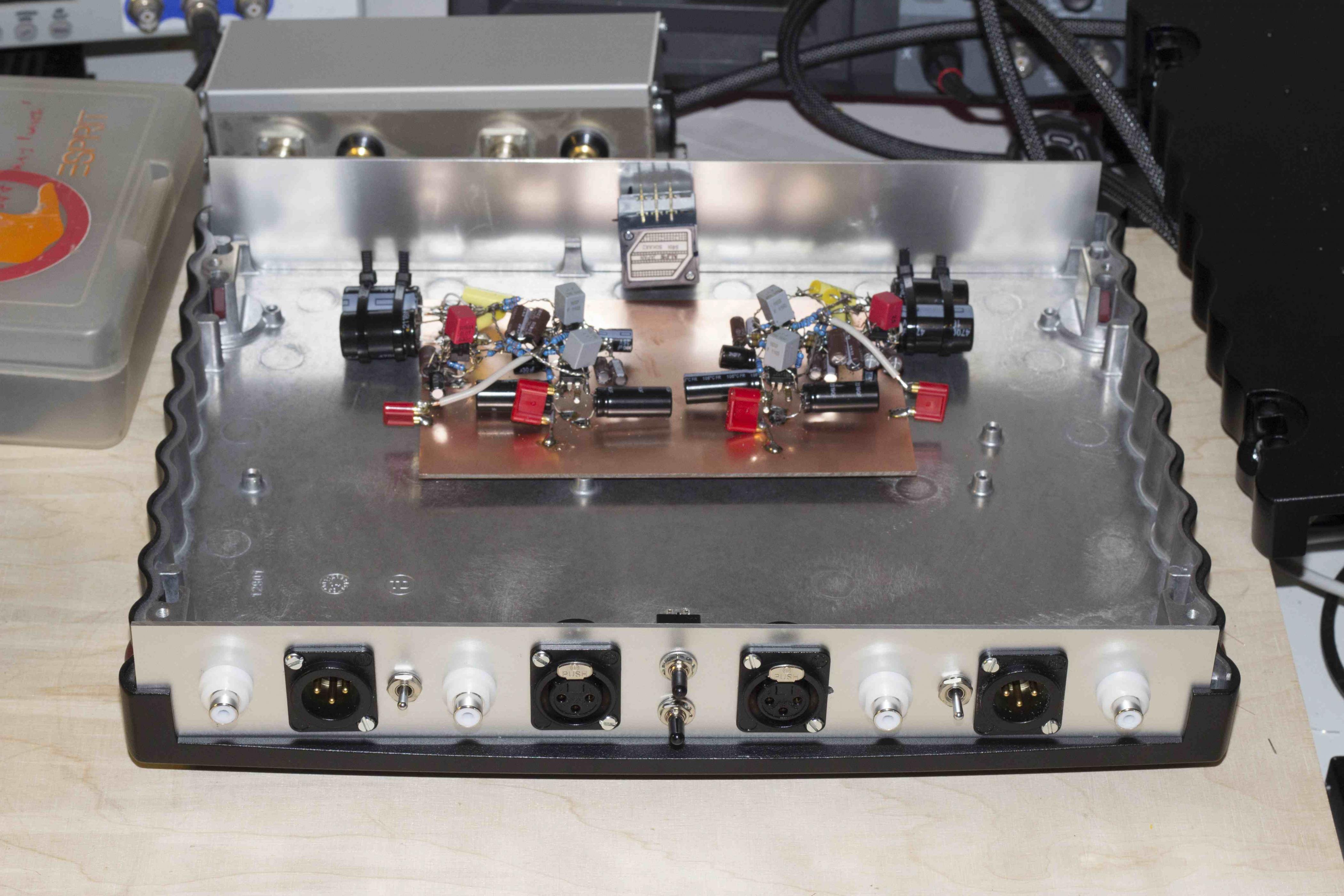

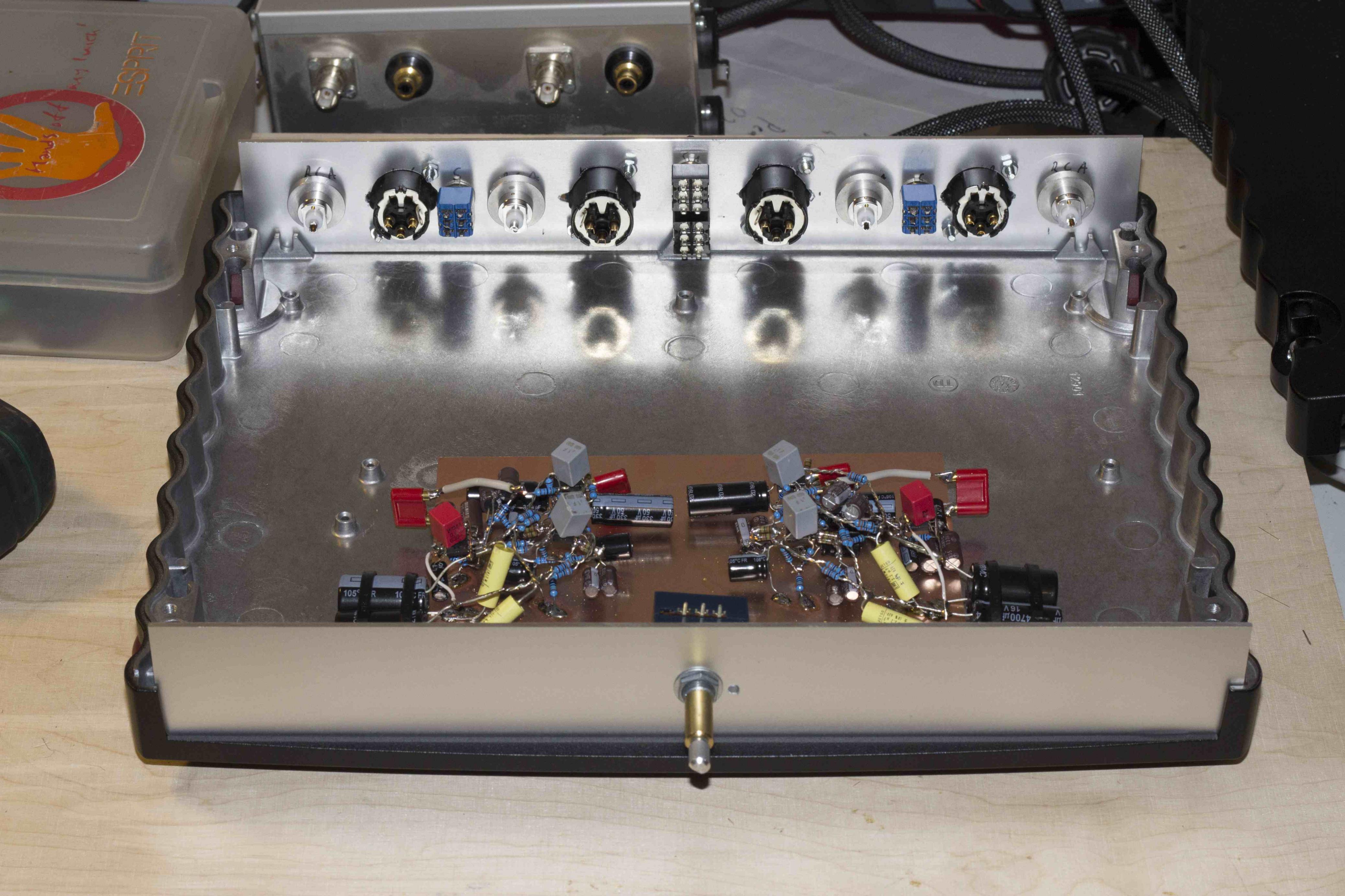

Here is how it looks.
I took NE5532. i have a lot of them because i wanted to build Selfs Grid Amp but i never did.
Inverted they are realy good because they have excellent transfer linearity ( Groner ).
I also may try biasing into Class A from the positive side ( Self in his book about electronic crossovers ).
The red jumpers are obsolete. i added them because i di not understand why they are in the schematic.
Yes Jan, i should read more careful but i do not read only this but a lot more.
Actually i read all the time, even on the to.....
I have bal and unbal in and out and also an input switch for 1 bal source and one unbal source.
That is good in my system. My CD player is unbal and my phono bal.
I mostly use a tube poweramp that has unbal input.

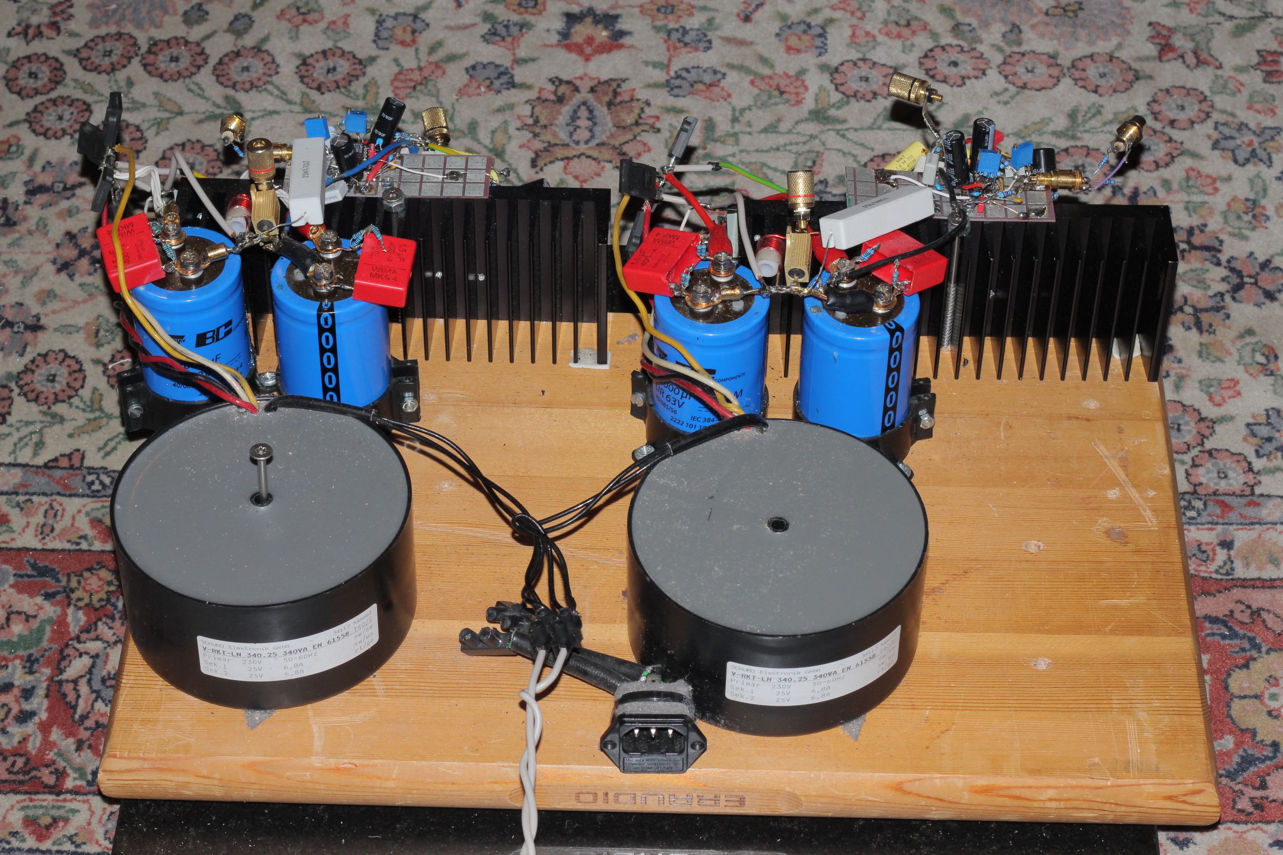

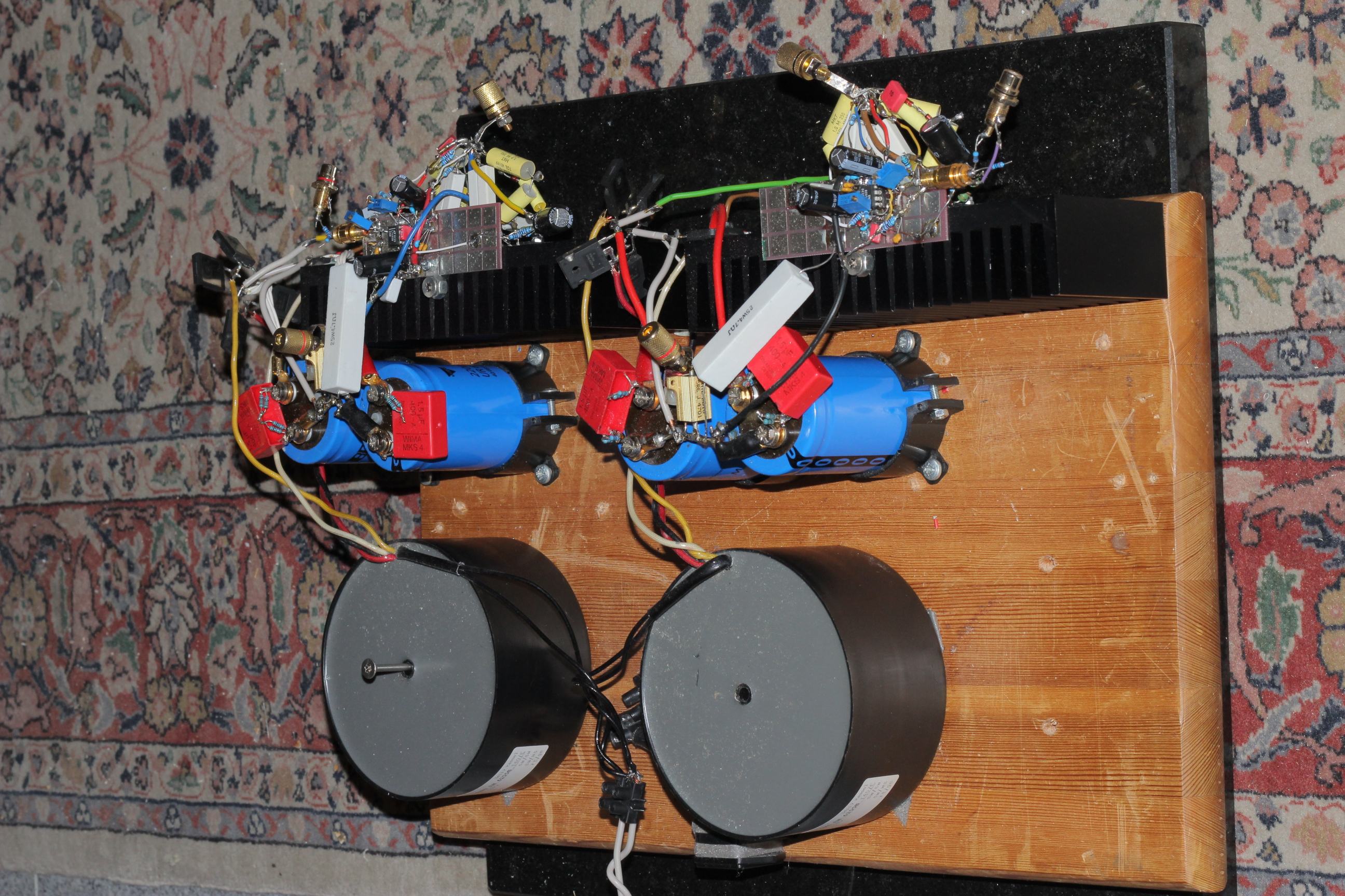

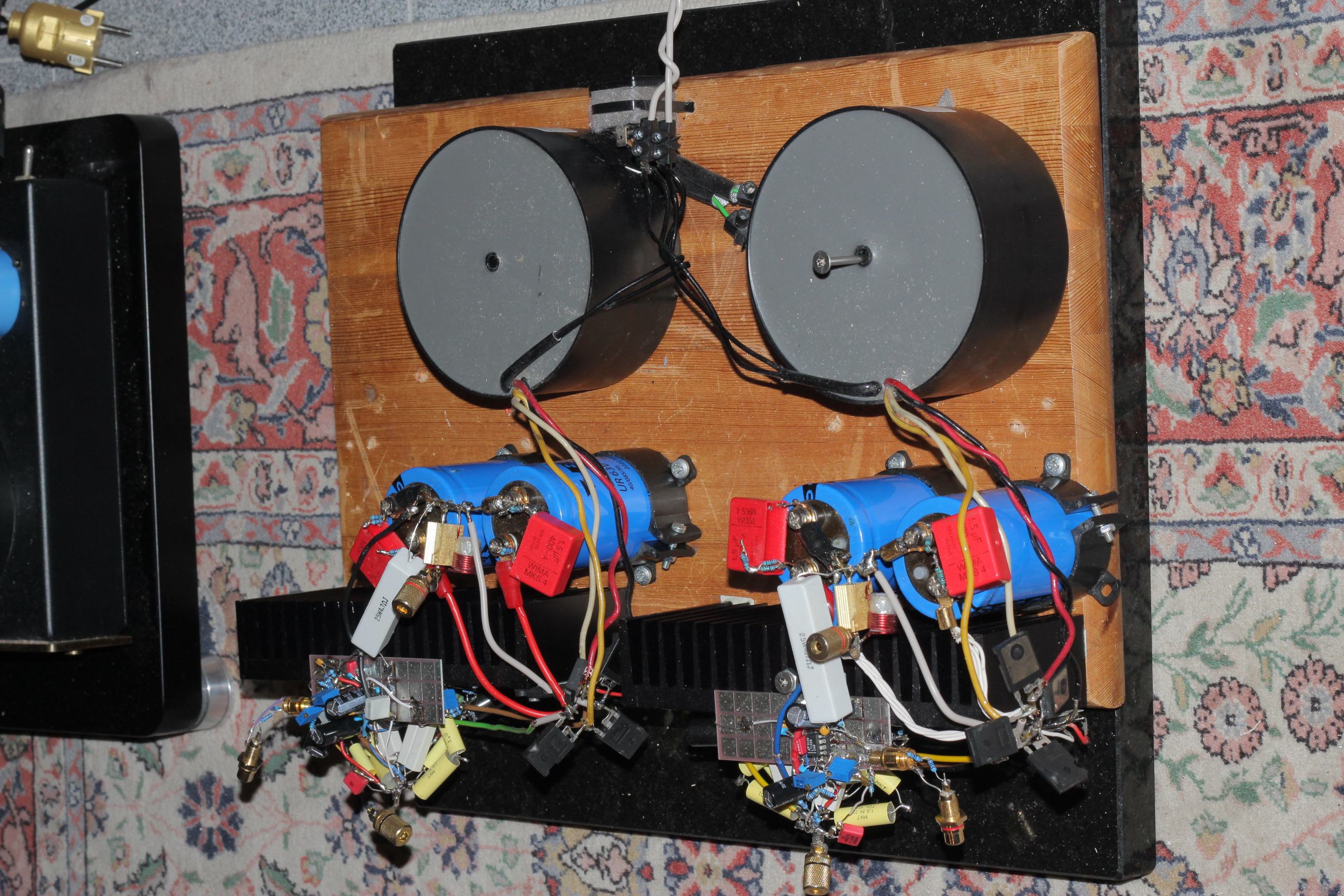

This may interest Jan :
I build the Vanderkoy amp from Linear Audio in higgledy-piggledy style.
Trusting my soldering it was put in the system without testing and that resulted in big trouble.
I know this was risky but organisation is the last resort of the troubled mind.
One thing was that it was humming like cazy.
I destroyed two very expensive wideband drivers with ALNICO magnets and a rare tweeter in a replacement box.
OK; pause.
Several days later i went back to read the article one more time ( rtfm, yes Jan ).
I build the balanced version and the schematic had an error.
I than rebuild the amp with the corrected placement of the input components.
That made the problem a bit less problematic but the humm was still too high for enjoyment.
Again back to the text and then i found the solution.
The source resistor is a combination of the output impedance of the preamp plus the input resistor, in this case 1kOhm.
I put a trimmer of 50kOhm parallel to the 1kOhm. This way i can adjust for lowest amount of hum, compensating the output resistance of the preamp.
Another problem is the rather high DC offset, around 50mV in both channels in my build.
I found a solution for this too without resorting to a servo.
And then the diodes in the PSU ...
Maybe more on ETF.
OK; pause.
Maybe more on ETF.
Joachim, sorry to hear that! Do you mind if I forward this to Vanderkooy et al? BTW there was a correction to the article here: Oops | Linear Audio (3rd or 4th article down).
And yes we can discuss it again at ETF.
Jan
