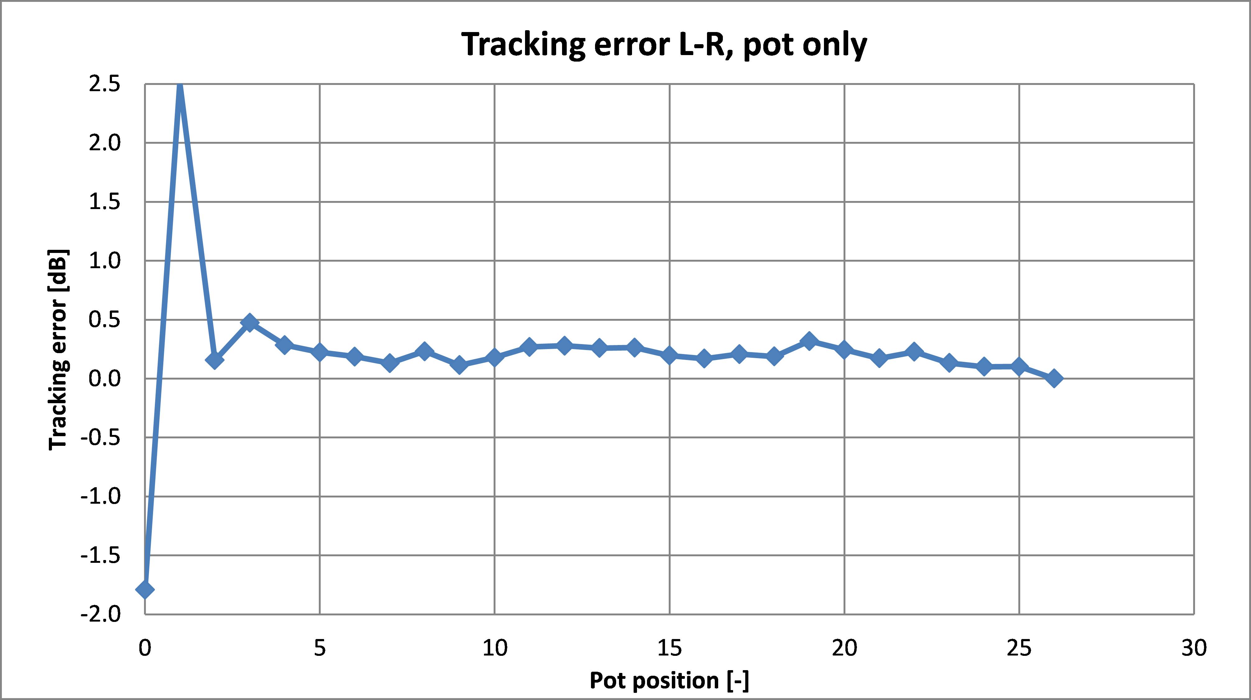

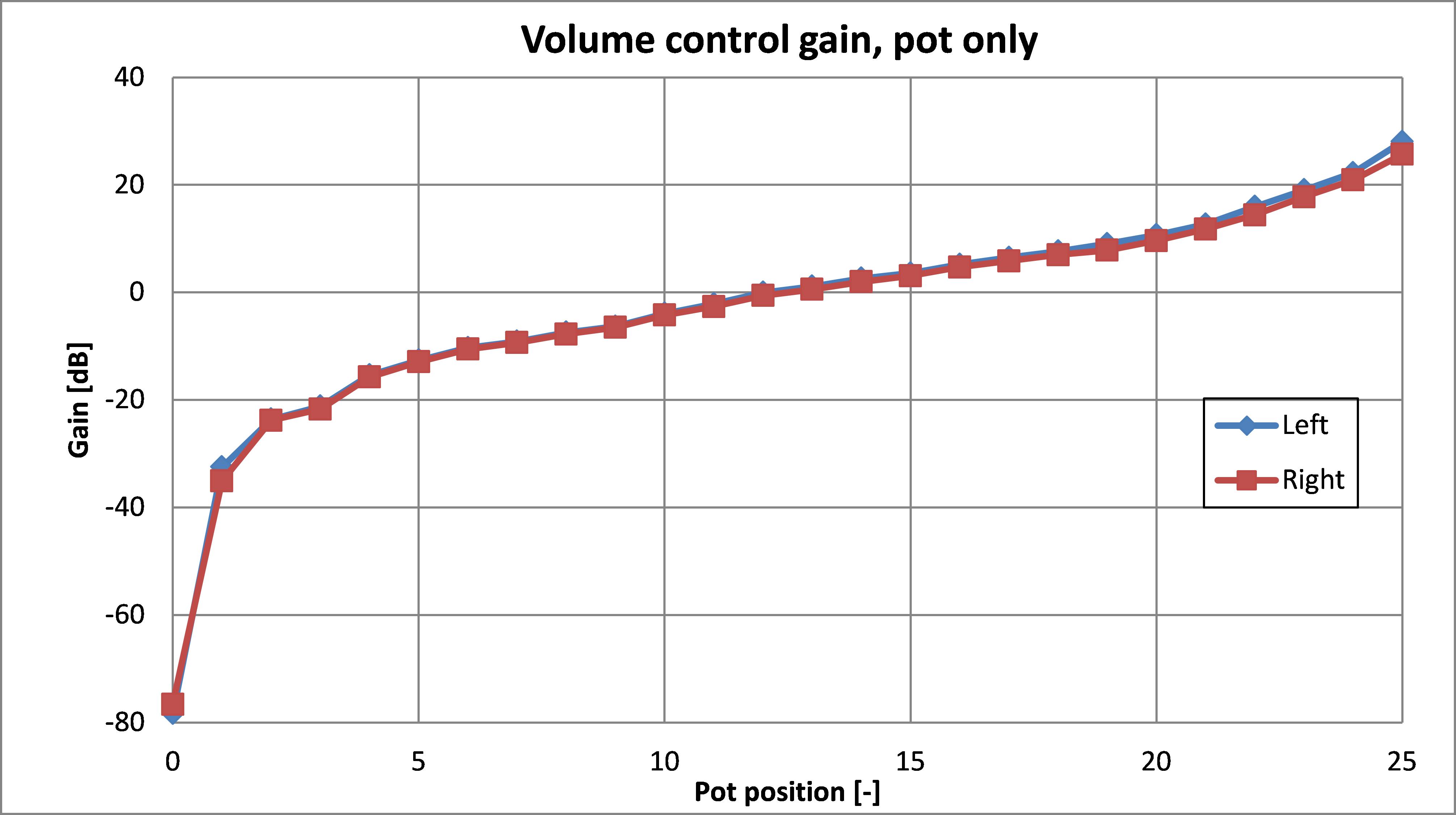

Here are the plots for a Vishay P11S2F0GGSY00D0063, nominally 2x10K conductive plastics pot. I've got this pot in both preamp samples that I have.
I did the measurements because I noticed channel imbalance at high volumes when measuring the preamp performance, and I wanted to know why this happened.
I measured the resistance (Rx) between the CCW end and the taper at 27 approximately equidistant angular positions. Having the exact angle values is not important in this case because I'm comparing the tracking and gain at the same wiper position for both potentiometer elements on the same shaft.
I entered the data obtained into an Excel sheet and analysed the tracking and gain errors for the Bruno's preamp for both the "Pot only" and "Pot + 2K2 resistor" configurations. The front element of the pot is assigned to the left channel, and the rear one to the right channel.
The first plot displays the tracking error between the front (L) and rear (R) pot elements, defined as the quotient between the respective Rx/R ratios, and expressed in dB. Discounting the first two positions, the mean tracking error is approx. 0.25dB for the respective pot element resistances R of 9102 and 9021 Ohms.
The volume control gain curve that this pot produces in the preamp is shown on the second plot. The useful control range is between approx. -40 and +26dB; as mentioned elsewhere, it becomes "fiddly" at both extreme positions. Observe that the gain law slope increase past position 17, the repercussions of which will be dealt with later. Gain differences between the channels are also clearly visible in this region.

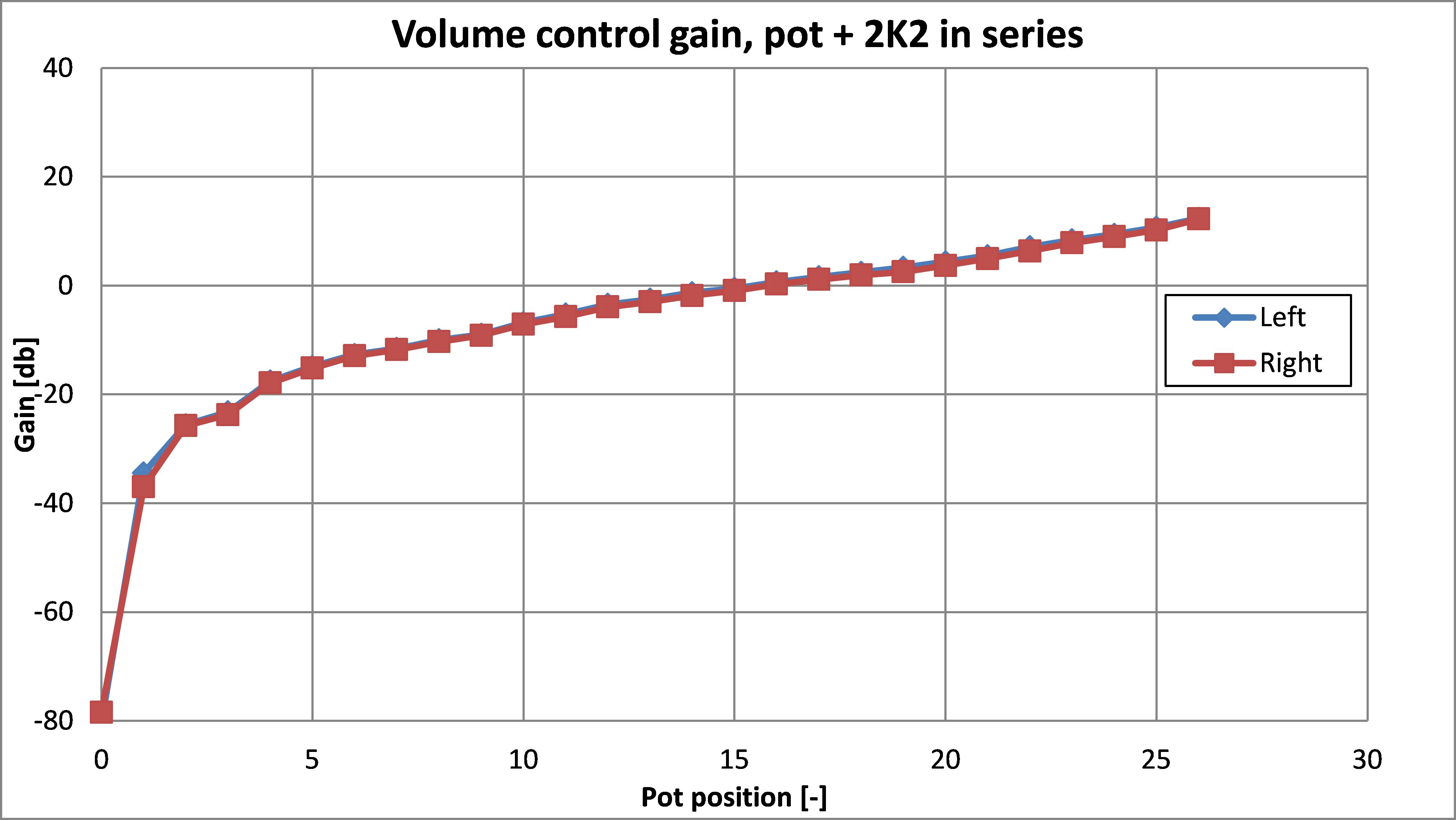

Using the data measured to calculate the gain control law if a 2K2 resistor were connected in series with the pot, I obtained the volume control gain curves of the third Figure. The gain law between positions 5 and 26 has an almost perfect "linear in dB" characteritics, and the gain differences at high pot settings are not pronounced. Note that the addition of the 2K2 resistor limits the volume control stage gain to about 12dB.
Plotting now the gain differences between the channels for both configurations (the fourth Figure), it can be seen that the gain difference in the configuration "Pot only" increases as the stage gain is increased, reaching values that become audible from the pot position 19 (resistance approx. 6.5K out of 9K total for this pot) onwards. The configuration "Pot + 2K2" does not change its channel imbalance as much in this region, staying roughly around 0.5dB on the average. The reason for the latter behaviour is that the additional resistance diminishes the gain sensitivity with regard to the pot imperfections at high CW pot settings. This can be proved mathematically by taking the gain derivative with respect to the resistance ratio; I did it, but I omit the proof here in order not to overload the post.
On the basis of these results, I can conclude that the addition of a series resistance of 2K2 to this particular pot has improved the channel imbalance at high volumes; the price to pay is the reduction of the maximum volume control stage gain. In my case, it was the effect I sought anyway.

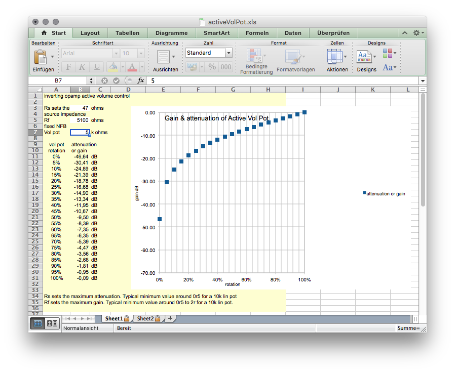

I am happy to see that some are able to open that spreadsheet.I can also open the .txt just fine after renaming it to .xls.
It's odd that my Libre Ofiice cannot open it's own export after adding and removing the .txt to the file name.
post275.
You can set the three values in the white boxes to any values to see the effect on the control law.
Rs and Rf can go down to ~0.5
Vol pot can go back to 10 (k is already in the formulae)
That will show a very similar curve to Dni's.
Then step the values of Rs and Rf upwards to see the constant slope part extending to a wider range of rotation.
I can get from 5% to 100% using the values in the download. that gives a range of adjustment from -30dB to -0.1dB. That range suits most of my listening if I have a lowish gain amplifier.
IIf I use a higher gain amplifier I need more range of attenuation -40dB to -10dB might suit, but since I have not built B.Putzeys balanced vol pot, I would need to set up some different experiment.
Each Builder can select the added resistors to suit THEIR required range of adjustment.
An alternative very wide range attenuator could set Rs to 1r0 and Rf to 10r. That gives a range of 140dB (-80dB to +60dB) and the middle 90% is usable.
BTW,
the two pages are both "protected" but without a password.
When protected only the three white cells are selectable/changable.
All the yellow cells cannot be overwritten.
If you go to tools - protect - sheet you can unprotect that sheet, if you need to make changes (like language to something that makes better sense, or change a formula) Then tools - protect - sheet and save and that preserves all the formulae.
Saving without a password works in Excel, Open Office and in Libre Office.
Braca, I understand these plots are from measuring the various pot parts versus position.
What I would like to see is the percentage or ratio of Rx/R for each position for each individual pot. While the pot may have different total values end-to-end, do the ratios track with position?
Maybe I didn't read your post correctly, but I think what you show is something different, rather values of Rx and R between pots. For this volume control, what is determining is the Rx/R ratio tracking versus angle between pots.
In other words, if one pot is 10k, the other is 11k, but in the 50% position one is 5k/5k and the other 5.5k/5.5k, that would still be perfect tracking in this context.
Jan
Jan, initially I thought in the same way as you, but the prospect of having to build a mechanical jig for this measurement got me thinking as to whether the rotation angle is needed at all, at least for establishing the volume control tracking error. The conclusion was that it was not needed, and here is the logic behind it.
My interest was to find out how well the two pot elements track in terms of their respective Rx/R values along the path from 0 to 300 Deg. of mechanical travel specified for this pot. The angle coordinate determines the horizontal positions of the individual Rx/R ratios on the chart, but at each angle value on the abscissa one must find the respective pot elements' Rx/R values measured at the same shaft position in accordance with the sequence "set pot position->measure RxLeft->measureRxRight->repeat".
In this way I'm able to compare the pot tracking at a number of discrete positions that are not strictly equidistant in terms of the rotation angle, but the only effect the angle would have had is to shift each of the points measured by a few Deg. to the left or right. So the gain law curve would possibly look a bit different, but this in no way invalidates the tracking values obtained; and the gain law is of less importance in comparison with the channel imbalance.
For example, at point #4 (approx. 9 o'clock) I have (Rx/R)Left=0.145, GainLeft=-15.4dB, (Rx/R)Right=0.141, GainRight=-15.7dB, Gain tracking error = GainLeft-GainRight=0.3dB (see Figure #4 in the post)
Given that the individual linearity tolerance of this pot model is +-5% (+-0.43dB), tracking errors up to the latter value are unavoidable, which is clearly visible in the Figure.
I hope this helps clarifying the results presented.
