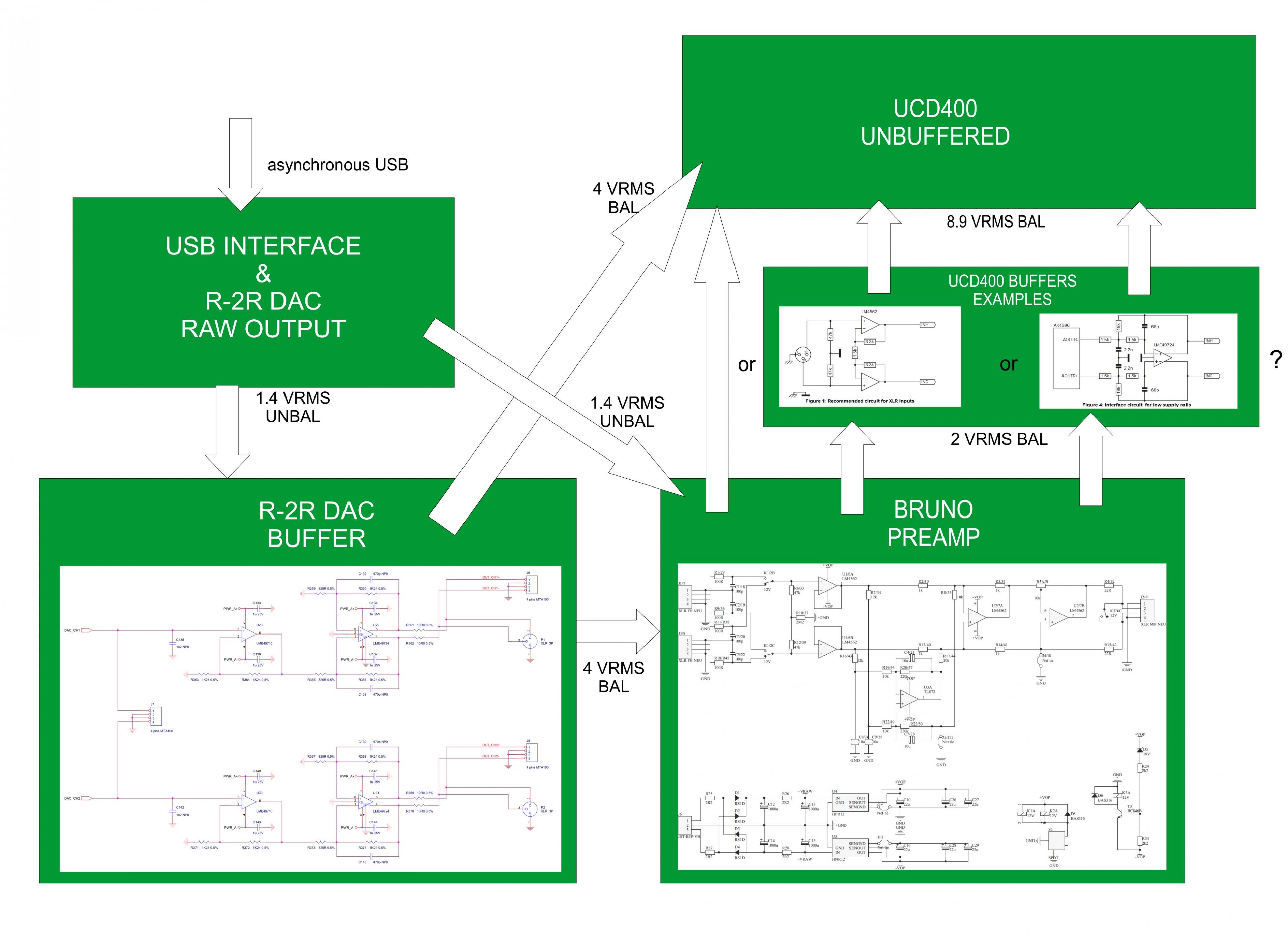

Andrew, what is a receiver in your nomenclature? Is this referred to the preamplifier or my UCD400? Yes, UCD400 without its own buffer requires 8,9 Vrms to get to maksimum output. Its buffer uses TL072 and sound quality is immediately drowned after switching to buffered input. I use it unbuffered and driven from 2V rms NE5532 DAC output stage so it have not even close to 400W. 6-7Vrms will be sufficient as I don't need so much RMS power.
ubal output from DAC to unbal input to vol pot.
unbal output from vol pot to unbal input of preamp.
+12dB, or +15dB gain pre-amp
unbal output pre-amp to unbal input of Receiver.
If the Receiver has a Bal input, then adopt the bal output shown in B.Putzeys sch.
It is just a few extra passive components and an XLR socket.

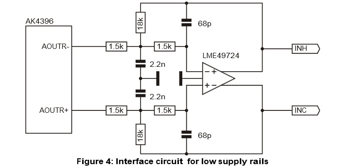

No I don't want to fly to the Moon on this preamp. 🙂 I found this preamp as candidate to the simple and quality interface between single-ended DAC output and differential inputs of the UCD amplifier. I like idea no using any potmeters straight in signal path. Another candidate is LM49724 circuit from NC500 datasheet you see in attachment.
Is there a problem in connecting single ended source to differential output of this preamp? If I remember correctly Hypex guys frequently are saying there is nothing wrong with it. Regarding this preamp: It will be sufficient if it will drive an output to the 18 dBu level (6,1 Vrms) and will have +14dB of voltage gain in the same time without strain but I need to proove it before I pull the trigger and pay my money. Your answers will help to another DIYiers also so thank you for your answers🙂

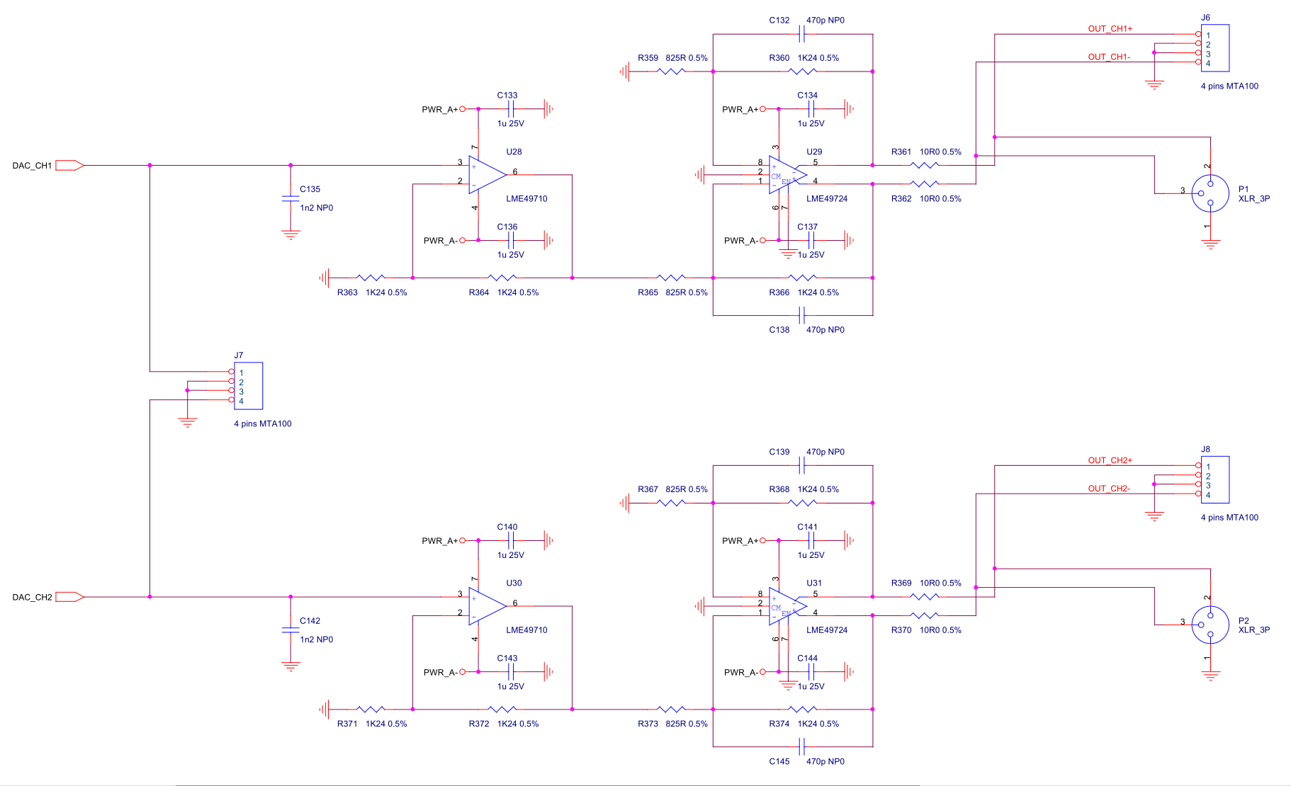

Receiver has differential input. It is designed by Bruno so I think it has balanced impedance input.
Soekris DAC has onboard buffer with unbal to bal converter wchich can supply 4Vrms differential signal. I wanted to bypass it to get to raw output from resistor ladder directly which is 1.4 Vrms single ended.
This DAC bal-unbal converter and buffer scheme is linked below.

If you disable the balanced impedance output and use the unbalanced output, then you don't need a balanced input pre-amp.

Have you looked at the 49724 datasheet?
On ±15Vdc it has a guaranteed (limit) maximum output of 50Vpp into 600ohms.
On a 36V supply it would be slightly higher.
That output stage suits the input of your Power Amp.

Someone should explain me patienly point-to point method what would be best and simplest way to connect DAC and amplifier with circuits available below. I have even made block diagram of my desired system... 🙂 I will post it here but every further discussion regarding this issue should be directed to my PM in order to avoid rubbish in this thread. Thanks! I will read through all your answers throughly later in the day when I come back home.
