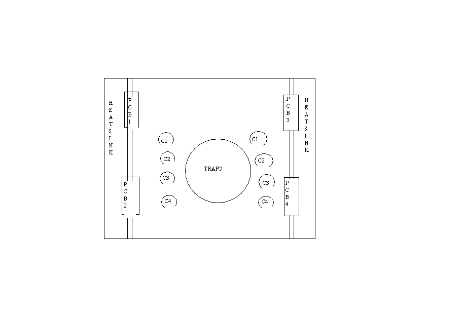

What kind of power supply would I need to power all 4 boards (I would like to keep this all in one case) would it need to be ~1000Va ? i would like my layout like the pic attached 🙂
Halo,
A 1kVA transformer will give you more inrush current than 2x 500VA when you turn your amp on :hot: If no fuses are used then this can damage your amps.
You'll have to think about a soft-start circuit or thermistors.
In my opinion you should have it anyway even with 2x 500VA trafo's
but to answer your question: yes 1kVA in total should be alright
regards
so two 500VA with 25 volt secondaries making one transformer for each channel...
Is there a such thing as 1000Va with 4 x 25 volt secondaries? Is that equvalent to having a pair of 500Va?
It seems I will be paying alot more for 2 500V than for 1 1000V trafo... would there be a benifit to having separate trafos for each channel
I am new at this please educate me if I am travelling down the wrong path...
I figure I would do a soft start anyway for either of the two trafo designs.
Awesome thanks for the replies, i am on the short bus when it comes to this... hopefully I will learn alot about DIY audio with this build as i have already caught the bug, just dont have the technical knowledge to back it up!
Hi Halo,
how much experience do you have working with toroid transformers?
If you are competent, you can convert a 0-50 + 0-50Vac to four separate 25Vac windings.
It's just a case of finding the midpoint in each of the two windings and cutting to insert four extra (flexible) output leads. Then re-insulate the secondary.
4 isolated secondaries is almost as good as two transformers each with dual secondaries. If the 1000VA has a better regulation than the 500VA then the single big transformer can help the system to perform better.
