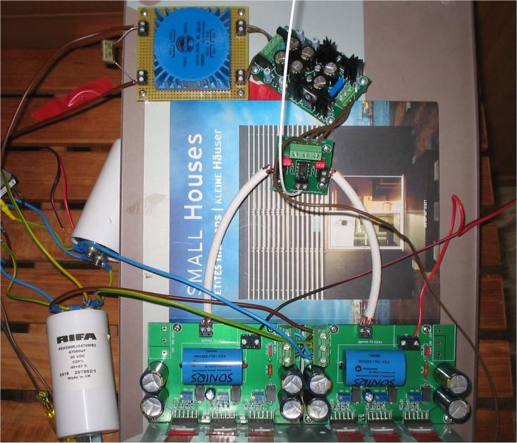

looking at the picture attached to post 878 it seems like you take the speaker lead from ground at the left pa150. compare to alexw pictures.
also, it is hard to see if the shield of the coaxial cable is connected at both ends (drv->pa150). I think the pa150 and the drv must have the same ground otherwise the signal floats.
does that hiss occur also with no input? is it sensitive to placing the whole thing under a metallic cover (or just moving your palms over it)?
further on the grounding.
pic 878 shows the zero volt return line passing directly over the unscreened termination to the power amp input.
This zero volts line carries pulses and high current audio signals back to the main star ground.
Twist the PSU output triplet so that the field created by the three wires cancels.
Do similar for the power lines into and out of the voltage regulator.
What are the two wires that head off screen to the right?
Ups!, my mistake connecting speaker terminals. Thanks. Now 90% of hiss has dissapeared. The power is much more bigger. I think i can go for the enclosure and test the complete system and then eliminate any trace of noise.

drv134 boards are between passive pot and PA150 boards, see the photo

you should consult someone who really understand these things, but if you look in the data sheets of the drv134 you will notice a 10KOhms input impedance. this means that when connecting a potentiometer at the input (taking from the variable tap to the drv input) the source will not see the same impedance in different volume settings. I think the actual impedance would be between 5K (at full volume) to 10K (complete silence) and somewhat non linear behavior even if the potentiometer is linear. the common practice is to use a potentiometer in front of an operational amplifier (input impedance of 1e13 Ohms which is completely swamped by the potentiometer's resistance) or using some other type of active buffering.

if the DRV is between the passive pot and the amplifier then the DRV is not driving the pot.
The DRV is driving the power amp and whatever impedance/resistance you have built into the power amp's input.
What is before the pot?
Can that source/s drive a 5k or 10k passive pot?
A switch, cd player, radio... I don't know if these sources can drive a 10k pot. How can i know it?
