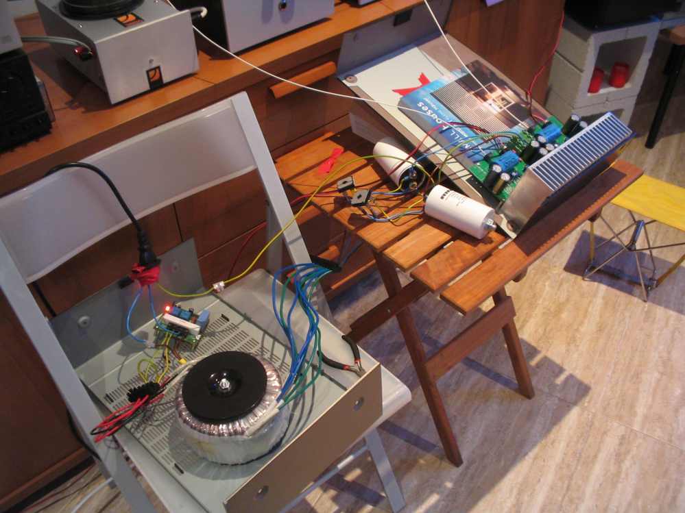

i'm testing the pcb in unbalanced configuration with only two boards and a passive pot. It sounds really good. I have doubts that the balanced configuration can be better but i will try it.
Looks good, I am going to try the unbalanced version (BPA150) first also.
By the way, where did you get the connectors for the boards? Do you have the digikey or mouser part number? Thanks.
few questions
what speakers do you use (efficiency, impedance, etc.)?
did you play loud? the balanced (I assume you mean the bridged configuration) is aimed on providing more power (if at all needed).
how hot are the LMs getting? you did not tighten them to the heat sink so I guess you did experienced extreme temperatures.
if I correctly recall, I saw a post of yours describing noise when connecting in bridge configuration. is it solved or is it the reason you don't use that configuration at the moment?
With some luck and some more of that good back wind in Sheffield more picture of that kind are expected!
loudspeakers: old B&W DM310, 8ohm, 90db
i don't play it very loud but i'm building this amplifier for my sister, who has B&W Matrix 804 loudspeakers, so i think more power would be better.
LM3886 run hotter than expected, i don't tight them, it's a provisional heatsink.
Yes, i tested the drv134 boards but not bridged. I connected two of the three outputs to my chipamp.com LM3886 monoblocks and i found lot of noise, similar to the noise produced by a cassette deck without noise reduction, but this isn't the way to connect it.
A question. What about the resistor in the drv134 boards? I didn't use it. Is this correct?
regarding the resistors, in the drv134 TI papers they appear only in testing circuits and not in the typical usage one.
regarding noise, how did you connect the various grounds (input signal ground, drv supply, bpa supply)? were they all connected to a ground star? according to your description it is more like hiss than hum but it is hard to say. maybe someone who knows what he is talking about should comment.

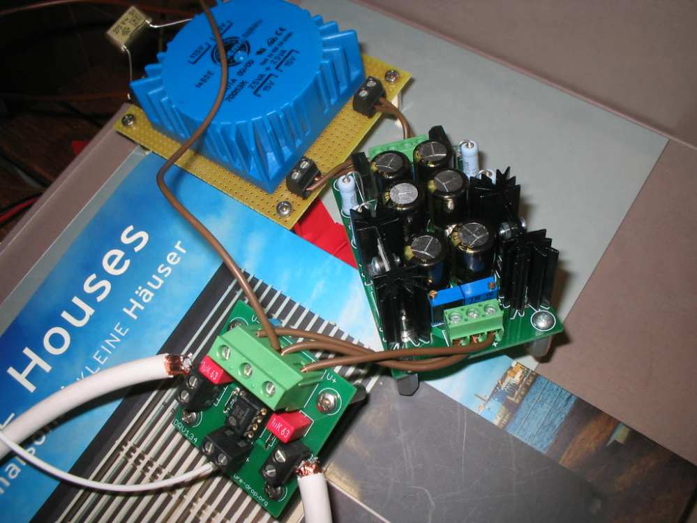

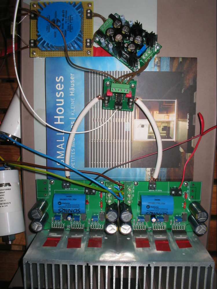

I've just finish to test two pa150 boards in bridge mode with drv134/ that1646 and Rhys pcbs. In both cases there is an unsupportable hiss that i can't eliminate. I think it's possible the pcb design is poor. Has anyone test these pcbs? Is there any easy design i can build in a protoboard? Now that i have these balanced drivers i want to probe other design before go for expensive transformers.
