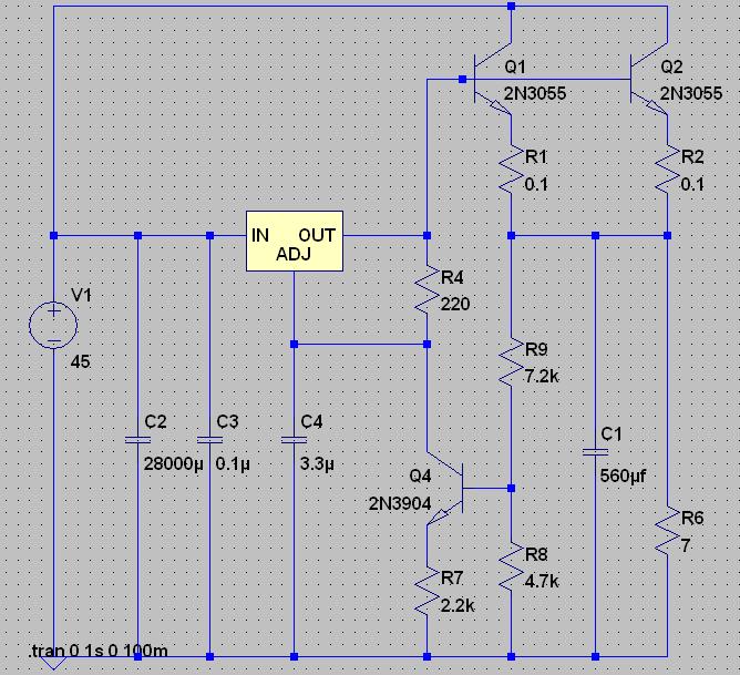

After further thoughts, this is not a good idea.
As mike says, SMPS supplies are usually very noisy, i dont think it is really worth it.
Instead, i have decided to create a regulated power supply for the BPA300. I have played around with regulation on the BPA300 in the past, and i think it sounds a lot better.

I plan to offer, High current voltage regulation. On board capacitance using lots of smaller caps. On board rectifiers.

Mike,
I will take a look at the 'powerreg', but rerember we are looking at up to 8 or 9 amps per rail of current on a monoblock running at full load, if the circuit in question can handle that much and more current then i will implament it.
After looking into the PowerReg, it looks like it will be a real upgrade to the BPA300. I advise anyone who has not bought the PSU capacitors and rectifiers yet to hold on a few days to see if i can come up with somthing.
For the small price it will cost to include regulation, i think it will be definitely worth it.
I have been playing around by using a LM317 as a voltage refrence for 3055 transistors in LTSPICE, it looks good, and clean.
