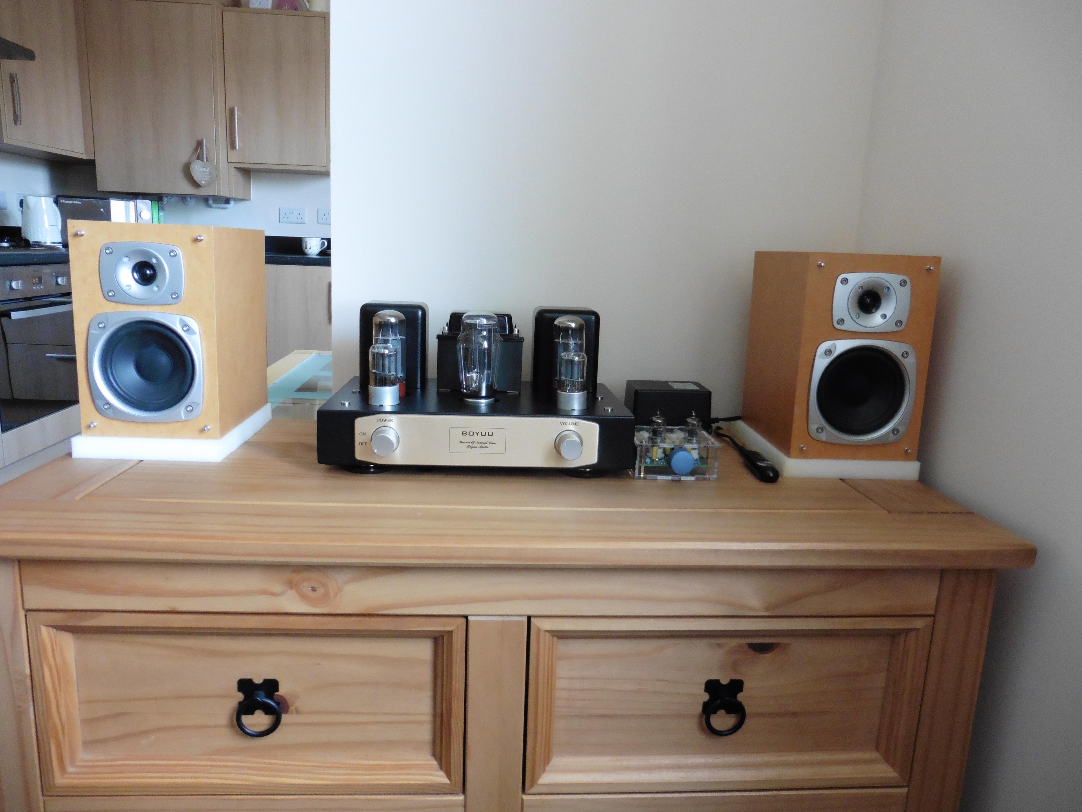

This amp is now finished and working in my lounge (pic below). This is being used with a home-built valve pre-amp kit.
Nigel
