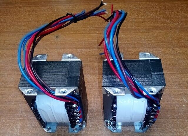

so what with parts missing - im feeling rather happy about taking the opt's off the chassis and out of the covers for painting ------ as i find the common has had a mounting screw cut half way through it !! ffs -- i would not have known albeit any other colour could have been worse !!! :joker:

It looks like the black wire has been cut on your transformer, Post # 23.
And, you have not said anything about your Power Transformer.
Did you get one?
The more I see and hear, this reminds me of the "Open Box" Special.
Not so special after all.
I know its cut , thats what my post was about , I wasn't planning on getting power transformer as its OK, I had thought about getting better opt's as previously mentioned , looks like my kit is a sack of shite really so could end up a very expensive chassis !!!! , from douk store if interested , I will press on and probably replace all the wires on the opt's , BTW thinner wires as I thought are secondary, you thought maybe the thicker? I'm sure all will be ok , at least all my components are good q
As to the cut wire, finish the cut.
Then carefully strip 1/4 inch at the ends, tin them, and solder to join them, then cover with Shrink Tubing. I would not try and fish out the beginning of the wire all the way to the enameled wire end of the winding.
Nobody will see, but it will be safe, if you do the following:
Be sure to use a rubber grommet for the wires to go through the chassis, or do a very good job of de-burring and filing any and all sharp metal of the chassis hole.
When you get the amp up and running, you will have something to be really proud of.

Dave realised that and now corrected --- would you know ?? should i leave that cap off of the power switch ? i have a lorlin type to use and i did read somewhere here its safer not to have that cap fitted -- im still learning but taking much time and doing much research -- i will also fit balanced resistors on the 6.3v taps -- no harm doing both i guess
