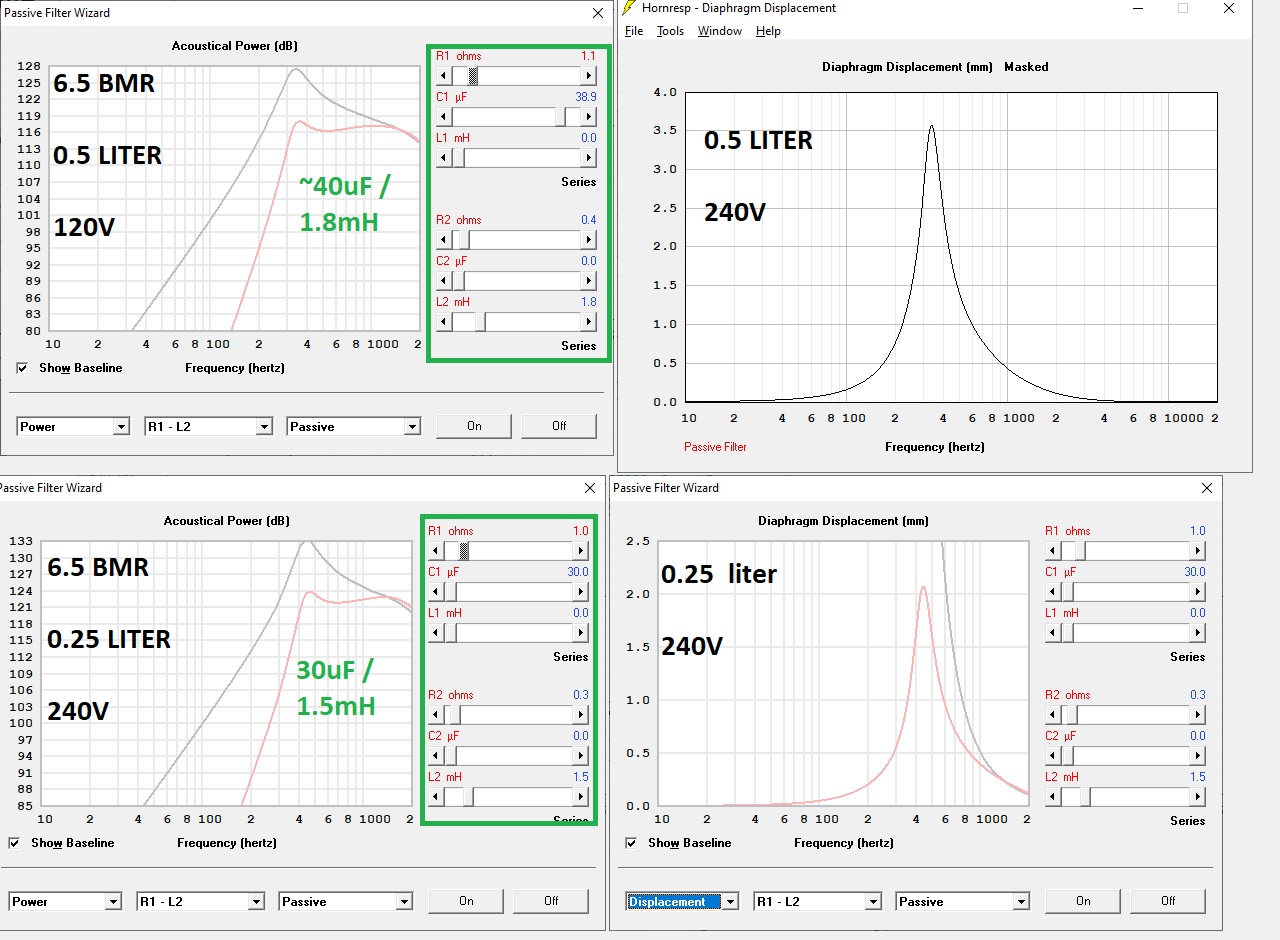

Box volume reduction with high pass filter
(thought he wanted "fullrange small")

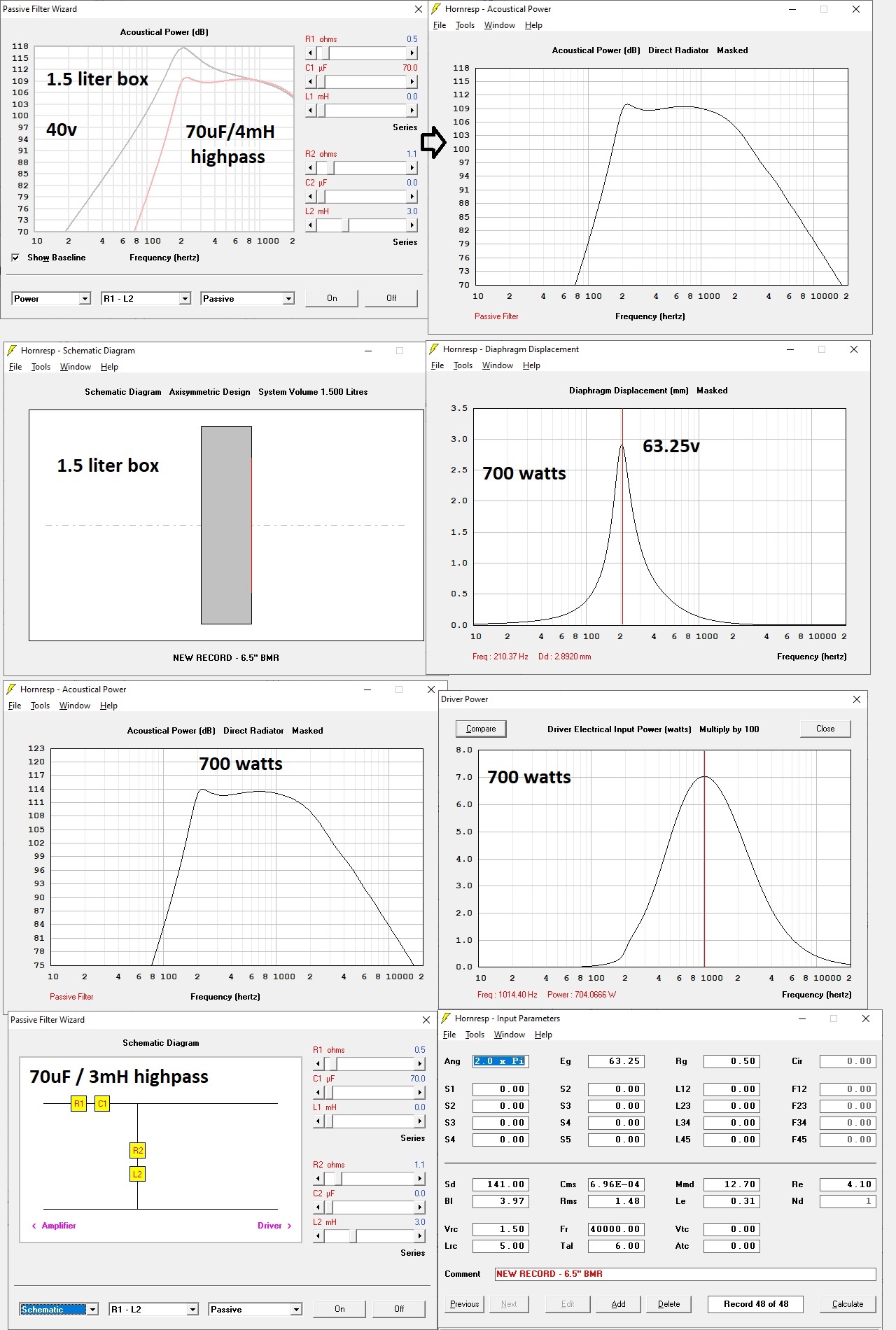

Here's 2.5 liter with a simple passive highpass with 100uF cap and 4mH inductor.
It would catch fire long before running out of excursion as 40 volts gives around 3.6mm peak
- and keep on going down in size while up in frequency .
you can now plug it into US 120v AC mains or wideband for a peak of 3.5mm (that's a joke son...)

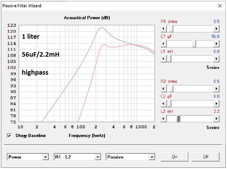

1 liter with 56uF/2.2mH highpass

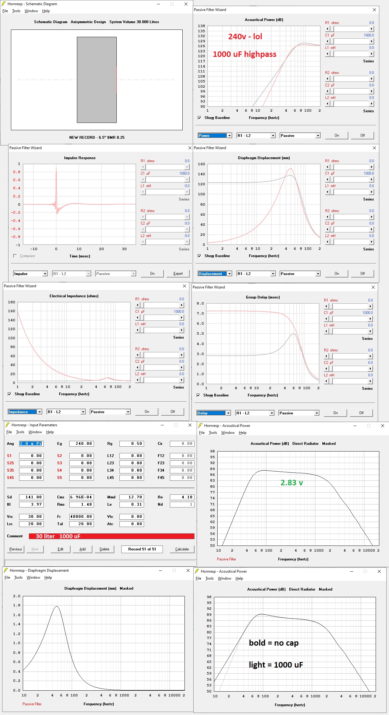

30 liter/1000uF sounds good. I wanted to look at the SEAS/Dynaco 2-chanber case using hornresp but can't apply the passive filter.
Here's how hornresp interprets 30 liter with 1000uF -ignore the 240v spl - the excursion is interesting😀
