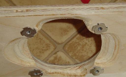

Well this leads to another question.
I have often seen the 'daisy' pattern on the rear of the cutout where rather than making a smooth chamfer around the rear, the four corners where the driver is attached are not chamfered.
So either the router has to be carefully maneuvered to create the pattern or hand filing is required.
Can someone bring in here a picture of that?
On my test box, I attempted to do this maneuver but I found that
my sweep was too wide or something so those corners still lacked
a good piece of the back to attach t-nuts. Maybe there is more control with a rasp. But it is a tedious technique. Besides I don't have a good half round file.
Also the chamfering bit I have is not the full dimension of the
usual router bits one sees for sale. It is considerably smaller has no guide bearing, just a stop at the base.
Seems like using a router would require either a steady hand or template, i.e. more trouble than it's worth unless in a small company production app, so I always used a coarse rasp since it's quick and all the groove irregularity is either acoustically transparent to lower BW or acts as a diffuser with HF.
Not a photo of my work, but similar, though it appears one side might not be gouged out enough:
I won't comment on the desirability of chamfering- it does seem to be a bit of a trade-off, since the rigidity of the driver attachment is reduced.
However, for tools to do the job:
For hand work something like the Microplane tools are quite effective- I've used them for guitar necks and the like. They also make a drum version for an electric drill.
A decent rasp is expensive.
Another surprisingly effective alternative is some very coarse sandpaper (sanding belt) wrapped around a curved (long) block. Think of it as a trip to the gym combined with a Zen exercise- the time will pass more quickly!
And, if you have them on hand, sanding drums in electric drills or coarse sanding disks in a hand grinder can also make this job go quickly.
Cheers
John
Yes. Better than my description and I've seen some nice hand-cut work to do this.
A work up such a jig or combination of bit and guide bearings would be interesting.
Or even just hog out a portion and then shape with a rasp.
