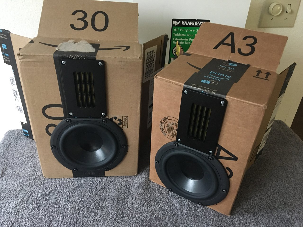

I'm thinking about just building it, hope for the best, and see how it sounds.
As for components, my audiophile friend supplied me with speakers and told me I can pick a crossover from his selection.
From his selection, indeed? Put your tweeter and mid in any box and start playing with the crossover?

Quickest way to make an assessment is put the drivers on a baffle, tweeter over the mid, a 2uF cap in front of the tweeter, and softly play them together. How do they sound? Is there hope? Or should you go build a pair of Parts-Express C-Notes instead?
If there is hope, then take it all over to your friend and tell him you're ready for his help with the xo. Don't forget to bring your alligator leads!

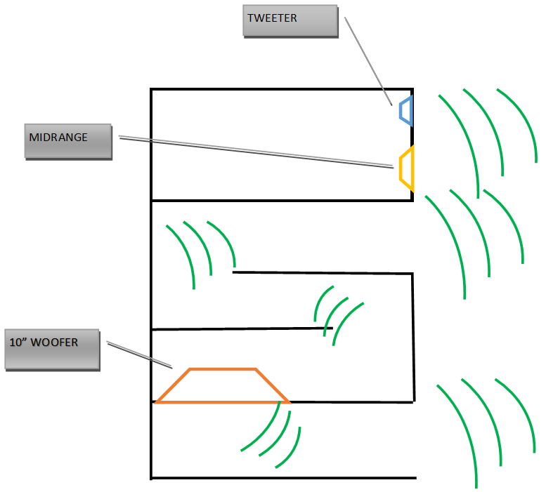

I'm planning to build a speaker, but I want to build something different - thinking outside the box (pun intended). I'm planning to build it out of either 12mm or 1/2" birch wood plywood. Maybe you guys have better ideas on construction materials. I drew a rough sketch of what I thought might work good (open side-view attached), but I need you professionals to give me the exact dimensions that would work best - or just tell me if the design just plain won't work.
Basically a tapped horn for the woofer - number of plans around, check Brian Steele's work.
