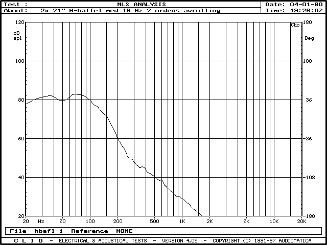

Better frequency response without EQ; does not trigger standing wave modes. And this also results in a cleaner and shorter decay, which indeed is audible.
This is how it measures with dipole compensation EQ and XO only. No room correction EQ at all.
Is this at the main listening position? Why only one location? How good is the frequency resolution? Any smoothing applied?
Mono bass or stereo? If stereo then you would need to show left, right, together separately.
Because I listen only in one location. And of course the response changes when I move several meters, because of boundary reflections.
Measurement is taken with one channel only. The other channel, and both channels together measures the same, within less that half a dB.
Sadly, there is smoothing applied. I lost the measurement data in a harddrive crash sadly, and the only thing I have is this graph. Let's see if I get the urge to do a new measurement ..... 😉
But you do have two ears, do you? And they are mounted about 20cm apart from each other?
Not in my setup. And, you don't move while listening?
Yes, isn't that sad again 🙂 Sorry but your graphs doesn't show what you're trying to show.
I will try to do some measurements tomorrow, I hope that will clear things up. 🙂
Like to add that I usually sit still when listening critically.....
Greatly appreciated 🙂 Frequency resolution should be about 1Hz with no smoothing.
Nevertheless you should measure multiple locations to show how smooth the response really is. If dipoles categorically show less detrimental modal effects then the frequency response across a certain area should be very smooth, right?
