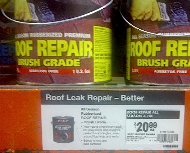

looking at options for paint-on damping material, anybody tried this stuff ?
??? Yes, it can work!
