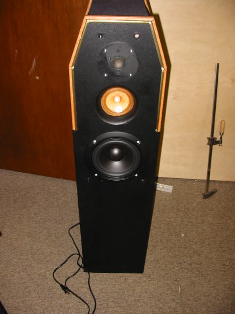

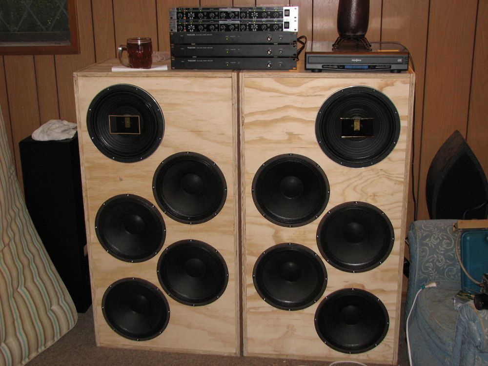

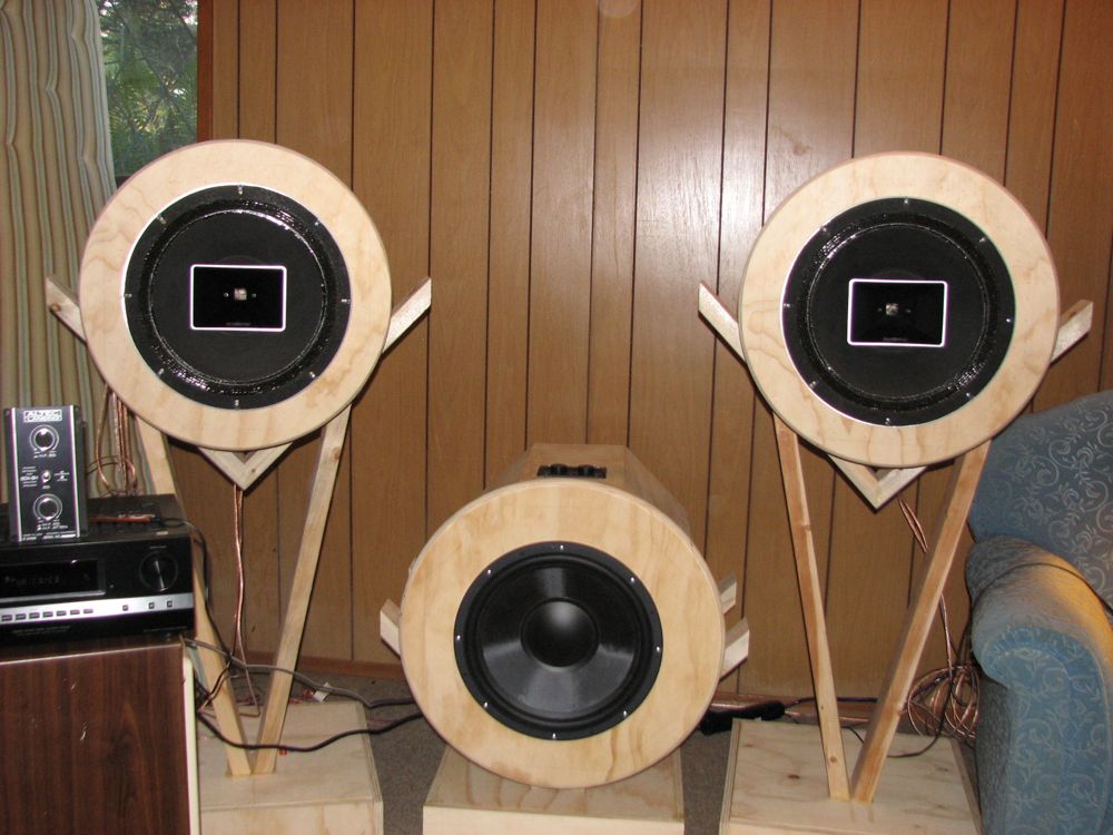

Hi Jack, I don't recall mentioning it so here are the systems.Hey Cal, perhaps you've answered this before, but where in the range are you crossing the mids to the bass?
First pic: 100Hz - active - on the Altec 604's
Second: 150Hz - active - on the Sammi Coax's
Third: 600Hz - passive - on the mids
Fourth: 1000Hz - passive - on the Coral holey basket.

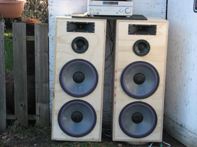

But it wasn't until I was able to build a special internal structure that really randomized the back-wave, wrapped with absorbent material that I was able to reduce the boxy colorations to inaudible when outdoors.
Jack, can you share with us a description of your 'special internal structure' and why you believe it works so well ?

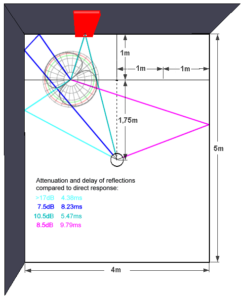

I believe you have your dipoles toed in. If your situation is anything like mine, you could probably get away with absorbtion in the red area:.. I have been thinking to try absorbing the rear wave of my dipoles for a while now, and even more so after discussing it with Stig Erik. Would large and deep rockwool panels right behing the speakers suffice?
Absorbing the corner reflections seems less necessary, since the delay is greater and the reflection is coming from almost the same direction as the original sound. The corner reflection would widen the stereo panorama, which some people really appriciate while others believe it to be "unnatural". Choose your poison according to your taste. 😎

Absorbing the corner reflections seems less necessary, since the delay is greater and the reflection is coming from almost the same direction as the original sound. Rudolf
Unless the delay is very large, >> 10 ms this reflection will be a serious problem that should not be ignored. The fact that it comes from the same direction as the direct sound is a bigger problem, not a lessor one.
I'd agree. Both the corner reflection and the back wall reflection in that sketch are close enough in angle, compared to the direct sound, to pose difficulty in seperating them out.
Reflections from the same direction as direct sound = response abberation.

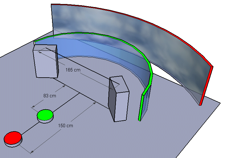

Some time ago I moved the speakers even further into the room. Now I prefer to listen at the border between direct field and reverberant field in my room:
Green is where I listen in the direct field. Less sophisticated recordings tend to be arranged in a half circle - if left/right information is pan-potted solely to its corresponding speaker.
Red is where I listen in the reverberant field. Notice how the acoustic scene walks back towards the front wall. To me this is a strong indication that I recognise the front wall and front corner reflections primarily as a distance indicator and not as part of the first arrival.
Rudolf

The question with reflections is always whether they seem to be plausible reflections adding to the spaciousness of a recording space or whether they are perceived as response errors. The problem with reflections coming from the direction of speakers (or directly above or below them) is that we can't use binaural hearing to seperate them from the source. In that case they are always perceived as response errors rather than spaciousness.
In the past I have attached simulations of music with reflections added to the direct sound. When done in mono (reflections same direction as the source) you clearly hear the comb filtering. When added to the opposite channel they always sound like an environmental reflection rather than a colored sound.
Dipoles send a lot of energy to the back walls that, if not treated, will reflect forward as your previous diagram shows. Why would you want to treat the back wall bounce and not the back corner bounce?

The walls in my graph should not be interpreted as a kind of projection screen, where the acoustic scene is fixed too. They just indicate an average curvature of the scene, but don't define the exact distance of the sound locations. If I knew how to paint a curved and transparent cloud, it would have been a better representation.I would hope that a system could portray a range of sound locations from left to right and from the plane of the speakers back toward infinity (at least beyond the wall).
Doesn't it need only a few (horizontal) degrees between the direct sound and its reflection to make them separable for binaural hearing?The question with reflections is always whether they seem to be plausible reflections adding to the spaciousness of a recording space or whether they are perceived as response errors. The problem with reflections coming from the direction of speakers (or directly above or below them) is that we can't use binaural hearing to seperate them from the source. In that case they are always perceived as response errors rather than spaciousness.
Some phantom images, that are projected in a direction near the back wall bounce, tend to be "sucked into" the wall bounce point, when I leave the direct field. It depends on the recording, but is no "rare" occasion. So I would give this priority. Of course you could treat the corner bounce too, but it doesn't do much more than reduce the width of the stereo stage.Why would you want to treat the back wall bounce and not the back corner bounce?
