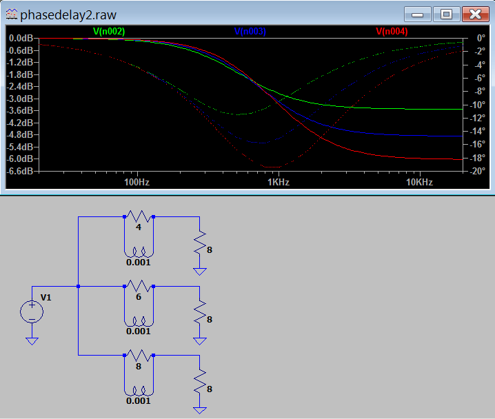

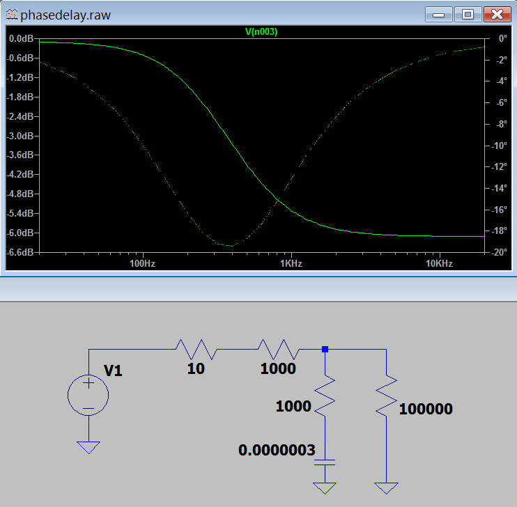

On atc monitors ( both active and passive) there is a potentiometer to 'compensate' bsc for inwall/closewall/ freestanding.
On active it is a high shelf filter centered at bsc freq attenuating mid high. On passive i don't know how its done but the analysis done here gives some clues.

On passive it's also a high shelf centred at bsc frequency..On active it is a high shelf filter centered at bsc freq attenuating mid high. On passive...

It is interesting that there is some amount of shelving that averages the problems. If shelving is the option available to someone then it should be taken. What I find is the amount of success varies with the nature of the individual room/speaker interactions. I think the word 'compensation' helps to fit that description.
^For sure, anything that helps is good, speaker would work better near wall with ability to adjust the lows. Bass is very important, and can be quite annoying if too much. From the other perspective if asking does this make my speaker work near wall the answer is no, there is more to it than shelving the bass.

Thank you clarifying about Atc passive. Do you know which kind of circuit topology is used, i'm still curious about what they implemented ( i don't really care about values but how it's done)?

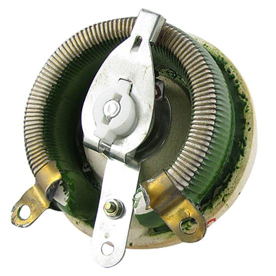

I can't imagine both woofers receiving the same signal since that would lead to power response issues. My bet is that the lower bass speaker has a lower xover frequency than the upper one. And is attanuated through the 25 W resistor. That would produce the curves shown.

No i have no other info other than i have seen this potentiometer at the back of SCM300 ( or 200) passive, and i understood it was difficult to implement such shelve filter on passive xover. So i wonder how it could be implemented on such 'high power' passive xover.
the manufacturer specifies a woofer X-over at 270 Hz, so that shouldn't be a problem.I can't imagine both woofers receiving the same signal since that would lead to power response issues.
https://www.revelspeakers.com/produ...forma3&dwvar_F208-_color=Black-GLOBAL-Current
Doesn't putting a series resistor with the woofer hurt the damping ratio?
Some of us spend a lot on low DCR inductors.
This method by Revel and possibly by other manufacturers, does it still belong in the 'audiophile' realm?
