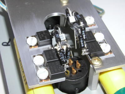

Jonathan,
I've just seen the pictures of your pramp and I'm not surprised it can sound better than Boulder. Tremendous attention to detail, something to inspire in my next project. I'm greatly impressed.
I also started doing my circuits in "3-dimensional air-dielectric construction" with the shortest signal path possible. Here is a sample of my attempt, almost no wires, preamp's circuit virtualy hangs on input and output jacks. When I see the layout Boulder style, somehow I can't imagine that this is the last word with a given circuit topology. Their components are also of average quality.
