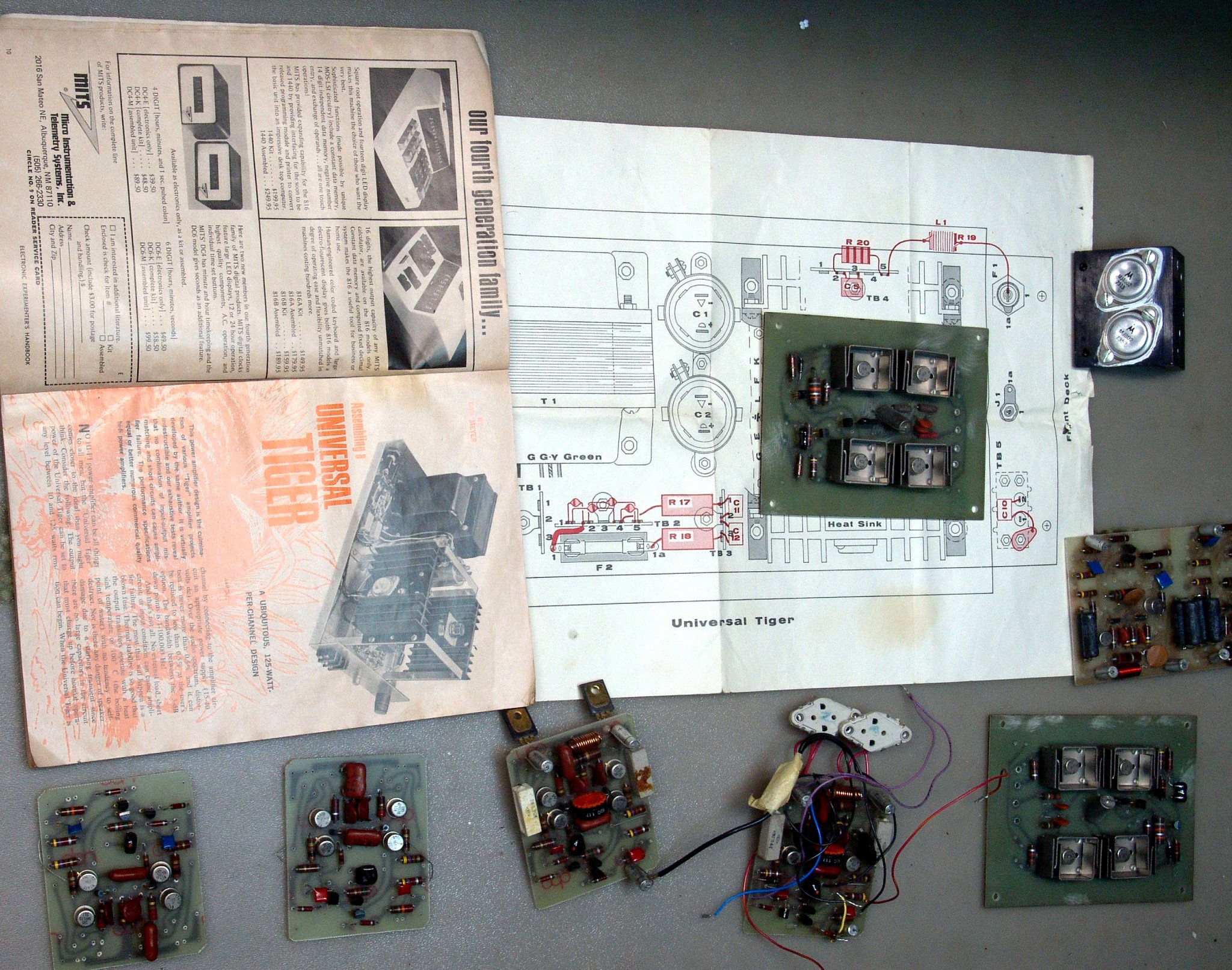

I believe that the SWTPC Universal Tiger used a similar circuit, maybe it was full Complementary Symmetry, don't remember for sure.They are not “weird” numbers - just RCA house numbers like Motorola’s MJ. 40xxx was metal can, and we’re generally available to any OEM (not protected by NDA to a single customer). The diff pair was the 40406. This was back when Mouser and Digikey didn’t carry **** anyway, and you needed at tax ID to order from the big boys. Experimenter still had a hard time getting their hands on them new, but scavengers get pulls could because the circuit was common as dirt.
If we could still get the 40409 and 40410 we’d still be using them. And no, I won’t buy ECG 128/9.
I got those funky RCA transistors at the local Heathkit store.
Universal Tiger Got a rugged cool look to it.
almost like a tube amplifier block.
Seems Similar construction people were familiar with
in early transition to solid state.
Ready to go in a huge console or something
when speakers looked like furniture.

The Tigers were altogether different animals, operating the output stages with gain. To make them safe under hard use, they desperately needed Baker clamps. And prone to construction- related instabilities. One could make them work if they knew what they were doing, but don’t drive a stock one 10 dB into clip.
Tigersauras was a stupid idea. You don’t do that voltage-splitting thing on an output stage with gain. That’s just asking for trouble. With followers you had a chance - and then the only one to get that right was Leach with the double barreled amp. You needed a triple there, to keep the voltage division under dynamic conditions where driver base currents are substantial.
If you built one today - stacked or otherwise - using MJ15003/4 you’d also save yourself a lot of grief. MJ802 is NOT up to the task. It sure looks pretty on paper until you see that abysmal SOA graph. It’s real, BTW. Everybody else who made stacked output stages at least used 2N5630’s - which we’re up to the task. MJ802 were time bombs running off regular +/45V rails in a classic circuit. Replaced way too many of them back in the day. With D424/B554 and never looked back.

Almost all of Southwest Technical Products Corporation (SWTPC) kits were published in one of the popular magazines of the day including all of the Tiger amps. When I started on the assembly line at Motorola in 1973 I found out that we could get free samples of many semiconductors (within reason) and there was an "audio club" that built stuff. It wasn't long before we cloned every Tiger except the Tigersaurus, spun off a computer club and cloned the SWTPC 6800 computer too. The boards in the picture were leftovers from some Universal Tiger and Plastic Tiger clones.
I ran a DIY audio system in my 1973 shagmobile van that used 4 X Plastic Tiger boards each feeding one speaker and one UT feeding the 15 inch sub. The source was a "Concord" home cassette deck mounted upside down in the overhead console. Concord was one of those unknown brands that Olson Electronics sold. It was really a Nakamichi in disguise and it internally ran from a 12 volt supply. I ran the service department at an Olson Electronics store before going to Motorola. I had bought a pair of those Concords cheap because they did not work.
None of the Tiger boards used in the van ever blew up but that was probably due to the wimpy push pull boost converters that could be made with 1972 germanium parts. The plastic tigers held up well in guitar amp duty but the UT's did not.
