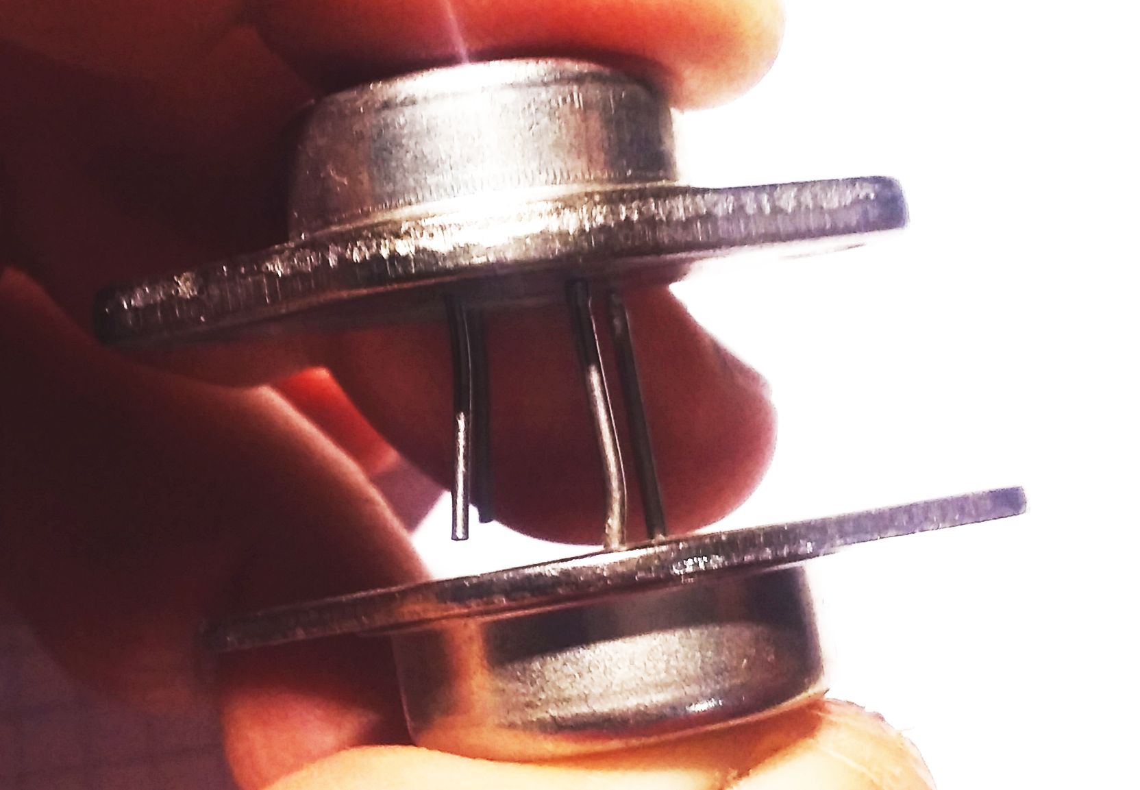

Glad you didn´t actually buy those, they are FAKE
Have been offered them many times, been burnt a couple times, also found a couple inside amps returned for service, installed by unsuspecting local Techs.
The dead giveaway is the 3mm THICK steel base, instead of the usual 1.6 mm (1/16")
They are NOT using the mandatory copper "coin" heat spreader inside, they solder the transistor die straight to
steel :eek:
Double thickness is useless since steel :
On average, the thermal conductivity of copper is 20 times that of stainless steel. In practical terms, this means that copper can transfer heat 20 times faster. So, if you need quick heating, copper will work to your advantage.
Heat Exchangers: Copper vs. Stainless Steel
What irks me is that the transistor chips/dies actually "work", often stand reasonable voltage, might pass some current, but since they can´t dissipate properly, they are useless for amplifiers.
Unless we are talking 15-20W ones that is.
I keep the ones brought as "replacements" by Customers only for very low grade jobs, generally as, say, 12V or 15V 1 or 2A (tops) regulated supplies, small battery chargers,etc.

Many of those thick bases were higher conductivity than steel - some were even copper. The thick base served as a heat spreader. Those packages were likely more expensive than the aluminum TO-3 Motorola would have been using at the time. Not necessarily better, but common in the early days.

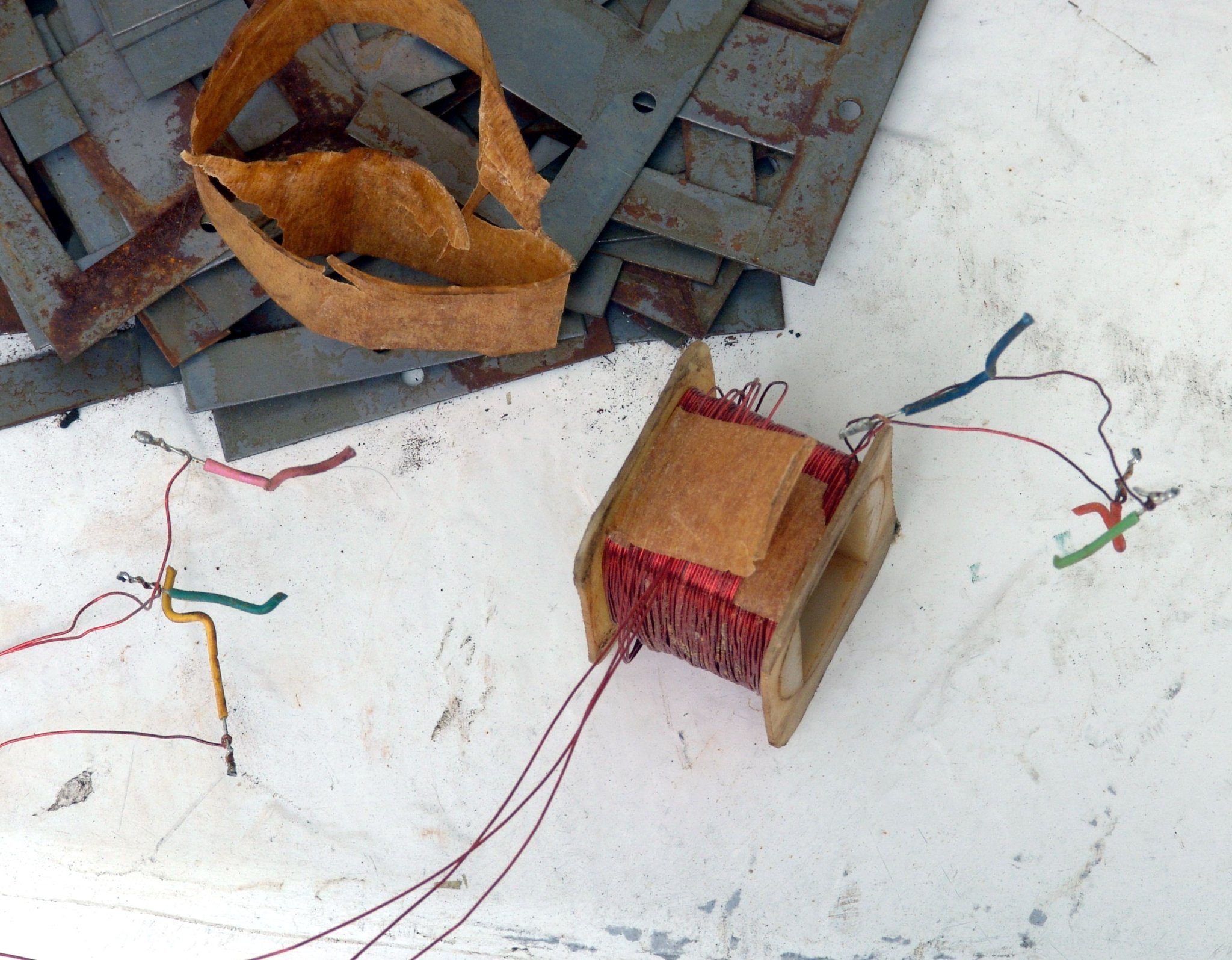

Both amps used the totem pole circuit popular with 2N2147 transistors in the 60's. I used a single supply with a fat cap in series with the speaker. A trimpot across one of the bias resistors set the DC balance. Both driver transformers were DIY on the cores and plastic bobbins of Radio Shack filament transformers.......good enough for a LOUD guitar amp. The pictures show one of the transformers after 50 years in an outdoor shed.
