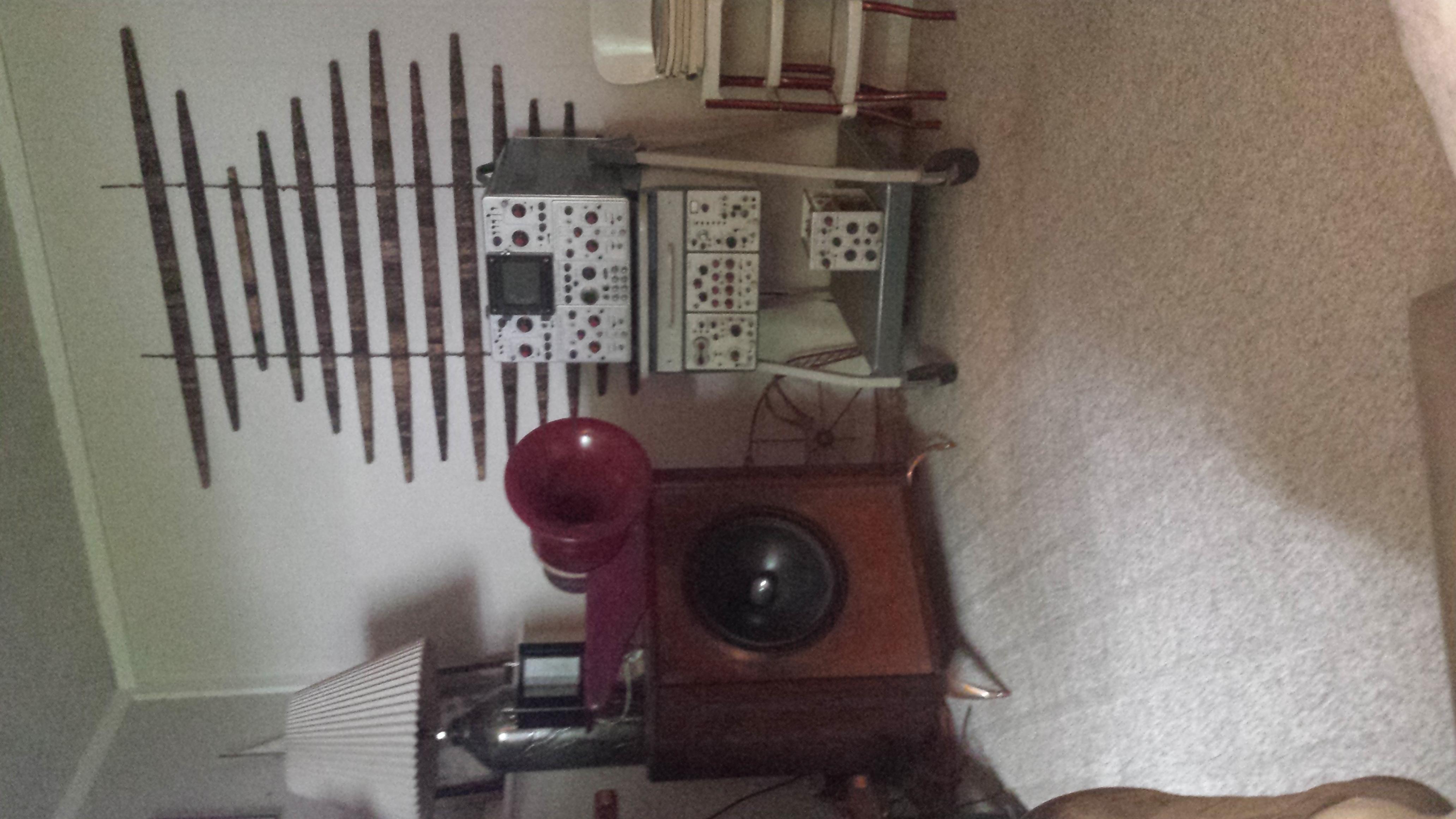

I bought a 556 this morning. It has 5 extra modules and the stock tilt cart too and all the probes and manuals. Is it a good Oscope

If you haven't already downloaded the manual, here's a link.
https://archive.org/details/tektronix_556
It's a fine old scope. My main issue would be the size and power consumption and the fact of some tubes in it. Looks to be 50 MHz so it's way overkill for audio and baseband SD video. Borderline for analog HD video. Have fun with it.
If you have the real estate its pretty good. Heat output is in the 500W range. Its a bear to use with two complete 547's in one chassis. If you don't have experience with a 5XX tek, it can be pretty overwhelming. I had one briefly. As nice as it was it was not that useful.

i'd recommend going through the calibration procedure even if you don't have the supporting gear you'll learn a bunch. Don't actually turn any pots inside unless you have accurate tools matching or exceeding the test procedures gear list.
I had one and yes it kept the room warm but I can understand why Brock0735 would swop you a Tek 465 for it as its a TRUE dual beam , the Tek 465B I had was pretty good .
If I remember correctly it had a Blue phosphor trace --quite attractive.
