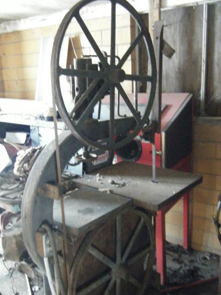

I have a 12" Craftsman band saw and now that looks to dinky. So I just bought a 26" Crescent band saw that I will pick up Monday.

I hope there are plans for a guard for the 26" band saw Yikes!
Yep, I am running a 5hp rotary phase converter too. Between the two my electric bill should go up a bit. I don't have plans to build guards for the band saw YET, but until I do, I will be the only person using it. No one else will be allowed near it.
