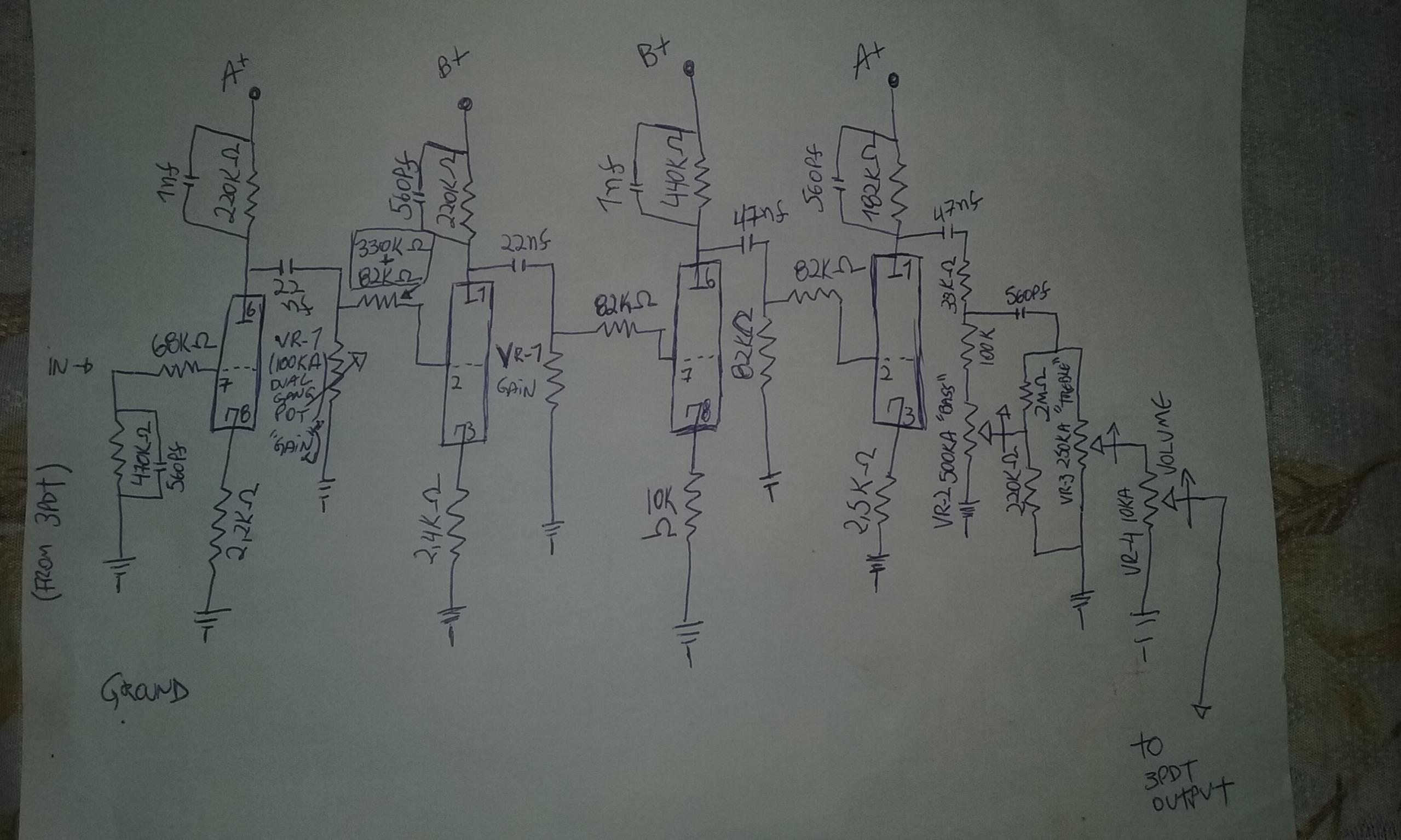

update:
-added local negative feedback loop on v1b;
-changed the dull/hf filter cap from 22n polyester to 28n pio;
-changed the pre tonestack / output cap from 47n brown chiclet pillow to 120n pio;
-added baxandall tone stack (ampeg specs) between the output cap and the output potentiometer;
-increased output potentiometer value from 100k to 250k;

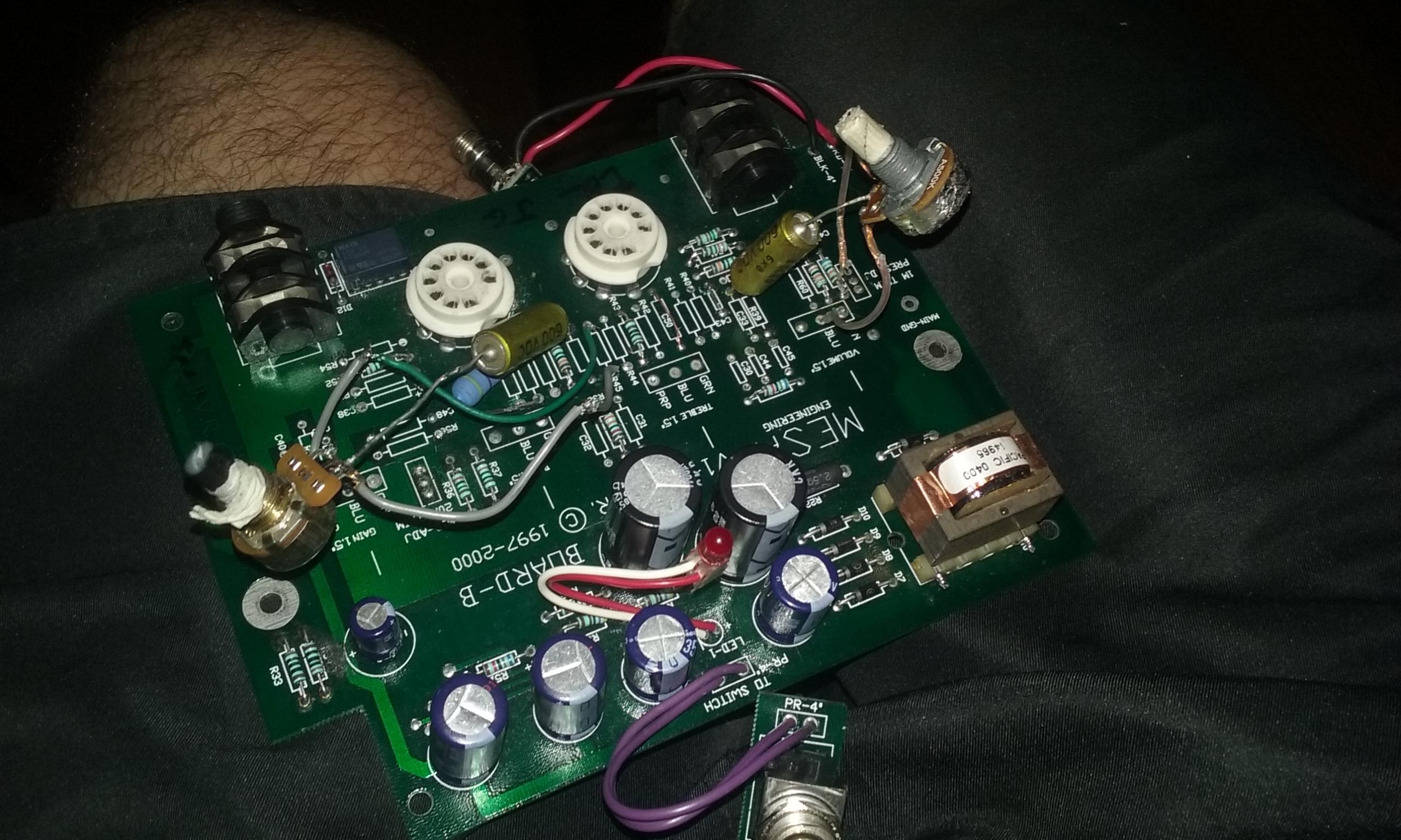

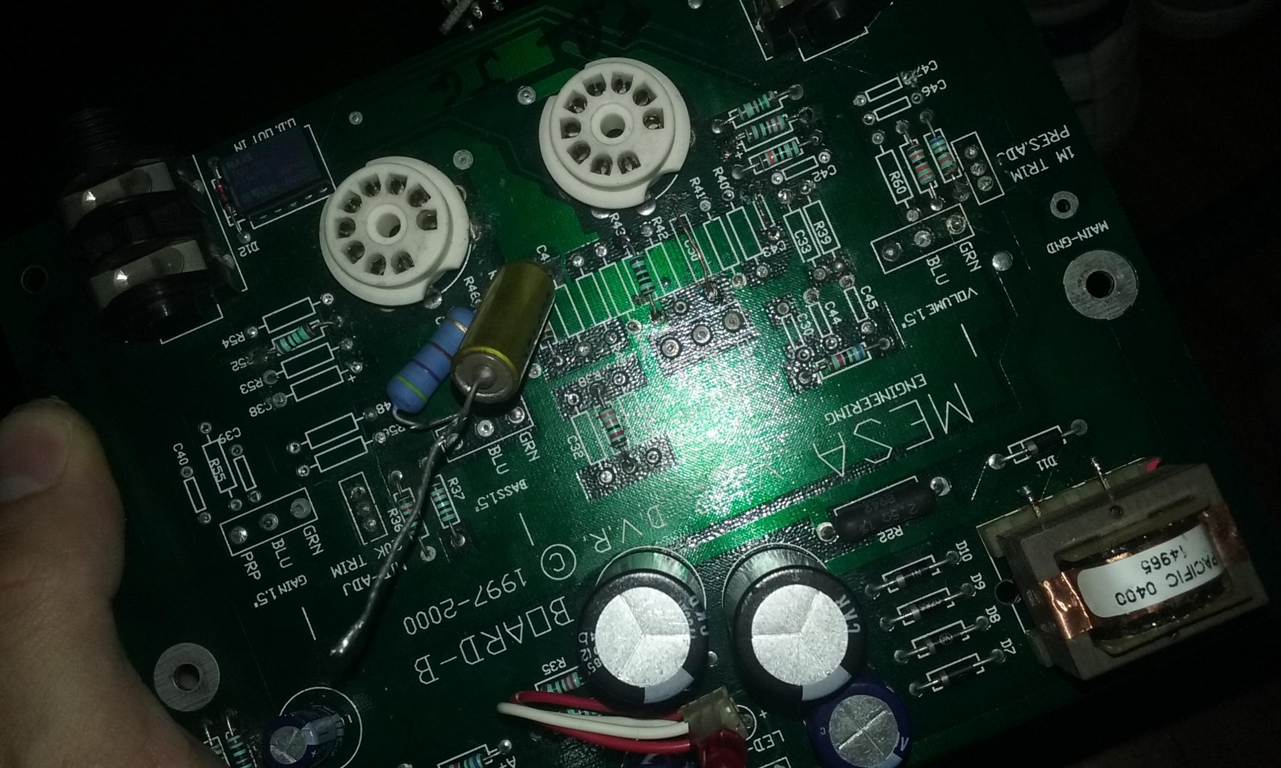

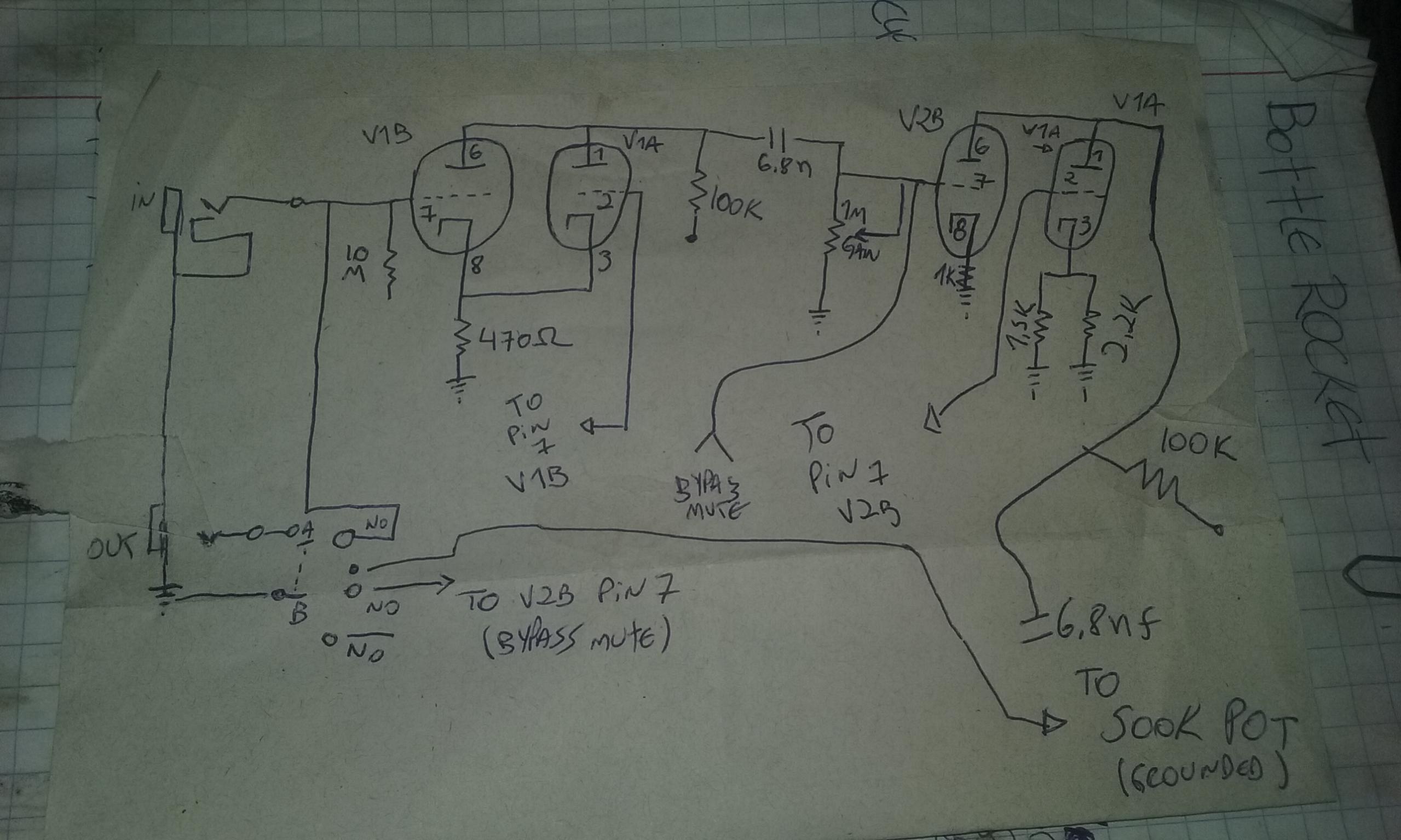

..i've done some study and worked on this 'bottle rocket' pedal, since afaik it can be of worth if made the way i need it...
then i've realized this design unsuit my work, but i could salvage the chassis, socket, tubes, transformer, etc...
so, i've redesigned the pedal from scratch, using the board and some components, although most part of it i've ended pulling off;
i'll describe the new circuit and even draw a quick scheme, but its easy to understand and i still need a little help to overcome some undesireable effects that i'll describe at the bottom of this post
since i've used the PCB, some jumpers here, some lifts there... some things might appear weird, such as v2 cathode resistor been not shared (v2b with 1k, v2a with two resistors in parallell... one 1.5k and another with 2.2k in the bypass cap slot)
the ampeg baxandall tone stack will be placed between v2 coupling cap and the volume pot, but i've decided not to bother with it for now and run tests if the pedal at least work;
then, i've put it to work... it works, the gain and volume pots work and respond well;

thanks for your time reading, please support me by pointing the design flaws and filters required
edit: the schematic drawing is the last image attached

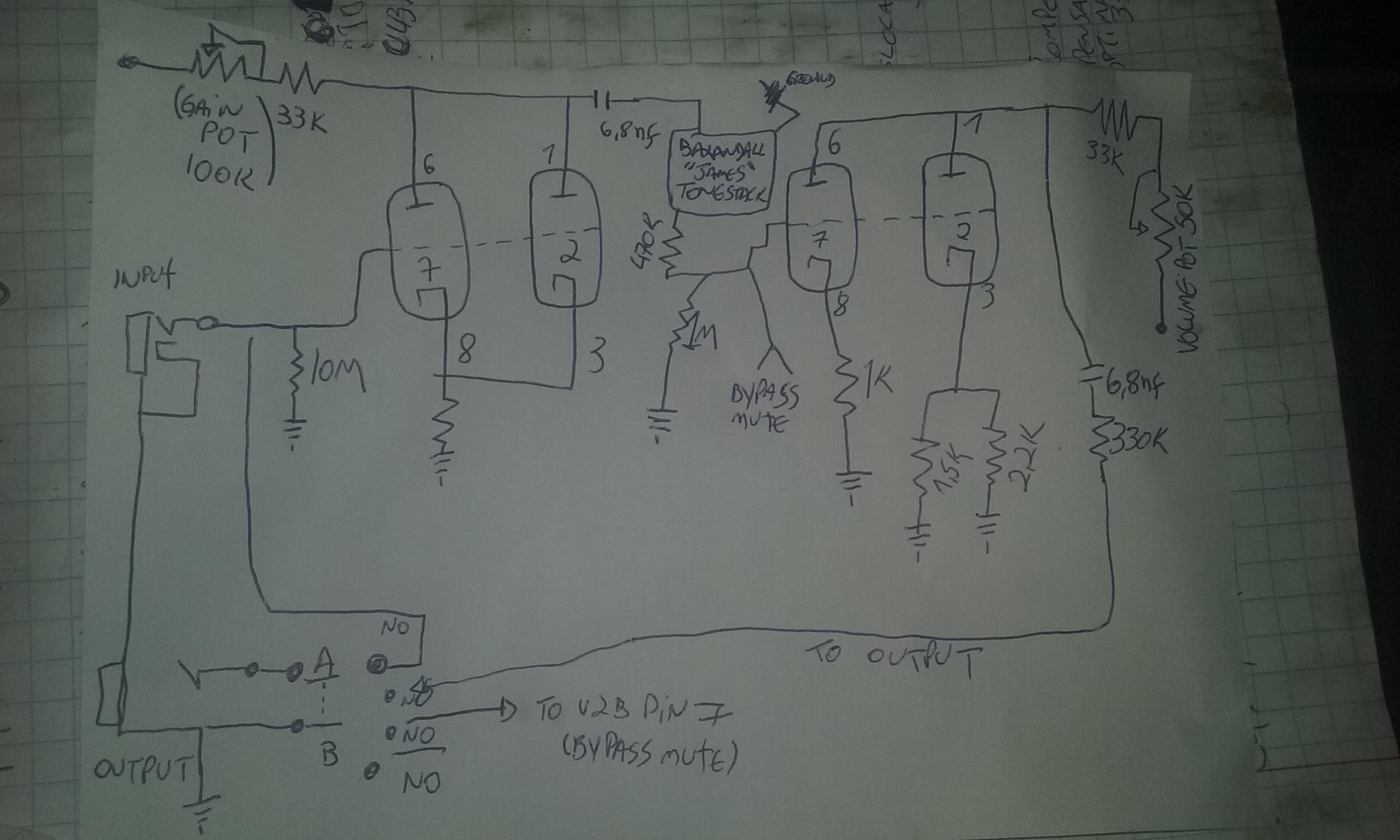

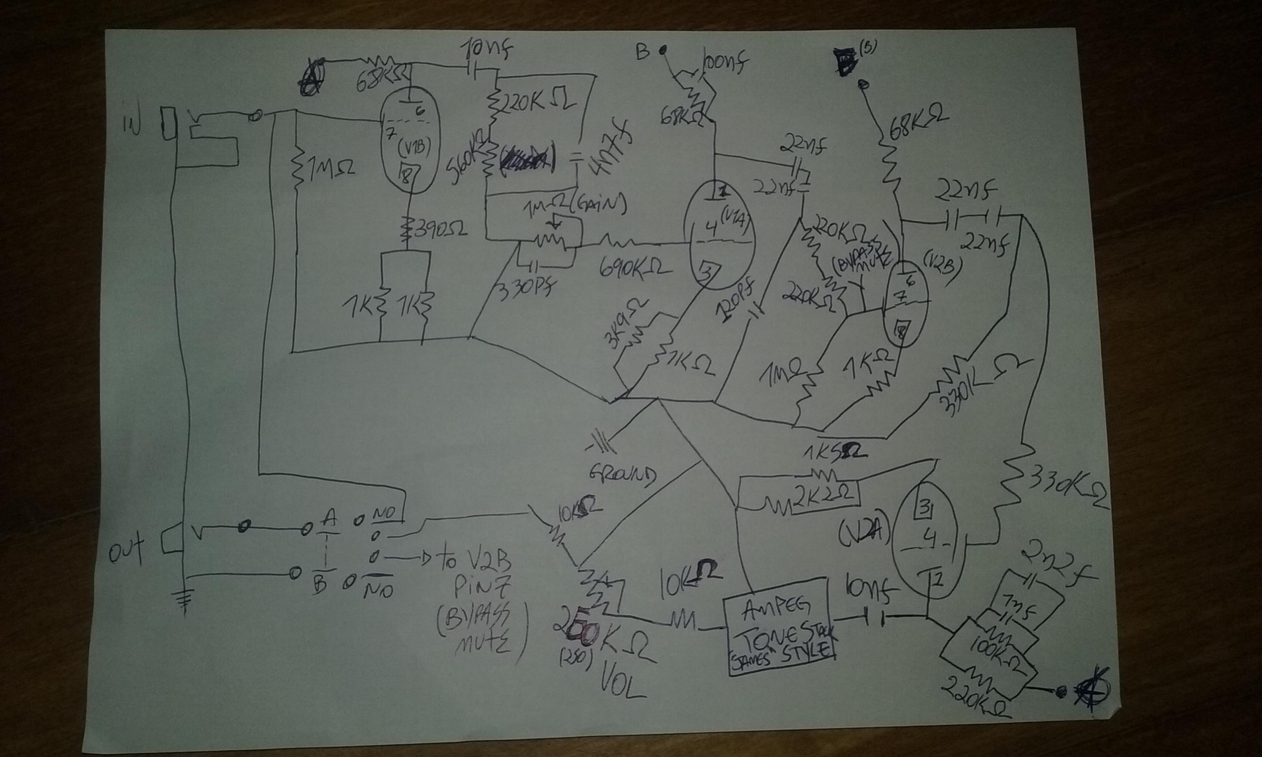

as attached below, the new schematic
good news! now the sound is approaching to a very desireable state
*new v1 plate resistor: 33k + 100k pot/variable resistor in series (gain pot... not a gain pot really)
*added baxandall tonestack between v1 and v2
*added v2 grid stopper
*new v2 plate resistor: 33k + 50k pot/variable resistor in series
the oversaturated with weird dynamics and synthetic note decay could be addressed to the former 100k plate resistor, seen as 200k equivalent by the parallel triodes, on lower Z plate resistor, the sound become more suited and i've found a mid term optimal biasing value
i realized the bypass is colouring the tone and theres pop-click when i engage/disengage the unit footswitch
the RF interference is gone btw
i'll consider tweaking with a low capacitance bypass on the cathode resistor, theres too much bass... since i want this pedal to be closest to a hifi preamp, i'll see what can be done to overcome the huge bass in the guitar overdrive without compromising the hifi possibilities
yet i expect advisal to make this pedal work properly quicker and leave the hell out of y'all at peace *laughs*
so in resume... big bass problem, switching/bypass problem

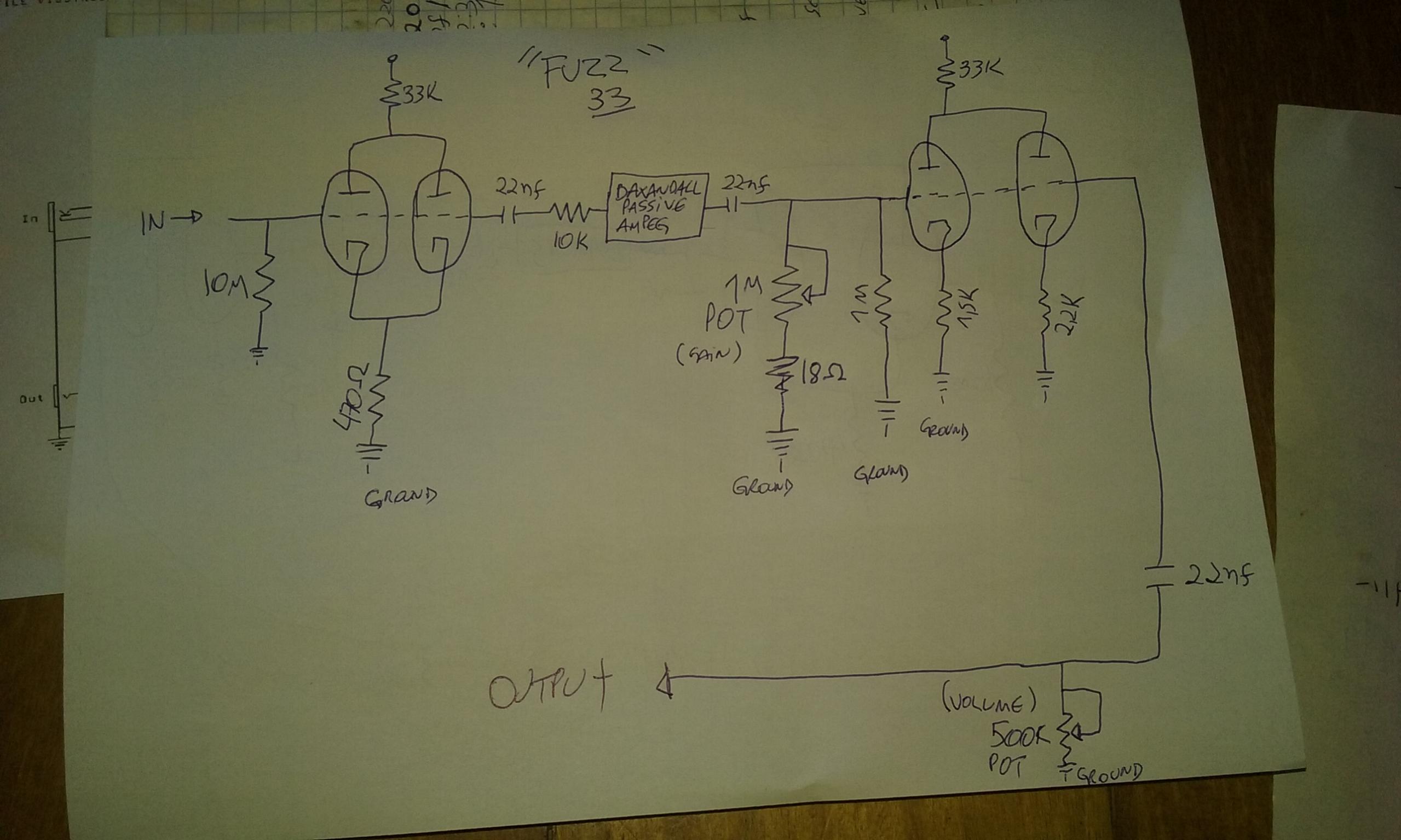

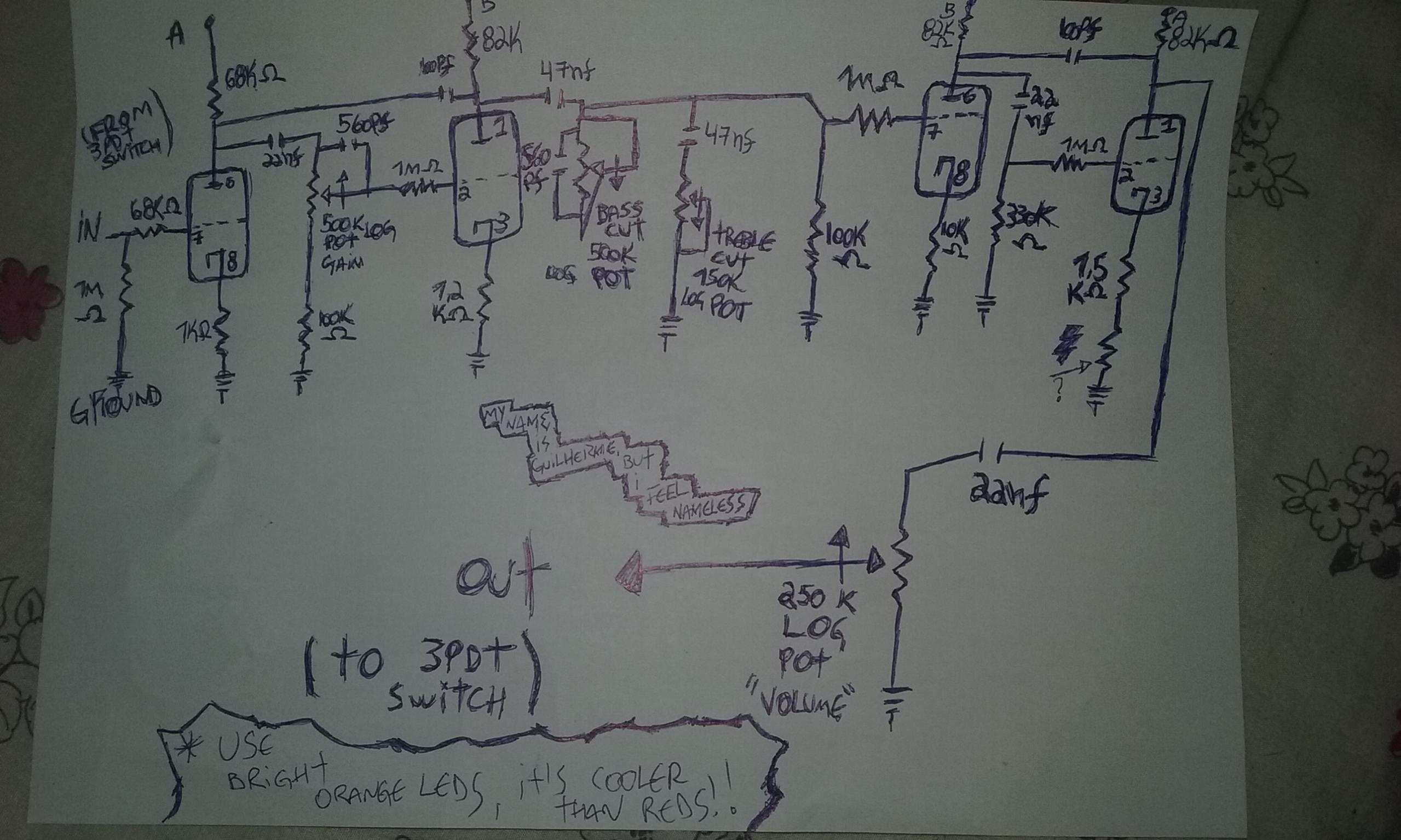

woah! i've discovered a great fuzz by mistake
trying to achieve a good hifi james preamp that lets me boost guitar signal aswell, i've discovered a fuzz in the style of 'sunface' / 'fuzzface' and 'fuzz 69'
check the schematic below and confirm by yourselves...
its got great dynamics and low noise, warm fuzz tones
woah! i've had to write down this recipe, but i will tweak this circuit a bit more, because i aint looking for this kind of effect anyway, besides its great sounding and doesn't have the cons of the germanium fuzzes (plus the passive baxandall eq)
this is my gift for you guys... hope ya'll like it
lots of mojo in it
lots of mojo in it
lol i took a peek at the paper and found myself distracted in the drawing...
v1 plate signal goes to v2 parallel grid, then leaves v2 plate to output
schematic below...
*very stable;
*lots of headroom, lots of gain;
*james tonestack, no muddy low frequencies below guitar range, no annoying high frequencies/feedback/squeal... only useable guitar frequencies, full of rich harmonics, sustain and dynamics;
*no radio interference (i live in a wooden challet, in the hills, close to alot of broadcasting stations);

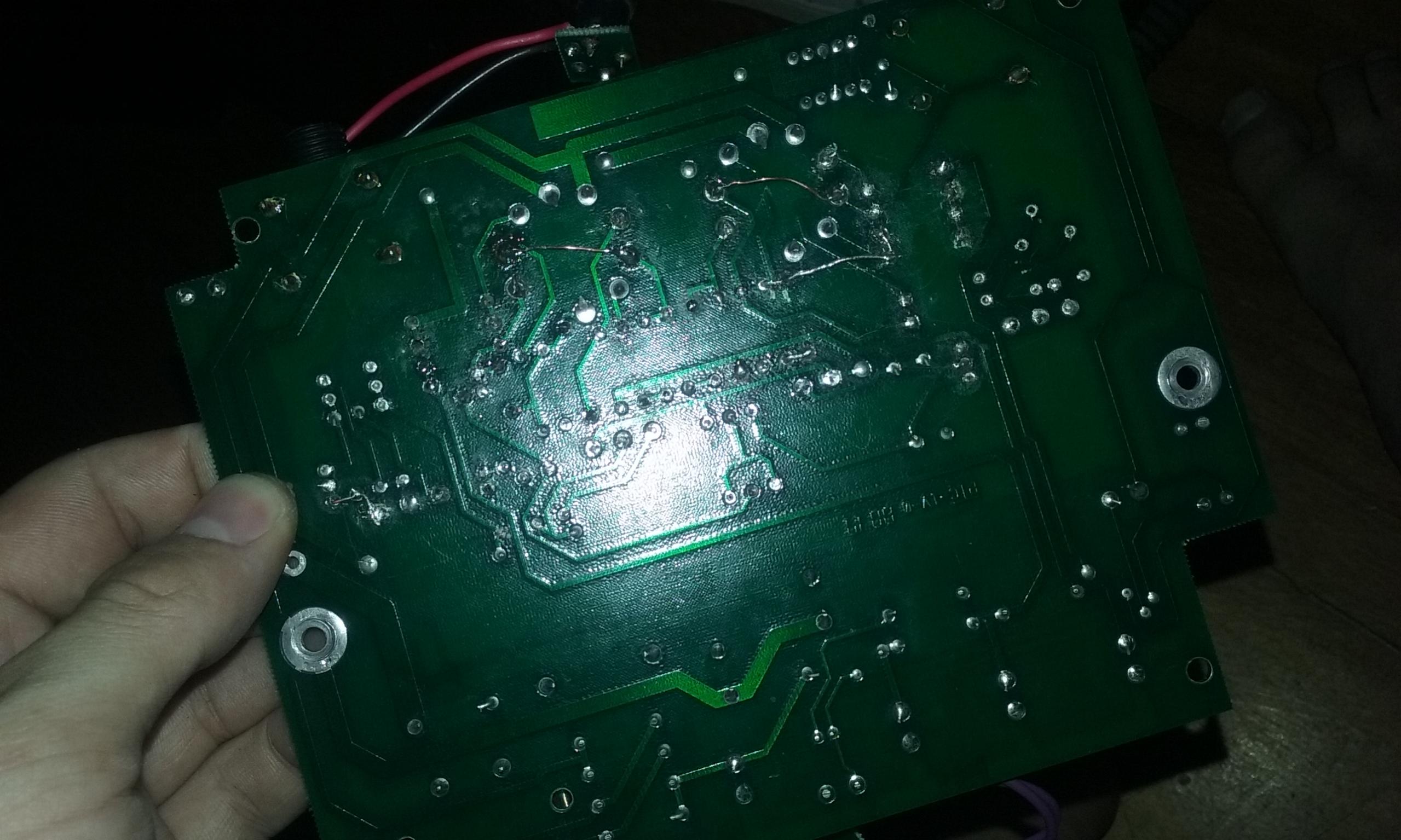

well, i've had a nice break since i've decided to pull off the turbo rat's diodes and add some little extra capacitance between the compensating pins (tonal bliss, no more loss of dynamics, pure op amp clipping/mayhem)
then i've got the enough inspiration to finish this tube pedal (the blackstar ht-dual is hybrid, its pretty cool, but too perfect-ish)
its done, yay!
the popping switch noise was leaky PIO caps, i've realized they leak DC and are no good for me... i've pulled all pio caps out from my gear (guitar, amps)
this stuff really doesnt change the tone as some folks said, its true... its better to stick to stable components and be happy with reliable gear... i do have golden ears and this religion about some components are not a subject of discussion, since it doesnt benefit the performance of the equipment;
the best thing we can do is trust engineers that studied and experimented most, at first their claims might seem skeptic or 'tone lacking-wise' but i've wasted time arguing and experimented to find out this 0,000001% stuff doesnt change tone/timbre at all
a silent, stable device is the way to go
i hope this knowledge/ statement helps

the pedal was cool as stock, but i needed less clipping, no mid scooping, increased dynamics, more note definition and louder output, so i've went all the way into what its the actual design
yes, the idea of this pedal is based in the od/ distortion controls: gain = ammount of signal to slam all stages, treble = ammount of treble distortion, etc...
most of what i've done was by experumenting, since i am not good in electronics
after this sunday gig i've realized it would be of an improvement if the bass cut gets relocated into the fx in, right in the 68k grid stopper before the signal reaching the first triode, because theres no other capacitor there to be seen in series with the bass cut, improving the control effectiveness and saving the earlier triodes from wasting power amplifying certain lowa
the treble cut will be relocated to the gain pot stage, so it will work exactly like a les paul 50's wiring volume + tone for guitars... i believe this approach will benefit from the co-op between both pots acting together as a grid leak with treble filtering;
the 100k grid leak with the filters was a bet to sweeten the signal and keep the tubes in a good operating point to decrease clipping and also to decrease the need for more attenuators/filters, mantaining the signal into less components, i had no clue if it would work in a good way
the 1m grid stoppers: a choice to mantain the headroom, clarity, noise stability and zero blocking distortion with no need for treble/rf/oscilation filters, i liked it mostly, but the increased resistance in series with the signal path gave a jet/high pressure/ jolty feel to the response... very 'shiny/sparkly/bright'
after moving the tonestack in the next upgrade, i plan to decrease the 1m grid stopper located in the sector where the 100k grid leak is placed, to see what happens... i think the stopper will be of 500k, if it works well, then i'll lower the 330k leak in the next stage into 100k and also halve the stopper from 1m to 500k
i think its gonna get better and wont be a waste of 4 triodes in series, even for a booster.
i have no audio samples, but i can record a video
you can also check our band demo songs to understand the kind of guitar tone/preferences that i'm into
so... now you understand that i dont understand much what i'm doing in theory, just been backed up by the experimentation with one or anotgher tip from the fellows of this forums, feel free to participate!

further upgrades
schematic added
conclusions on this run: compression can be considered a valid approach into taming 'loud level' foggy overdrive
high Z rp can lead to winter feelings due to the leaves falling from the tree in such kind of a rusty pattern, so clip the can into 'em!
maybe theres no need for a high Z grid stopper if the grid leak is also kept low
try it
further upgrades
schematic added
try it
I suggest downloading Radiotron Designer's Handbook 4th edition. There's a ton of information in there, particularly Chapter 15 which deals with tone controls.
Your filters do things... but, no offense, are rather crude. The gist of it is, passive RC filters tend not to perform optimally as variable filters. In all honesty, for guitar amps the standard Fender TS is as good as anything ever designed. You can tack on a LPF (similar to your treble filter) for additional control.
Is there a reason that you're wiring your gain pot as a vari resistor as opposed to standard poteniometer? As you currently have it, the load presented to the preceding gain stages (dual ganged) isn't constant. Technically there's nothing wrong with that, and you're using a relatively large coupling cap so LF response isn't affected terribly. But, IME, the AC load does affect the tone (along with affecting gain) and having a constant load gives more predictable results.
The 5k output pot is extremely small load for the preceding stage - I suppose that's the reason for the large 0.22uF coupling cap. Again, not technically wrong (IOW, it'll work), but loading down a stage that heavily isn't optimal.
Respectfully, I really think you should study some schematics and figure out the basics of tube circuits. The Radiotron handbook has everything you'd need to know, but it's a tough read for a beginner. The original Mesa circuit of this pedal is actually based on a very successful circuit to begin with. Study that and figure out what makes it tick.
i've spent thr last hour writing here and my cellphone just laughed at my face, now i've had enough of it
thanks for your advice, best luck to all of you
after all this experimentation doing weird things to the pedal, i've understood that its important to use cathode bypass caps and not to bother if its electrolytics or anything else
the downside of cathode degeneration is not worth the extra dynamics with clean headroom it has to offer
its important to experiment different plate values and hear what happens...
fwiw its nearly impossible to have both a hifi preamp and fuzz/drive on this circuit, so i've gave up the hifi thingy and approached into the guitar saturation for this pedal
the most conclusive finding so far is that when we plan to experiment 'wrong' design ideas, there can be results difficult to achieve by normal means
the pedal will reach its final version once i give up improving its flaws... i will need more time gigging with it to make up my mind if its good now...
