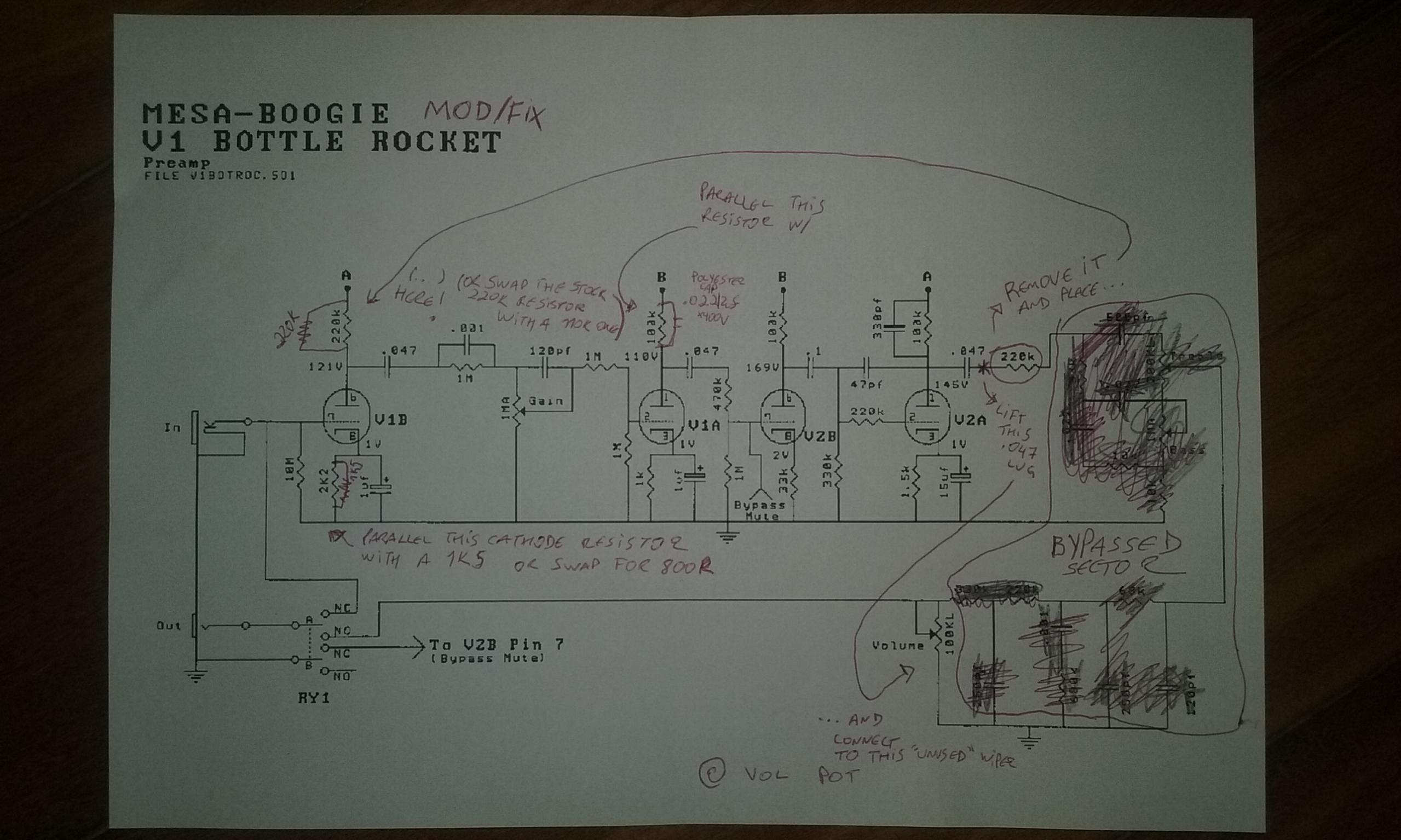

after finishing the edit/mixes and the release of 5 (out of 11) demo tracks from our band, i've decided to take a breath;
then i've accomplished the 'full tone stack bypass mod'
i dunno why, my android phone is not uploading pics, so i'll try to describe how the bypass was done
*detect the .047 brown chiclet/pillow shaped capacitor closest to the 220k resistor tone sucker placed before the tone stack (looking to the side where the components are seen / where the tube sockets have its pins for the valves to be inserted, is located left to the sucker resistor, south from the v2 tube)
*lift the south lug of this detected .047 capacitor, the south lug is the lug closest to the footswitch and the potentiometers;
*solder a wire or something conductive of your choice from the lifted lug of the capacitor mentioned above to the unused lug of the volume potentiometer (the stock settings of the volume potentiometer had two lugs out of three being connected to the circuit and one free lug, unused)
this mod rendered the Bass and Treble controls unusable, a wide, flatter frequency/EQ and more gain/output, much more;
overall, it was worth it;
then i've unsoldered the 220k resistor piggybacked in the v1 tube biasing section, but i've tested the pedal before doing it, to hear the difference;
with the stock settings for the v1 bias, the sound had more compressed and harsh characteristics, i am seriously considering to remake the lower resistance bias mod suggested by our fellow Printer, but i'll experiment a little more before deciding, even so i'm almost sure that its more suitable for my work to lower the v1 bias resistor values, because it makes the pedal closer to a booster;
with or without the changes in v1 resistor bias, there was an issue bothering me a little: the pedal is useable, and have good output, enough to 'expand' any tube amp instead of mushing out like before, BUT... if i raise too much the gain and volume pots, the amp starts to squeal like an overdriven amp on 10 being pushed by a Proco Rat on 10 with the filter on 0
maybe because the bottle rocket is too powerful now, or the highs need to be tamed a bit, or something else that i dont know, so i ask guidance about this subject;

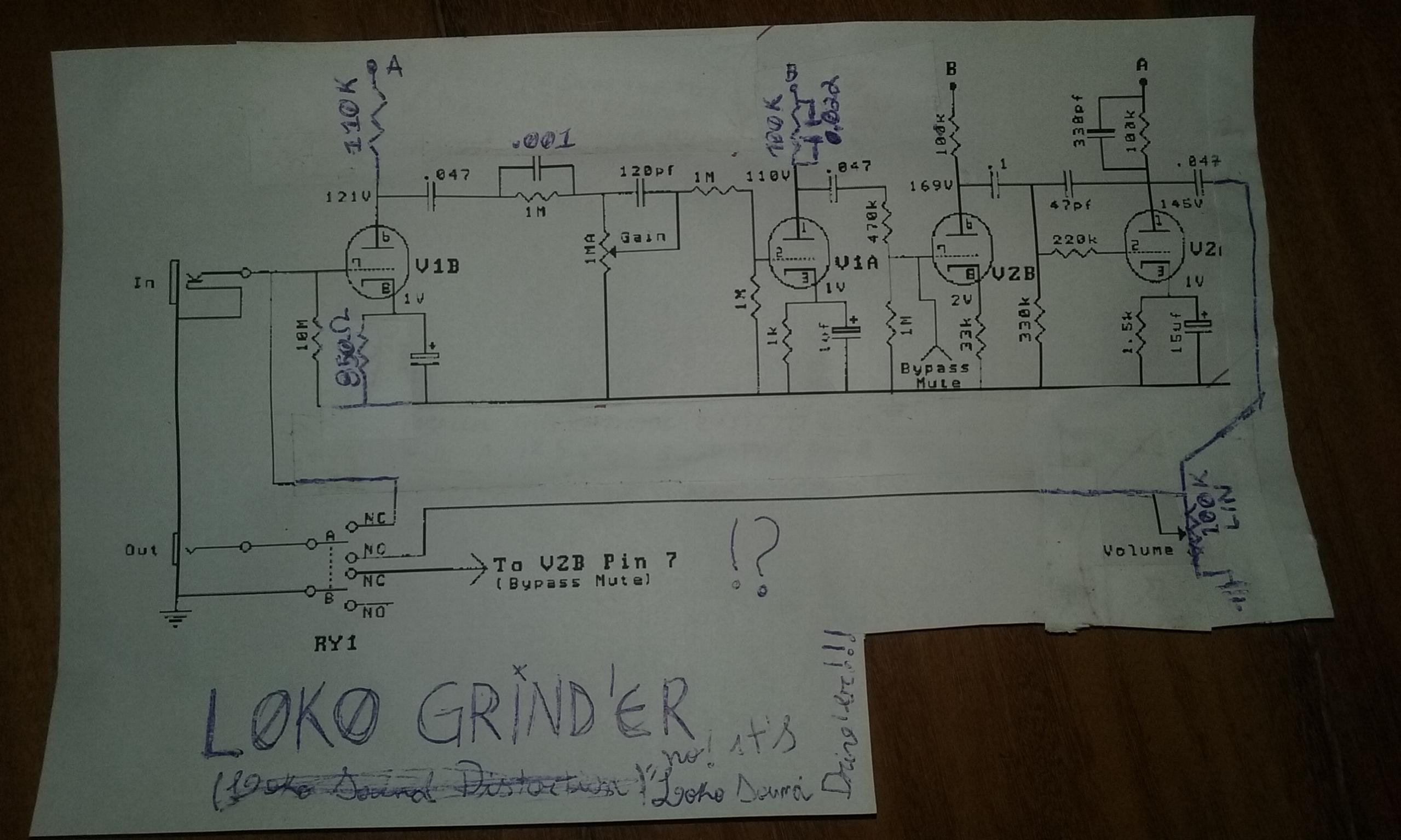

another question: i've seen the schematics again, and it looks like theres no input resistor (i can be wrong)
in case theres really no input resistor or if theres a low Z input resistor, would there be any benefits if i add one or increase the input resistance? if yes, which value could be optimal in theory?

Hey welcome back. The schematic says a 10M resistor, kind of high but when the guitar is plugged in the impedance drops to that of your guitar's volume control. The squealing, try a cap bypassing the plate resistors to find out which stage it is. A design that is stable may not be if you increase the gain, as you have found.
aahh... THAT is the input Z! i see it close to the pin 7, yes... i thought the resistor was something like... in series with the input, such as input > resistor > something else

OH MY GOD, PRINTER2!!! I AM YOUR FAN, I SWEAR UR MY MASTER OMFG!!!!
i was obcessed in finishing this pedal.
then i've holded a small ceramic cap, 1k or 0.001uf with pliers and random picked "possible" plate resistors (linked to pin 1&6) from the back of the circuit board, since i was too mentally affected to disassemble it;
without bypass cap, there was squealing and radio frequencies;
the sweet spot was the plate resistor of pin 1 from the first tube, the same v1 tube that you suggested to halve the resistance from pin 6 plate resistor and its cathode aswell;
many caps and values were tested (ceramic, polyester, P.I.O)
i've had to fully scoop mids to 0 in my amp and crank to 10 on bass/treble/presence to confirm if there would be highs rolloff;
before doing so, i've spent the last night studying about this capacitor bypass thing, many techs said its used as last resort, the calculators suggested 1/100th of the resistor value (100k Z = 0.001uf... i might be wrong)
i was shocked with the practical test results:
... 22k (0.022uf) polyester cap for perfectly squeal/radio rolloff without losing the highs!!!
man, i must admit: the halving of v1 pin 6 plate resistor + its cathode + full tonestack bypass + 220k tone stack resistor removal (used to piggyback in parallel with the pin6 resistor) + v1 pin 1 plate resistor cap bypass mod with 22k polyester, resulted in:

Cool. If you could, because you did so many changes and it might be easy to miss something, maybe print out the schematic and scribble part valued and added, bypassed parts on the schematic. And take a picture of it and post it. It would be good to see the big picture that a schematic can show what you finally achieved. And congratulations, you have gone further than most people would and actually got what you wanted. Not so easy a task with what you started with.
sure thing! i'll gladly do it!

also in respect to Printer2's request, i'll edit the schematic into the current pedal specs, but as i said earlier, my phone got some kind of bug (yeah... its literally bugged) and i have to root it, but i'll tweak something this week or next to quickly upload the new schematic here ASAP, count it on

theres the request:
-scratched original schematic
-organized modified schematic (i named it Loko Grind'er)
-22k polyester cap (looks like orange drop but its just a phillips)
i could talk more, but im kinda depressed;
again, thx
again, thx
It makes sense for what you wanted to get out of it. I can see it working well. I don't have time to try every circuit so I am interested when people go off the beaten path. And while I had an idea on what I thought would work until you actually do it you don't know. Whereas you know. Nice to get at the end of a journey with what you were hoping to find.

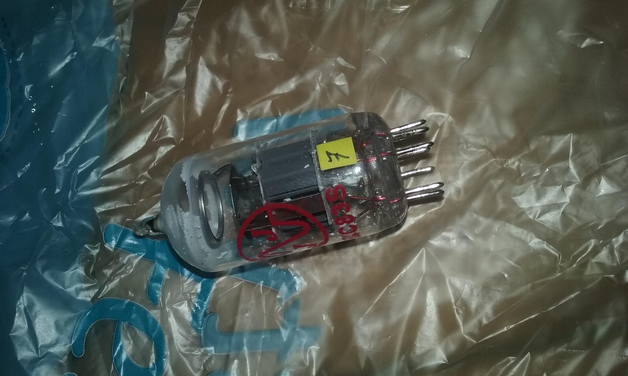

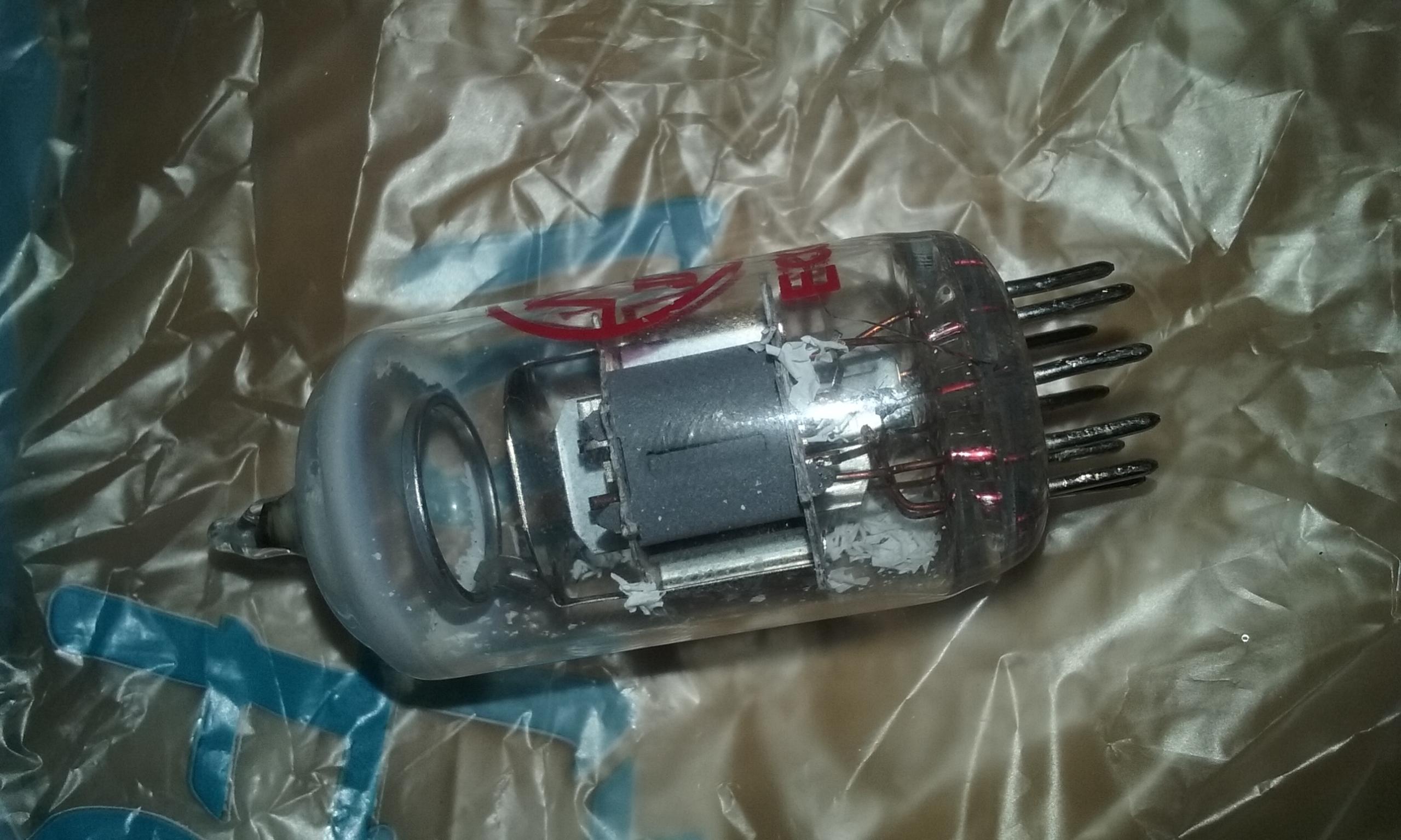

the v2 preamp tube of my amplifier just burned out, leaving the getter white, the tube has some sandy white dust inside of it and the tube glass cracked... could by any chance this damage in my amplifier be caused by the strong output/voltage of this modded pedal?
I'd guess mechanical impact😱the v2 preamp tube of my amplifier just burned out, leaving the getter white, the tube has some sandy white dust inside of it and the tube glass cracked... could by any chance this damage in my amplifier be caused by the strong output/voltage of this modded pedal?
alright friends, many thanks and sorry for bothering
it could seem off-topic, since the question concerned a tube amp, but it happened after the bottle rocket (a.k.a loko grind'er) modification, so i thought it wouldnt hurt to be sure!
it might look like mechanical impact because of the cracked glass and stuff, but i'd tell ya i'm very careful when handling this stuff... it's very expensive round here.
since the crack appeared very close to the pins of which are attached to the sockets, maybe the tube got stressed out by being swapped many times due to the mods and tests on the amp
l8rZ 'n many thx!
l8rZ 'n many thx!
