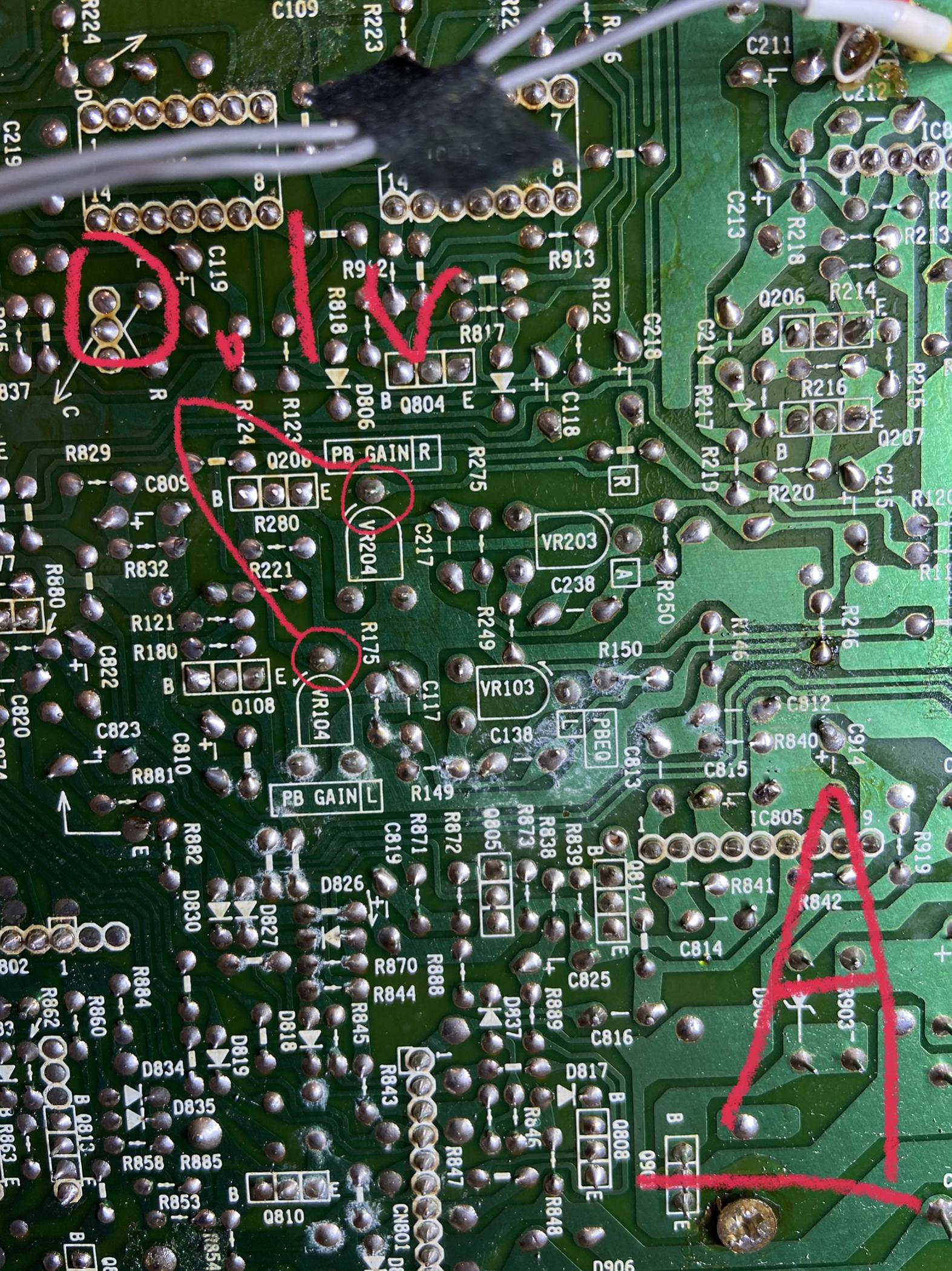

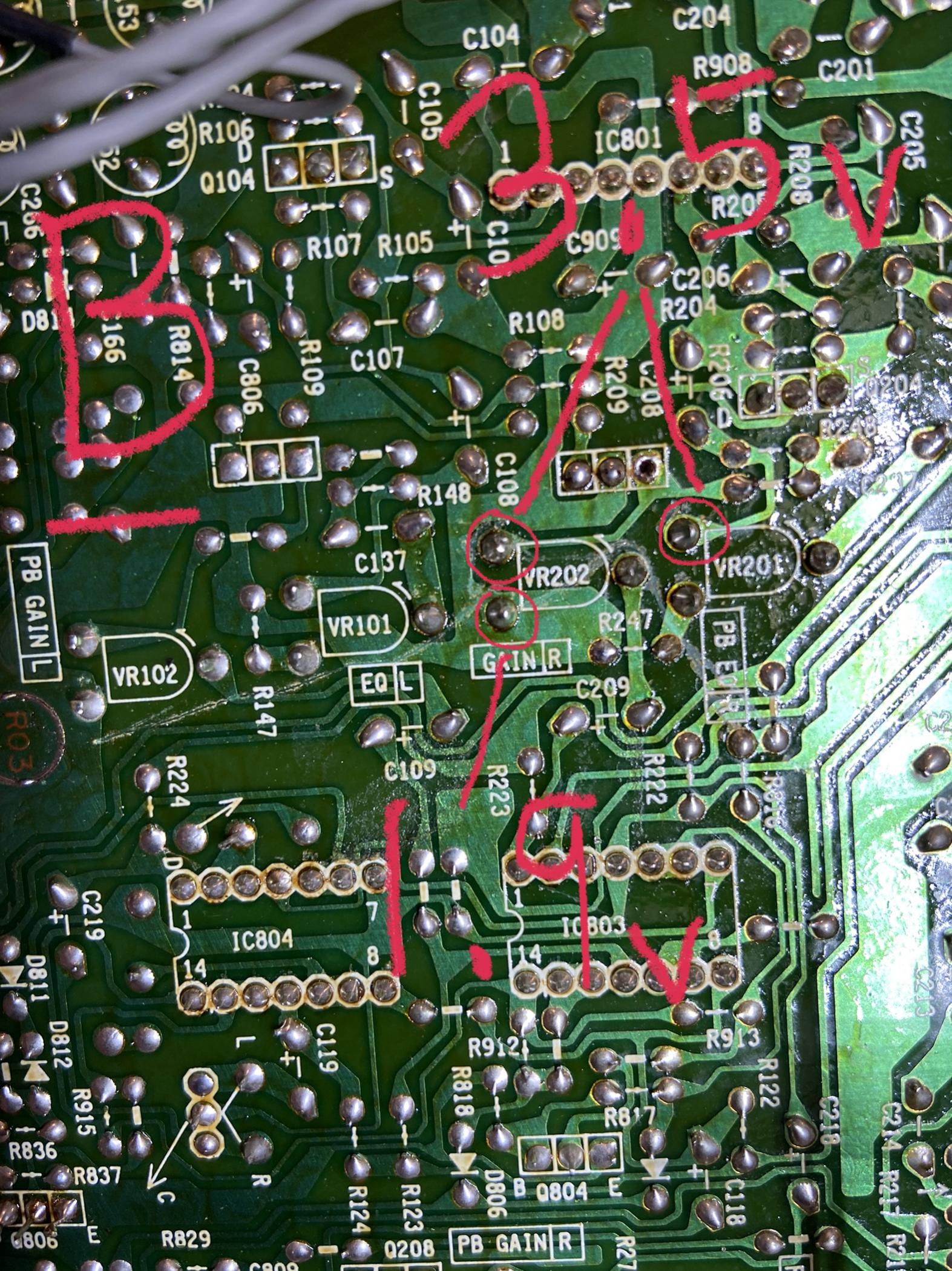

So...with power ON , but nothing playing, I measured the 4 "VR" trim pots (each) for both transports. I've attached a picture. I measured each of the 3 solder points for each VR. I get roughly 3.5v at two spots on transport B, but I say "roughly" because as soon as I start to measure, the voltage starts dropping. I also get roughly 2v at one spot, but it too starts to drop when I measure. All the other solder points for all 4 pots show 0v
Moving on to transport A, I measured each of the 3 solder points for each pot (VR). You can see the two points where I get just under 1v, and it drops quickly. All others show 0v.
Does that shed any light on anything? That white residue you see is just where I had cleaned with IPA after reflowing a bunch of solder points.
