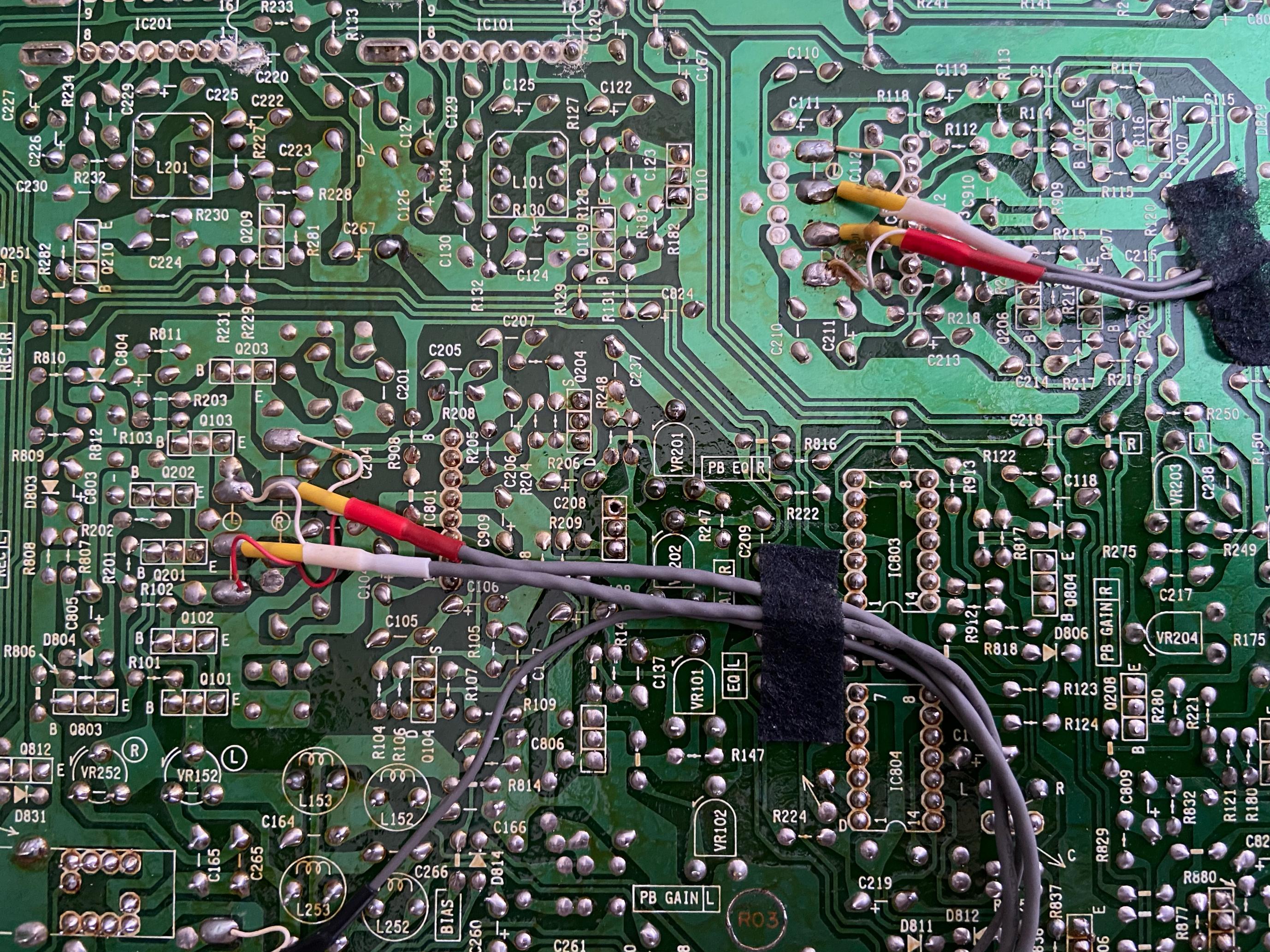

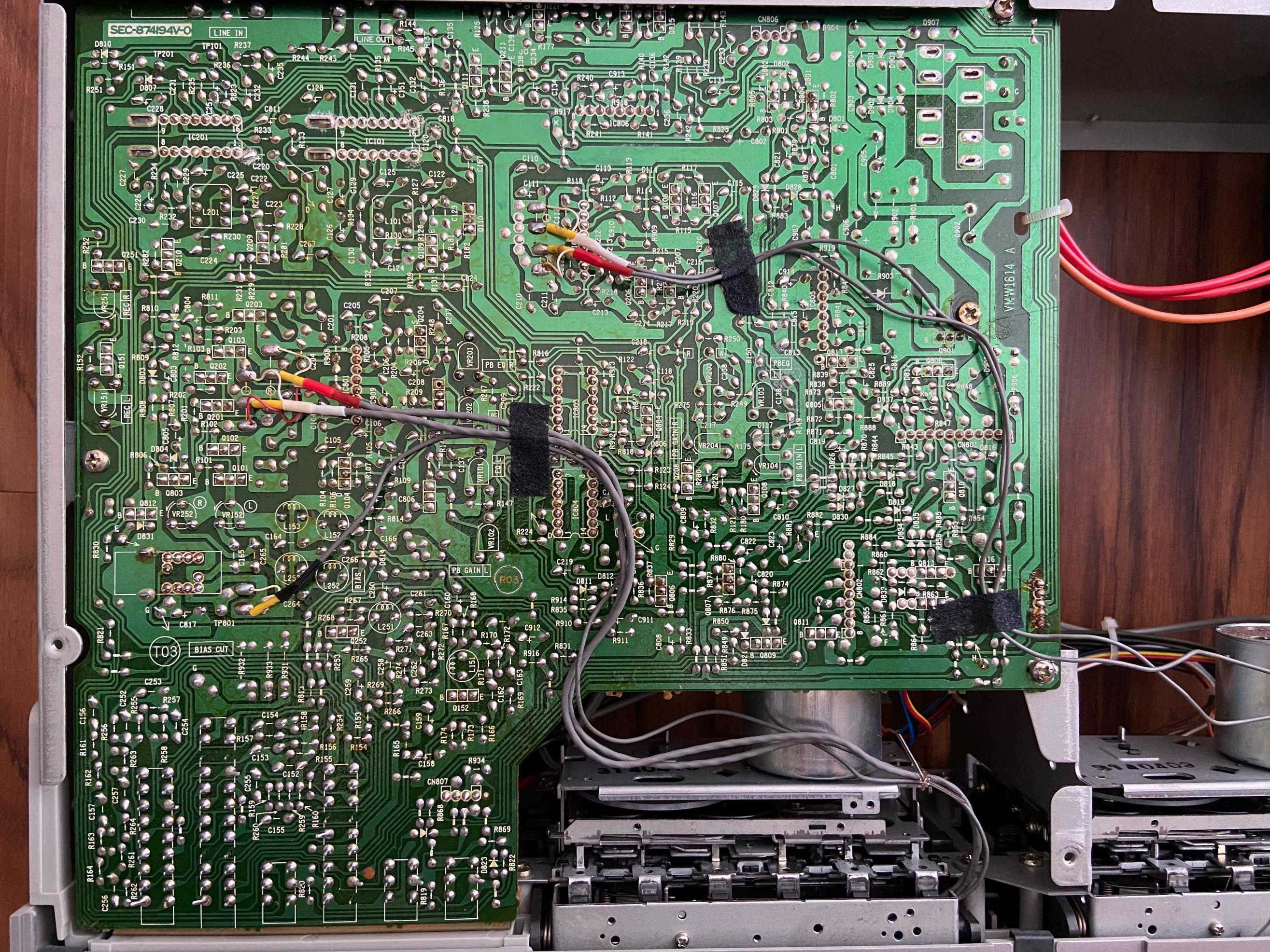

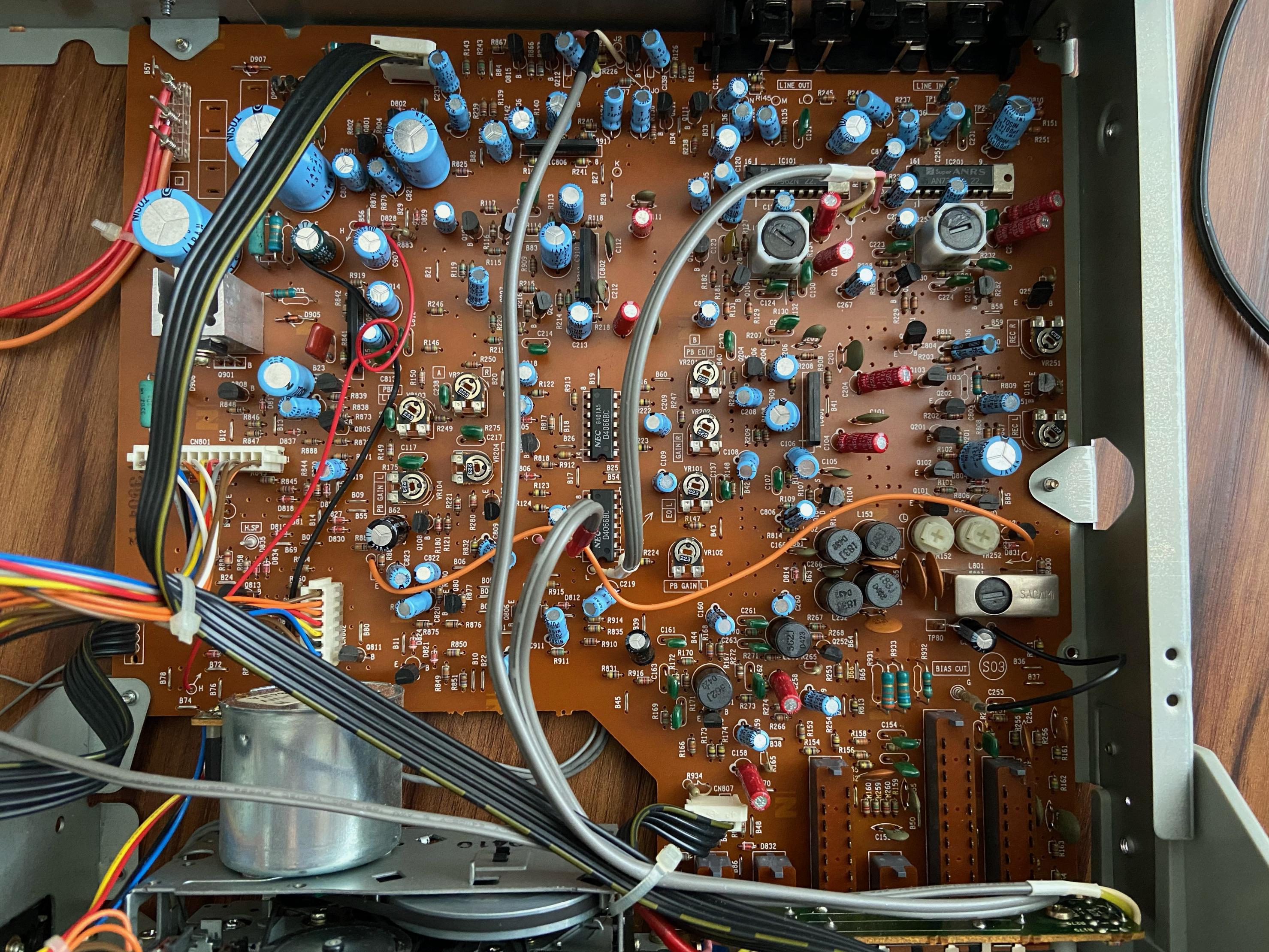

It's not the cables. Lol. The audio and LED meter for the right channel from both decks shows no signal. Can someone please tell me what to check first? I went ahead an reflowed the solder on most of the IC's. No change. Thanks!!!!

The tape head wires from each transport go to different parts of the circuit board, as can be seen in the photos.

Well, the problem is likely where deck A right signal is merging with deck B right signal. Its located in the upper left part of the board.
You already tested line input and record, that is far right side of the board.
You can verify if both heads provide both left and right signal by testing ac in the middle left for deck A, nicely labeled there, just touch wiper of play level trimmer, left and right channel, repeat for deck B, all well labeled. Do not move the trimmer at this point, just check for music signal.
Once verified all is good there, what remains is small part of the board upper left. There may be some transistor which is not switched on or off and is not merging right signals. It could be just cold solder.

When you play cassette in the deck A, you can check signal on the playback level trimpots, PB level L, schould have music signal, as left channel is working, compare PB (playback) level R and see if signal is there, my bet it will be
You can do the same for deck B.
You can check the level on EQ trimpots, these adjust high frequencies, I would not move them, just check the level on wiper. If both channels have signal, your are ready to move to 'shared electronics'.

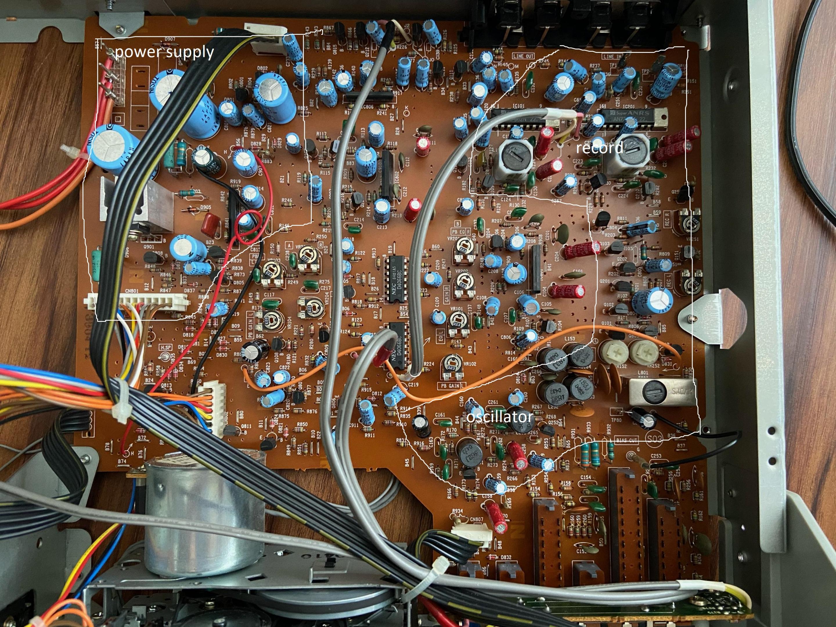

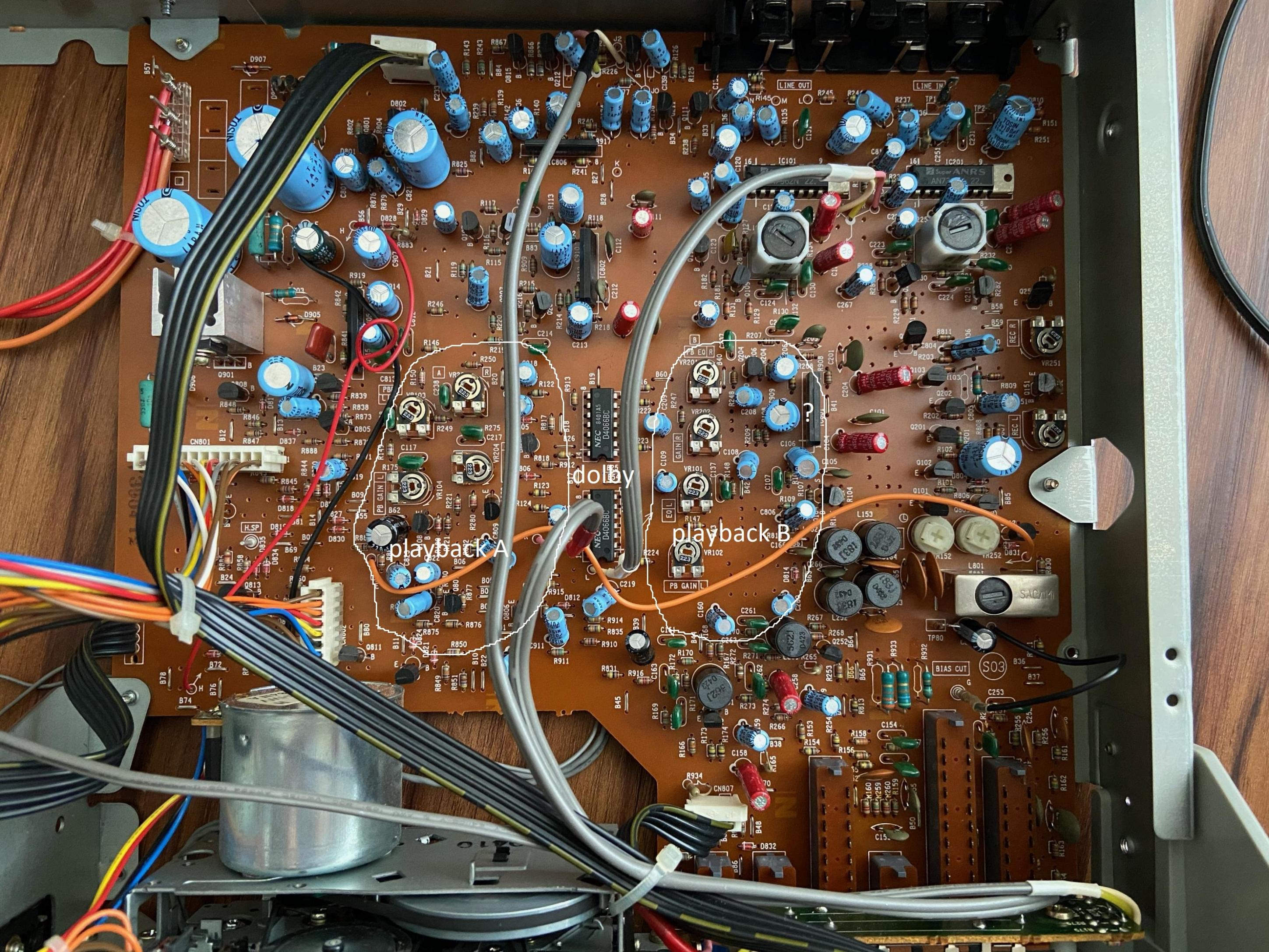

My bet the problem will likely be where both deck signals merge. But I am not certain what those chips are, likely some dual operational amplifiers. So I may be wrong here, but as I mentioned before, you can start from the back, from the line level out jacks and keep comparing left and right signal, till you find the problem.
