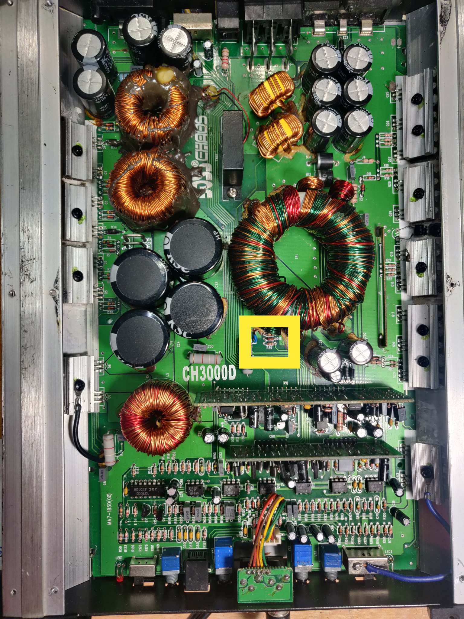

Have a Boss CH3000D monoblock here that has an issue where the amp would thump the subwoofer in and out repeatedly when powered up and the amp powers up with remote but remains on when remote is removed and only turns off when RCAs are unplugged.
I found that the bass boost knob when turned would cause the subwoofer to pull in and out also. The knob was swapped out but the problem still exists. After changing the bass boost knob the amp would turn on and had clean output when tested in a vehicle but the thumping returned at high output level and then when the remote was turned off, the amp remained on until the RCA plugs were removed. There were a few strands of wire still soldered to the case of the input voltage selector switch as if there was a ground jumper that came off. I resoldered a wire to it and screwed it down to the regulators heatsink clamp but nothing changed.

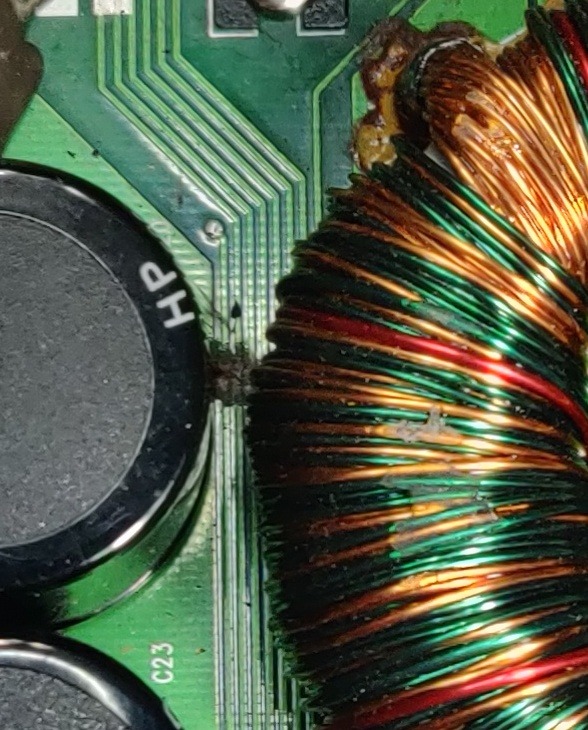

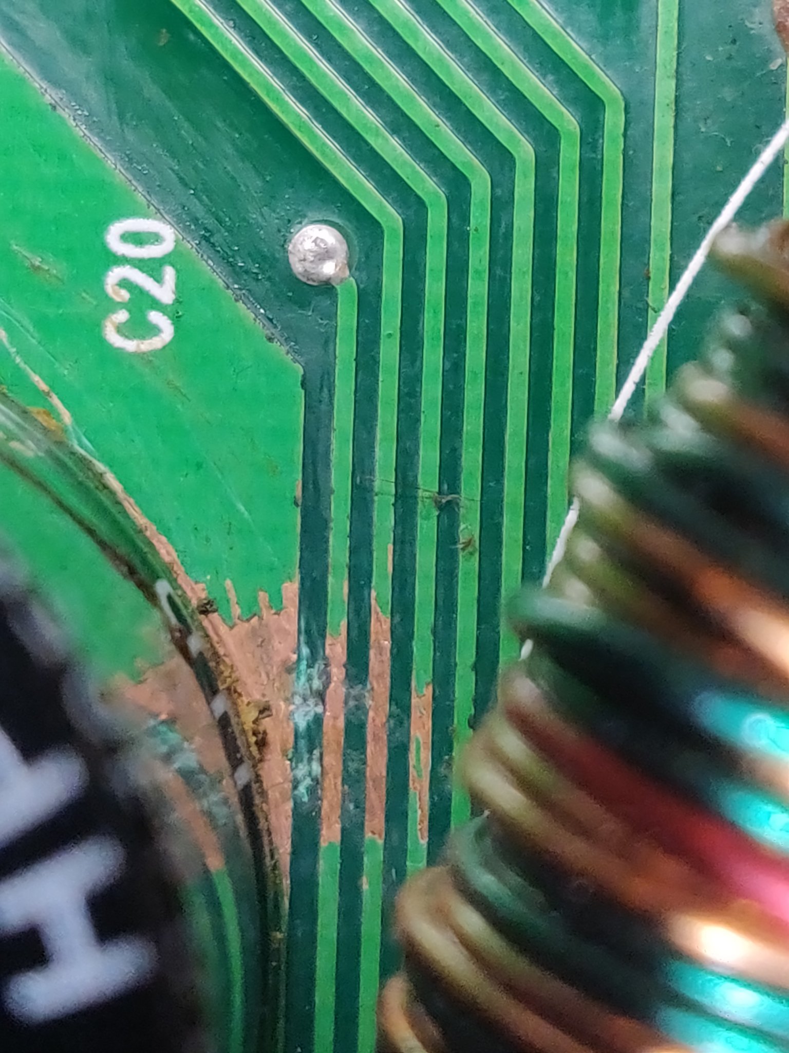

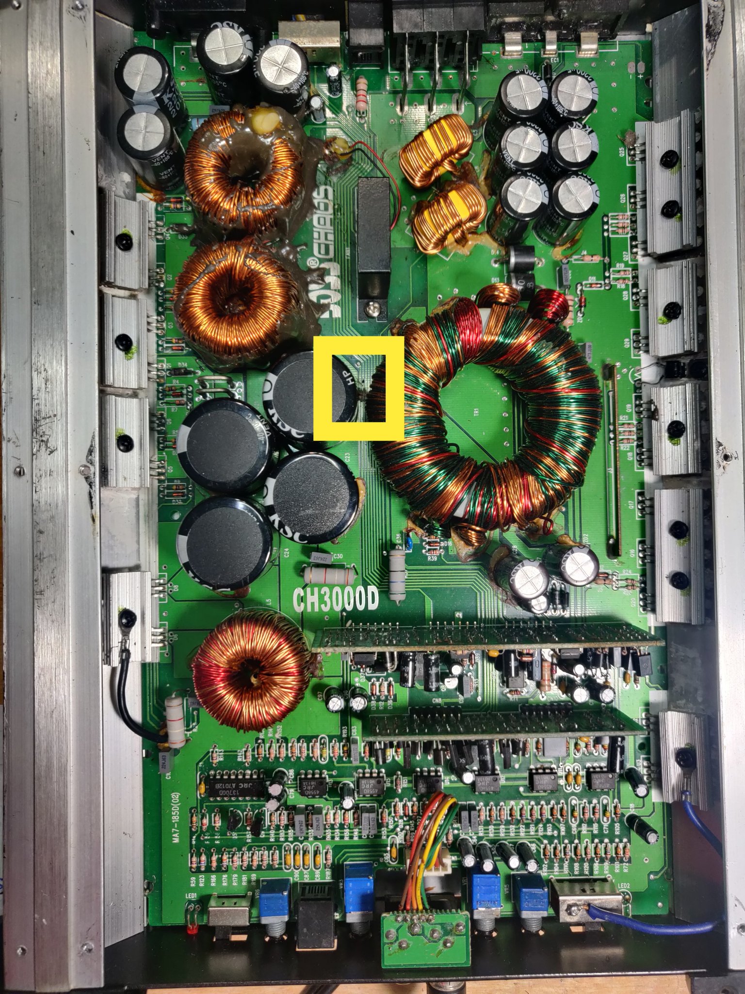

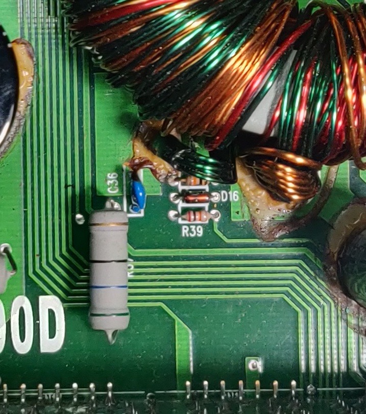

What happened is that I powered the amp up without RCAs connected and then turned off remote power. The green led remained on and after a few seconds it started to flicker a bit and there was an 'arcing' sound coming from the area of the traces running between the rail caps and the transformer, under the 'aged fixative'. I could see visible flashes, and then it stopped and the amp shut off. Afterwards, it would only power up into protection. I removed the fixative from the area expecting to find a burnt/separated trace underneath, but it wasn't.
The only other thing is that pressing on the circuit board in the area of the bass boost knob and that general end of the amplifier would cause the protection light to turn off when it was remaining on after remote power was removed.
That fixative becomes both conductive and corrosive. You need to remove 100% of it (everywhere) before doing any more troubleshooting.
Removed all the fixative from the circuit board and cleaned it off of all the traces, resistor and diode legs that it was on. The amp is currently still powering up into protection.
