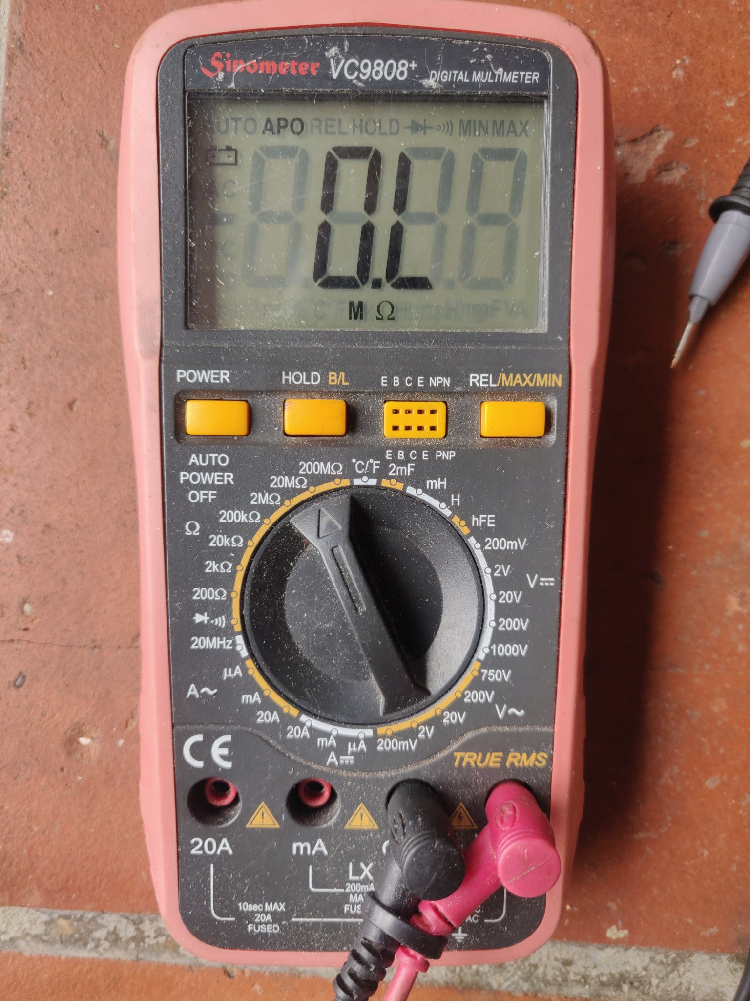

Only working meter I have right now is a Sinometer VC9808+. I have a DSO scope and a OWON VDS1022I scope. The Sinometer scope has one problem that I don't like. In diode/continuity check it doesn't read transistors like most other meters I have used.

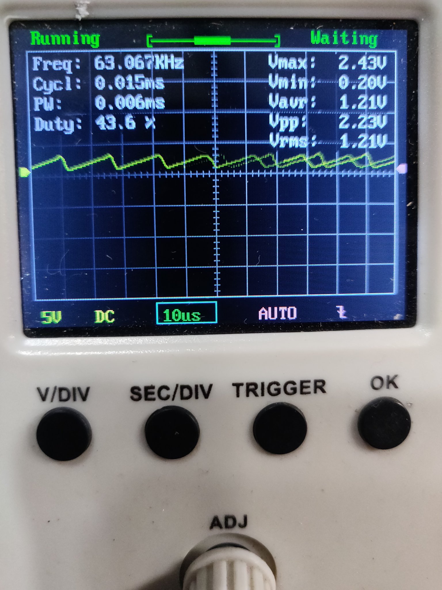

Actually, I realized I didn't take new readings when the jumper was in place, just when in protection. These are the voltages on the 3525 with the amp powered up, remote on and the jumper from pin16 to pin8 in place.
1) 14.8mv
2) 2.3V
3) 30mv
4) 923mv
5) 591mv
6) 1.1V
7) 584mv
8) 2.2V
9) 2.3V
10) 32.1mv
11) 25mv
12) 18mv
13) 11.6V
14) 10.4V
15) 11.6V
16) 2.2V
At this time pin14 had the 10V continuous output. I turned the amp off and back on and the continuous 10V was now coming out of pin11. Each time afterwards, the 10V remained on pin11, and the other voltages remained the same.
