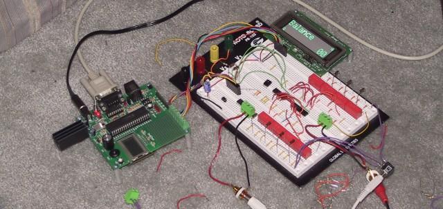

Actually, I am making a pcb for myself for the volume control when it is finished being prototyped. By using 8 relays per channel (balanced signal), it gives you 256 steps of precision. My roommate is actually doing all the work for the project and getting credit for it in school this semester. He also made a pga2310 based volume control earlier this semester, and is finishing up the relay based one now (it is due in 2 days to demo to his professor). Once he wraps it up, my plan was to make a pcb for it with 16 relays, 8 for each channel, a PIC microcontroller and the necessary voltage regulation chips. This should be a good passive preamp. I like that you can really easily change the value of it by swapping out the 8 resistors per channel (or 16 if using it balanced).
Once I get a version finished with a pcb, it might be fun to get a bulk pcb order together and I could program the code on PICs for people. I am slowly learning to use microcontrollers myself, and am taking a class in it next semester.

My roommate finished the first prototype. It has 4 DPDT relays per channel, easily allowing balanced use later. The remote control can be used to change the volume and the balance. It should have 8 relays per channel, but no room on the protoboard. It works quite nicely, and much, much, much cleaner then the pga2310 setup. I like it.
Brian

The board that is use was developed for a class at my school. Here is the teacher's website: http://www.picbook.com I bought the pcb for $10 (the board also is included with the book), and then you can order the parts kit from digikey: 18F452-KIT It costs $56.94 and includes a whole lot of things for development:
The 18F452 has a built in ADC, and there is a DAC on the board, RPG (rotary pulse generator, which is a cheap version of an optical decodes), pot, temperature sensor and easy outputs to tie to external devices serially, such as vfds and stuff. He also gives a good deal of sample code. If you buy his book (links on the above website, you can find it for a little over $50:
http://www.addall.com/New/submitNew...pe=ISBN&location=10000&state=AK&dispCurr=USD
For a little over $100, you can have a good reference book, and a great development board. For the board for easy development, it uses a program called Quikbug that gets programmed to the pic, then it allows you to connect over a serial connection with terminal software, then you can drag and drop files to upload, set breakpoints, step by step through your code, and debug. Pretty soon, they will have an editor written for this board that will allow you to upload your code to the board with the click of one button. It is the focus of a class at Georgia Tech. I am taking the class next semester, and my roommate took it last semester, and this semester worked with the professor, and made the volume control for his final project.

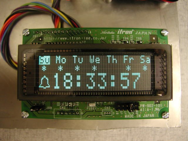

As for the VFD, I bought it directly from Noritake:
http://www.noritake-elec.com/7000.htm
It is absolutely beautiful. It was expensive: just under $100 shipped. It is 140x32 pixels, and the part number is: GU140x32F-7002
Here is another shot of the vfd from my roommates other semester project:

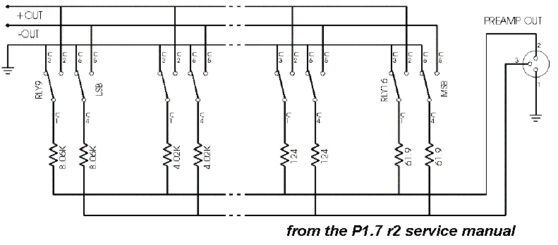

question:
If I was to finish the pcb for this, and make a 2 channel volume control for 2 balanced channels with 8 relays per channel, remote control use, ability to set balance, option for display, rpg for also changing volume, would anyone be interested in a group order of these? To get pcbs made, I need to get some group interest to get the price lower. I calculated that if we can get a total of 30 boards made, I could have all of the parts for the boards, and even assemble and test them for about $100 per two channel setup. Would anyone be interested in this? I thought first about just supplying the boards, but relays are much cheaper in quantity, and so are the microcontrollers. Also, it would be good for me to personally test each one before shipping it out. All that would need to be done by the person who gets the boards would be to pick the resistors (16 for unbalanced and 32 for balanced, 8 per channel). This would give 256 steps of precision for the volume.
If there is enough interest, I will get a group order together, and do this. I figure that for $100 per board with all parts included, it can be quite robust. Even a cheap lcd display could be included with this, with the option to plug in a vfd like mine. If a lot of interest is generated with this, the price could go down a whole bunch, due to cheaper vfds, cheaper microcontrollers, relays, etc.
I will make a more detailed thread about this, after the pcb design is worked out for myself. If there isn't enough interest, I will just get a couple of boards made for myself here at school.
Brian

If I put together a pcb and package a kit, it will be quite easy. I could sell it either unassembled or assembled for a bit more. The volume control is totally passive, the signal going just through the 8 resistors and the 8 relays.
My roommate and I are designing this to be a robust remote controlled passive volume control. It is basically a project that we will both be using for our amplifiers, and he has quite a high level of knowledge with the microcontroller stuff now.
My roommate is planning on making a universal learning remote receiver unit for it, so that any remote control will work for it also.
I am hoping to have a fully done prototype on a pcb by the end of january, planning on finishing the pcb design over the break.
