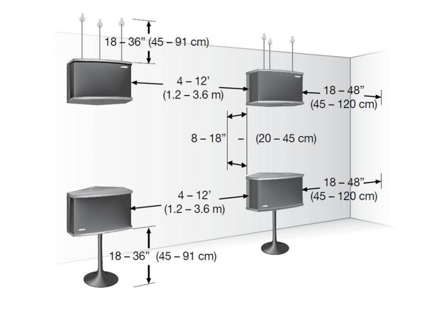

I know this is an old thread, but I was just noticing the placement of Art64's 901s and was wondering if you were using the bose equalizer with them too?
Without proper placement and the EQ, you will not get the proper sound or bass from these speakers. They are also power hungry speakers so having an amplifier of 300-500wpc will really make them sing. By looking at your placement, I can see that they are too close to the corner / wall, and the ceiling, and facing the wrong direction. The angled side of the speaker should be facing the wall.
And I know that using them without the EQ you will have minimal to no bass.
I originally had mine set up similar to yours until someone told me about how crucial it is with these speakers to set them up properly. After setting them up the right way, it was a dramatic difference in the sound! It was so much better sounding I couldnt believe my ears!
