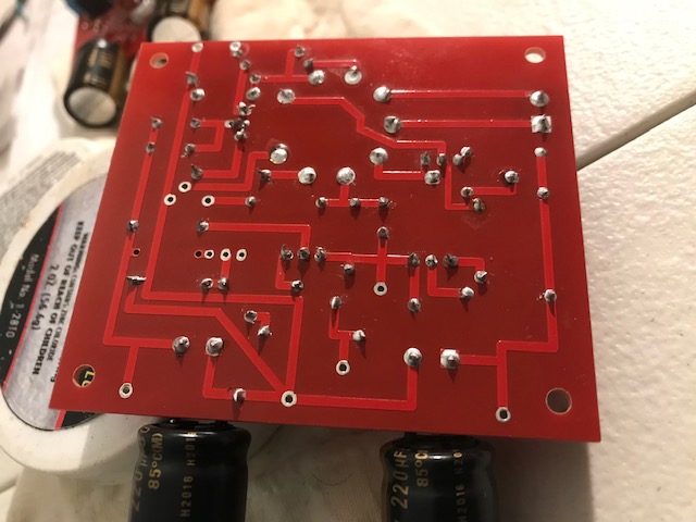

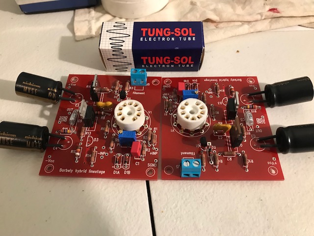

Slow, very slow. I am just a beginner and had no idea how to cross older NLA parts to newer obtainable parts which forced me to order questionable parts from China sellers on ebay. That turned out bad. Waited over two months for parts which never arrived, nor would the seller, miantaxia-o, refund my money. 😡 So I ditched building the power supply and settled on a bel HAA24-0.6-AG +/-24v linear power supply for the board and a MeanWell 24v smps w/TSRN 1-2465A 6.5v voltage reg. for the tube heater. Hopefully this works out.
Here's the board. Ordered mini pc tube sockets instead of regular ones and spread the legs out to reach the solder pads, which of course caused the tube pin sockets to become misaligned. No manner of wiggling and pushing could get a tube to seat. A pair of regular sockets came in today along with more 12au7 and socket savers. Time to desolder/solder the sockets in.
Good thing my soldering skills are improving.

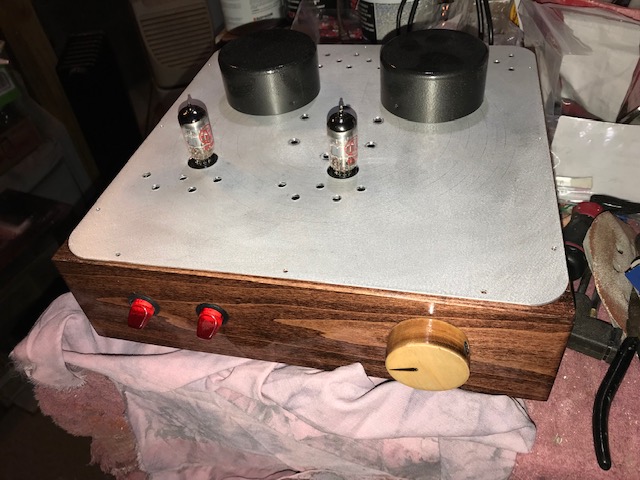

This will go in a wooden box. The bottom and sides are roughed in but not sure where to place the switch/input/output/vol pot. Top would be less work.

It sounds like you had a bad start, and the socket thing sounds like a bad decision.
You can easily obtain both PCB mount noval sockets and chassis mount sockets in all countries, but you of course have to find the right sources.
I can not load the pictures, but it sounds like an interesting projects. Let us hear your opinion how it sounds, when get there.
Waiting for the stain to dry on the box so it can be cleared. Poplar sides stained with red mahogany, volume knob from 1.5" pine stained golden pecan, and brushed flat plate aluminum for the top. To make for better visual appeal, will probably mount a couple empty transformers covers on the top plate behind the tubes.

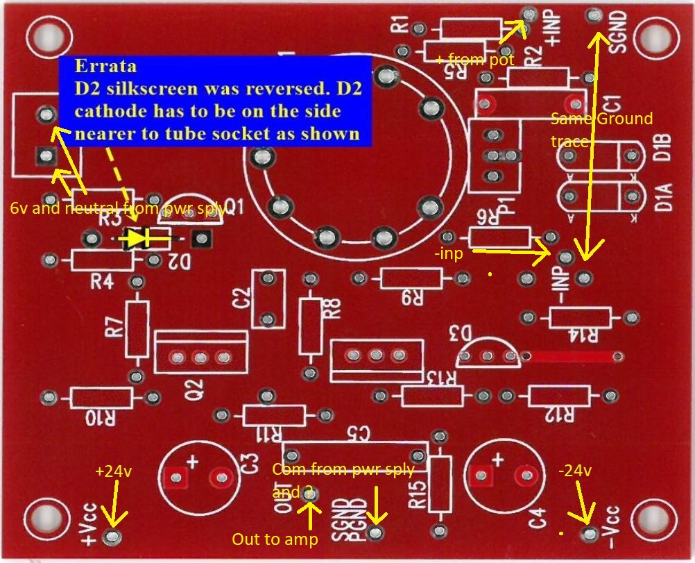

Am I in the ballpark with the connections for 12au7?
+/- vcc _ +/- 24 volt input and com from board power supply.
Out to amp _ +audio to amp. Use this plus SGND/PGND for audio outputs to amp?
6v and neutral from heater supply _ looking at the schem I assume the board is configured to allow 12v series or 6 volt parallel hookup of the heaters (or is this used differently for the 6gm8?). Using 6v, and 12au7, both of these inputs will be +6v and since pin9 is center tap, the neutral side of the heater power supply is the hole marked -inp. Not sure of this but the trace does fall back to pin9.
+inp _ +audio input to board from potentiometer.
SGND _ ground or shield from potentiometer. Bring input shield wire from potentiometer to this point?
Trace from SGND also runs to pin just below -inp, does this pin also need to go to ground or is this asking for ground loops if also running this point to ground?
Pin just above -inp lettering goes to R9 with ties in with pin7 (grid) and R8/C2 (what doe this filter do?). What is this pin for? What does it connect to, or should it?

Just had one of those duh moments. Time to regroup.
From Jims Audio add copy; The input tube can be the popular ECC86/6GM8 or E88CC.
Nothing there about using a 12au7 but it does say; The input can be configured as either balanced input, or unbalanced input.
How do I go about configuring it for unbalanced input?
In+ and in- are the balanced input, simply connect in- to SGND for single input

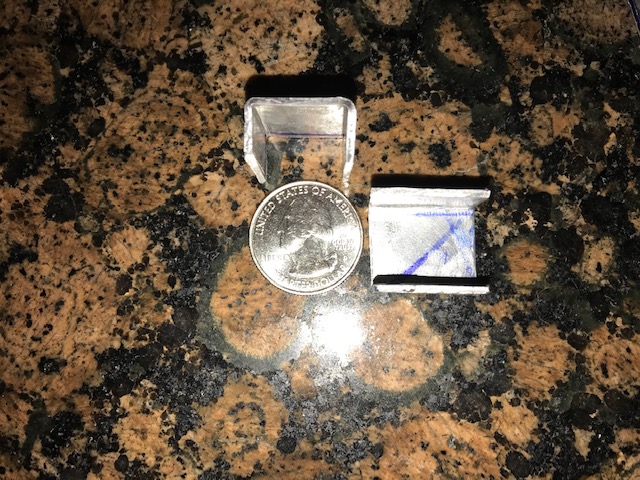

The two TO220 mosfet will probably need some heatsink...

It has two switches, one for heater supply and the other for board supply. With tube gear, it's become a habit of letting it warm before powering up the amps. I'll have to learn how to add a mute relay but an output cap is doable immediately.
I'm guessing no larger than 2.2uf for the output cap?
Since the tubes will be protruding through the top aluminum plate, the room for heatsinks is rather small. Should this be enough heatsinking? I can add to their length but not height.
