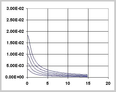

Hi
I just tried, IDS/VDS has a finite, non-zero, limit if VDS tends to zero as you can see in the attached pic.
Regarding the square law the problem
can be faced by using the variant from
Koren.
regards
Federico

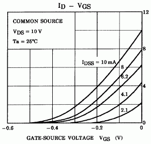

pjacobi said:
Compare formulas 3-11 and 3-12 in Massobrio/Antognetti. And the datasheet curves.
Peter, sorry, I do not have that book so can not know what you are referring to. Curve matches to the datasheet (below) very well, that is why I posted it. Many models are doing here just fine.

Regarding the analysis of the ID versus VGS curves, I think
(my opinion) that it is not a good way to judge
a model. The ID vs. VDS curves are
a better one.
Federico

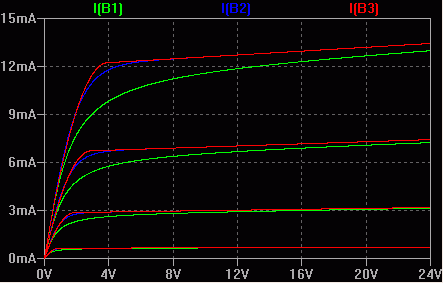

Hi Federico, Pedja, Christer, Lurkers,
Had some day work to do, so that I can't fully address all topics raised so far. So only some short comments:
*** a) Pentode model adapted for JFETs ***
If this is the homegrown JFET model contest, where shall we send the entries to, and what's the price?
For a direct comparison of the SPICE level 1 model, and two alternatives which smoothly interpolate, look at this deck:
* JFET models
V1 D 0 0
V2 G 0 0
B1 0 D I=12m*2/pi*atan(pi/4*V(D,0)/(V(G,0)/3.9+1.0))*(V(G,0)/3.9+1.0)**2*(V(D,0)+200)/200
B2 0 D I=12m*tanh(0.5*V(D,0)/(V(G,0)/3.9+1.0))*(V(G,0)/3.9+1.0)**2*(V(D,0)+200)/200
B3 0 D I=12m*(V(D,0)+200)/200*if(V(D,0)<V(G,0)+3.9,V(D,0)/3.9*(2*(V(G,0)/3.9+1)-V(D,0)/3.9),(V(G,0)/3.9+1.0)**2)
.dc V1 0 24 10m V2 0 -3 -1
.end
B1 is SPICE level1, B3 is much like the pentode, B2 is another interpolation nearer to B1. All matched to coincede for VDS=>0 and VDS=>inf.
This is for a JFET with VGSoff=3.9V, IDSS=12mA and pseudo-Early voltage of 200V (some similarity with BF556B).
.end
B3 is SPICE level1,
B1 is much like the pentode,
B2 is another interpolation nearer to B3.

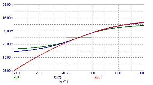

pjacobi said:
So, the 'crude' Spice Level 1 model (in B3) is right, and the more elegant looking atan or tanh functions are wrong in this aspect. You can (bareley) see it by plotting for VDS=-0.3..0.3V
Some JFET datasheets have a good plot of the low VDS region, where you see this too. In the moment, I'm totally messed up with datasheets flying around, so I can give you concrete references only later.
Peter, are you sure about this? If you know any datasheet that shows the curve for negative Vds it will be really a great reference now.
For those who won’t plot that, attached graph shows what Peter is talking about, so if anyone has any idea… As far as I can remember drain and source of JFETs are mostly interchangeable, so what is right and what is wrong here?
With the help of the LTSpice mailing list (which mostly, and correctly, said 'read the fine online help'), I got my LTSpice experiments less messy. Nevertheless it looks like the wrong tool.
I am not sure, what is a problem with it?
Pedja
I don't know a datasheet which shows the negative Vds region, but for symmetric JFETs, e.g. the Fairchild 2N5484 series, you can always relabel S<->D, to get the values for negative Vds, using the formula above.
A datasheet, where with the help of a ruler, you can see that d²Id/dVds² stays rather constant when Vds => 0, is Vishay J/SST111 series.
But of course, unless you are really using a JFET with current flowing both ways, the numerical deviation is rather small. Just perfectionism (a.k.a. not-picking) at work.

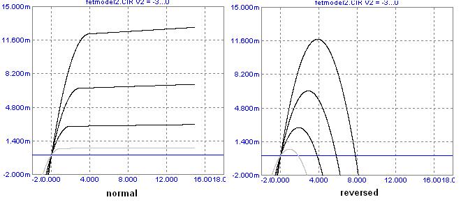

Hi Peter, All
IDS (VGS, VDS) = -IDS (VGS - VDS, -VDS)
I agree with this relation but I use to put it in a more manageable ( for me) manner that is
IDS (VGS, VGD) = -IDS (VGD, VGS)
In other words, we have to solve the functional equation
F(x,y)=- F(y,x)
Referring to model B3, I note that if I turn over (top-down) the device I do not obtain similar curves. ( I plot current by using
a little (1u) res. on the top of the device to avoid sign proiblem)
federico
jcx said:
And fig 2 in this nice paper shows the non-vanisching second derivative at the origin very clearly.
F(x,y)=- F(y,x)
I agree. Putting it this way, it's much easier to visualize, what the fuction should look like.
This looks fine already for the non-saturated region. Should be tweakable for a solution in the complete plane.
