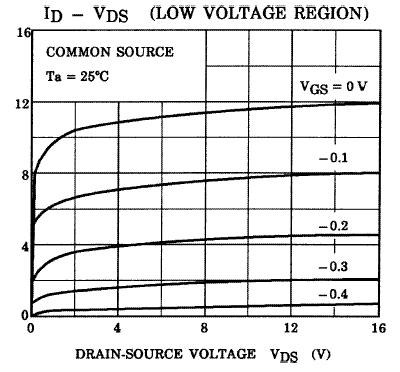

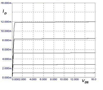

Hi
Thanks Peter for the search
However I think that static curves of
ID versus VDS are more important in
distortion analysis. look at the difference
between M-Cap and the Toshiba sheets
Amazing
Federico
Toshiba curves
Hi Federico, All,
JFETs, the neglected stepchild of SPICE modeling?
Perhaps some advanced MESFET models can be abused for better results, when it is possible to selectively disable the GaAs specific effects.
Anyway, careless parameter extraction is to blame for the huge differences seen in your posts.

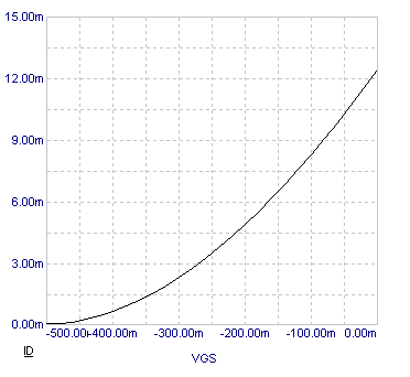

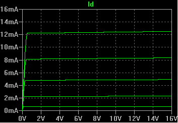

Hi Pedja, All,
Pedja said:
It is the model. SwCAD shows the similar curves.
Three graphs, three problems.
a) IGSX / VDS => SPICE version problem, only some SPICEs model the impact ionization current at all.
b) ID / VDS => Sloppy models, compare the BF245 models.
c) ID / VGS => Bad theory, this looks too good, as it looks rather quadratic. Despite endless repititions this ain't right. Compare formulas 3-11 and 3-12 in Massobrio/Antognetti. And the datasheet curves.
Peter Jacobi

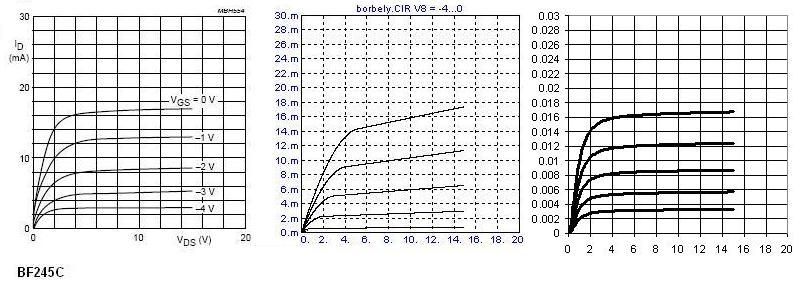

Compare these Philips models with the datasheets:
I did it.
Look at the following 3 sets of curves referring to BF245C
1) from philips
2) from Micro-Cap
3) drawn using a pentode model with parameter fitting
made manually in five (5) minutes
Yes, it is not perfect, but with more time I am sure to
obtain near perfect curves.
I think spice model developers
have to work more and better.
Any comment ?
Federico
Hi Federico,
Very impressive comparison!
Will you make this available? Which pentode model are you using?
IMHO there is a problem with the monolithic architecture of SPICE. Either you have to recompile the whole mess to add a new model or you are confined to what's possible with subcircuit models.
If it would be possible to add experimental models as seperately compiled modules (DLLs) or if a reasonable fully featured programming language interpreter would be included (Javascript, Python, whatever), it would be much easier to tinker around and try things and share improved models.
The ngSpice project had this on its agenda, but it seems to be abonded: http://geda.seul.org/tools/ngspice/
