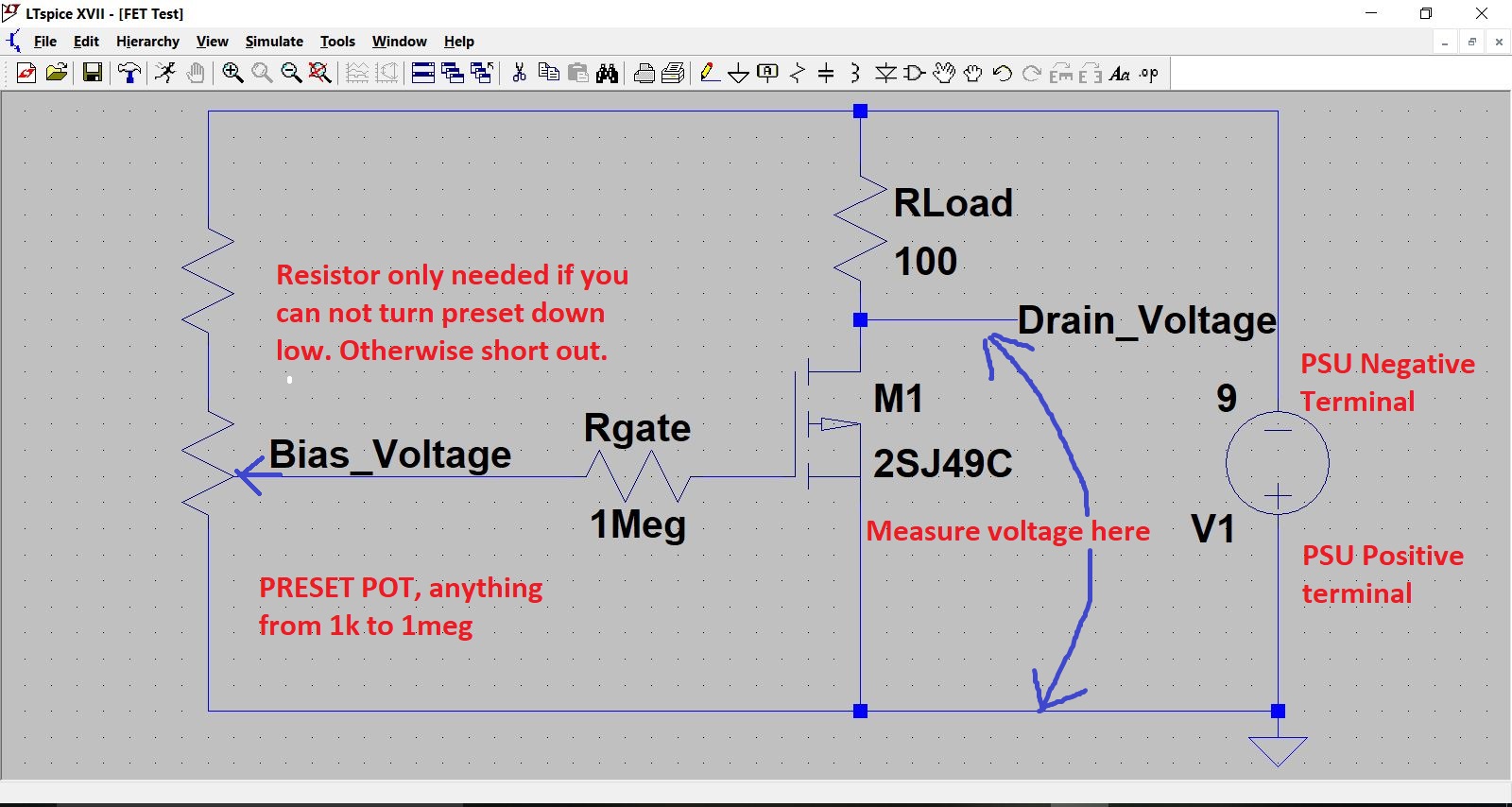

I finally found some time to do this. Here are the results. Seems the K135's are ok, right?
It would seem so. You had the meg (or something similarly high) in place ?
So you need to test the 2SJ's now.
Its exactly the same method except this time you reverse all the supplies (which you can't do with your 6 volt output... see below).
If you look at post #88 last image you will see how it works. Just connect the FET test circuit to the power supply but with opposite polarity. Your meter + lead now goes to the plus terminal of the power supply, and all voltages you measure will be minus with respect that point. So far so good.
Your gate voltage will have to come from a preset that you place across the now -9 volt rail. Adjusting the preset would give a 0 to minus 9 variable gate voltage. You still retain the 1 meg from preset wiper to gate.
That doesn't read quite correct. The voltages you measure with the meter will still show as positive on the meter if you connect the red rather than black lead to the PSU plus terminal.
Flipping the supply polarity effectively makes the circuit positive earth.

Like this. The only thing that has changed is the polarity of the supply. The preset gives you a variable gate voltage. We can't use the +6 terminal as before because that is now of the wrong polarity relative to what we want.
I don't need the 100K resistor and preset pot if I just raise the negative bias voltage from zero to -1V directly at the power supply, right?
So right now I have the following connections:
-18V to 1 meg to Gate. Starting at 0V.
+18V to 100 ohm resistor to Drain.
COM to Source and meter negative.
Not exactly 🙂
The Source has to go to the PSU positive terminal.
The Drain and its 100 ohm go the negative terminal. You also now measure ALL voltages from the positive terminal which becomes our reference point. That means you will see a variable negative voltage on the Drain as you alter your supply. So as before, we set it to around 9 volts.
The gate voltage has to be variable with respect to that positive terminal.
Another way to do it would be to use a fixed 9 volt battery for the main power supply. Battery plus to Source, battery negative to drain.
You could now connect the plus output of the power supply to the battery plus and the negative of the power supply via the 1meg to the gate. That should give you a variable gate voltage. Again all voltages are measured from the battery plus terminal.
If you do that then only connect the battery once the gate has been wired up. Leaving the gate floating (on a good fet) will almsot certainly turn the fet on and with a tiny 9 volt battery and 100 ohm load it will soon pull the voltage down.

If we are down to replacing FET's then I would definitely begin by removing all four from the channel being worked on and then begin replacement with a single pair only and make sure that works as expected and that it biases up correctly. When that is proved good, fit the second pair.
Also before fitting the replacements, be sure to set the bias voltage (voltage across the 150 ohm) to minimum.
This also seems a good time to get rid of those sockets and mount the FET's conventionally.
The originals are obsolete these days but alternatives exist. These are listed as replacements for the old 2SK/2SJ devices.
ECF10N20 - Metal Lateral MOSFET
ECF10P20 - Metal Lateral MOSFET

For presetting the bias voltage to minimum, I have P2 (a Bourns 3352) set to its max of 1k ohm, as measured between the wiper and leg 3. What voltage should I be aiming for across the 0.22 ohm resistors after power up? 22mV?
I can barely read the schematic, you want the bias pot at zero resistance (shorted) this will saturate the bias transistor, you want minimum voltage across the gates to start. 22mv would be correct.

A DBT is a very good idea. You may need to reduce the bias on the good channel though to minimise mains current draw.
Preset as minimum as mentioned above. Doing that places the fixed resistor (R36) between C and B turning the transistor on.
The sockets I'm afraid I can't advise on as they are something I would have to see first hand. However they work, make sure the basics are correct and that the transistor is electrically isolated correctly, that it is in good thermal contact with the heatsink and that the gate and drain wiring is the correct way around.
22mv across each 0.22 ohm gives 100ma per FET pair. If all seems OK then turn the bias back down to zero and readjust again correctly when on full mains voltage (no bulb).
