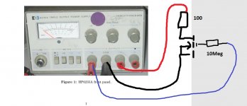

I just picked up a used HP 6235A power supply on the cheap. So taking the battery out of the equation, I don't need the resistors to regulate the voltage. Perhaps a dumb question, but do I still want the 10 meg between the voltage and the gate?
And wiring this up, I'll have the common from the power supply running to the FET source (case), the +6V going to the gate, and my meter on the drain. Would my meter common go to the ground terminal on the back of the power supply?

That looks an intriguing little power supply. Based on what I see...
The 'com' terminal is your zero volts or 'ground'. Your meter negative lead connects to this point.
The +18v terminal looks like it is adjustable between 0 and +18 volts. Check that it is.
Assuming the above is correct then just set the '+18' output to some convenient value... we suggested 9 volts.
The gate needs to be connected to a variable voltage in order to properly test the FET. That's what all the resistors do. Yes, you need the 10 meg (or something high, even 1meg would do) and you need the other two resistors to set the gate voltage.
So for the 2SK FET's the COM terminal goes to the Source.
The Drain has the series 100 ohm resistor which returns to the +18 terminal.
The gate has the high value resistor tagged to it, the other end of which needs a variable voltage to test the FET more comprehensively.
You can try a brute force test though. If you connect the 10meg to the Source (which is the COM terminal) then the voltage on the Drain should equal your supply voltage. That is because no current at all should be flowing in the 100 ohm.
If you now connect the 10 meg to the +6 volt terminal (check that there really is 6 volts present) then the Drain voltage should fall to a very low value, almost zero.
The above will only work for the 2SK devices, the 2SJ ones need a negative voltage (the -18 terminal) but would also need a negative 6 volt... but we can arrange that easily if needed.
Just check the 2SK's for now.

Just to add to the above... if the 6 volt output is adjustable as well then you have all you need to fully test the 2SK's. Varying the 6 volt output between 0 and just a volt or so should turn the FET fully on. Always keep the 10 meg in place though, never connect any voltage source directly to the gate.

Connect it like this, which does assume that the 6 volt output is variable and that it really does go right down to zero volts.
Your meter goes across the FET. Turn the gate voltage up and the voltage across the FET should fall. By the time you have just half a volt or so applied to the gate, the FET voltage should be nearing zero.

Ok, so the power supply does go from 0 to 6V and 0 to +/-18V.
To recap, I'm using the 6V output for the 2SK's and the +18V for the 2SJ's.
I don't have a 10 meg resistor handy, only a 1 meg and a 20 meg, so I'll go with one of those. One end goes to the Gate, the other to the voltage output from the power supply.
My DMM COM black lead goes to the COM connection on the power supply, not the ground connection on the back of the chassis. The COM comnection from the power supply is connected to the Source. Right?
The 100 ohm goes between the Drain and the +18V output on the power supply, though I'm not sure why.
The red voltage probe from my DMM is going to the Drain. I think. . . .

The 100 ohm is just a load resistor to limit current flow. With the FET off you have the same voltage at each end of the resistor. As the FET conducts it pulls the voltage on the Drain lower.
Think of the FET in the OFF state as having infinite resistance. So you have 100 in series with infinity across 9 volts. What is the voltage across our 'infinity' ? Its 9 volts.
Now bias the FET so it conducts a little. Lets say the FET now appears as a 100 ohm resistor (like the load). What is the voltage across the FET now ? Its 4.5 volts.
With the FET fully on it will approximate to a 1.5 ohm resistor. The voltage across the FET now would be around 60 millivolts.

Look at the earlier posts (Post 88) showing the correct voltages at different PINs of P and N type Mosfets (only the Polarity changes for 18V) What Mooly's diagram is for 2SK (N FET) with +18V ( post 93)
The light bulb finally clicked on. Thanks Mooly and kannan_s. I'll test the 2SK FET's and let you know what I found.
