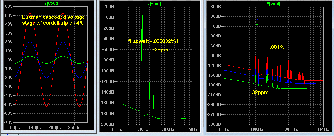

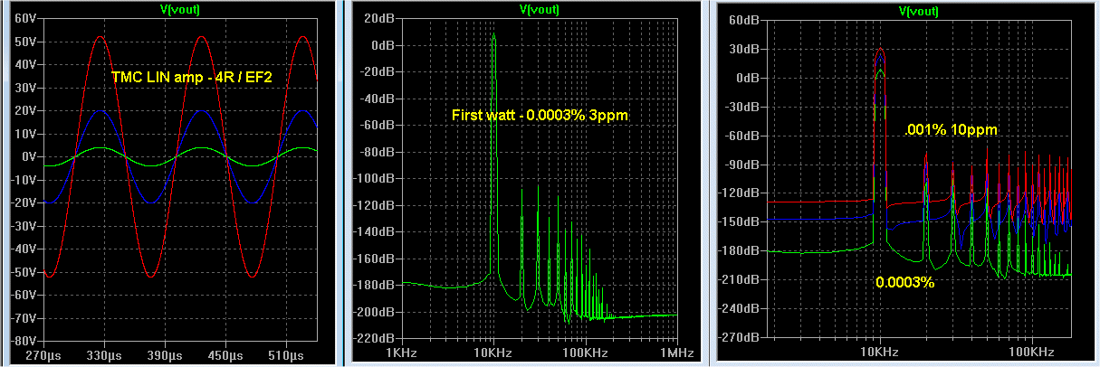

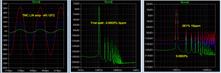

(below 1 ) is the "base" thread topic amp. Not bad - a PPM amp. Besides what a bootstrap does in feeding back EMF in a local loop back to the voltage stage , a bootstrapped amp will only slightly deviate from it's current sourced "cousin" - both will simulate nearly the same and just sound slightly different.
(below 2 ) is the "harmonic killer" 😱 I was surprised at it , even. With just half the loop gain , it blows the lin amp away. So I built one (I actually just needed a subwoofer amp). Hooking it to a full range speaker convinced me it had some real possibilities. Cascodes and the reduction of the early effect DO make for better sound , the simulations (first watt - class A) show the VAS itself is nearly distortionless , even compared to the LIN circuit. In both simulations ,the higher power FFT's just show the contributed Xover distortion differences between a EF2 and 3. The VAS itself, in the cascoded version, still shows much better linearity.
Both simulations were done with Cordell defined models (no OEM supplied ones) , 4R , 3 pair-mjl 1302/4281 op @ 85ma bias.
I did the "no - no" homemodder mentioned 🙁 , and ran a cascoded VAS on a EF2 (for 6 month's). It's sound was good at low levels but quite poor at higher levels. All this fooling around paid off - have you ever tried to modulate the impedance of the cascodes with a bootstrap ? The downside of this route is the ever increasing complexity (more parts)... quite the compromise. 😀
OS
