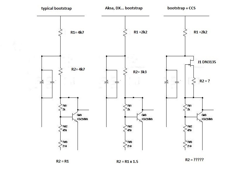

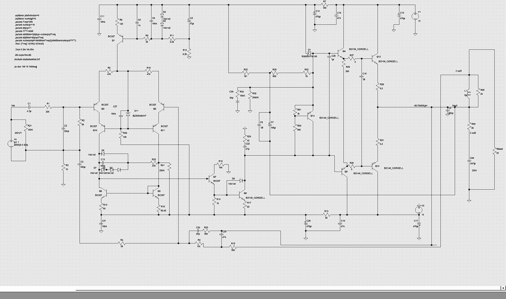

Dadod:
Could you tell me how R2 is calculated?

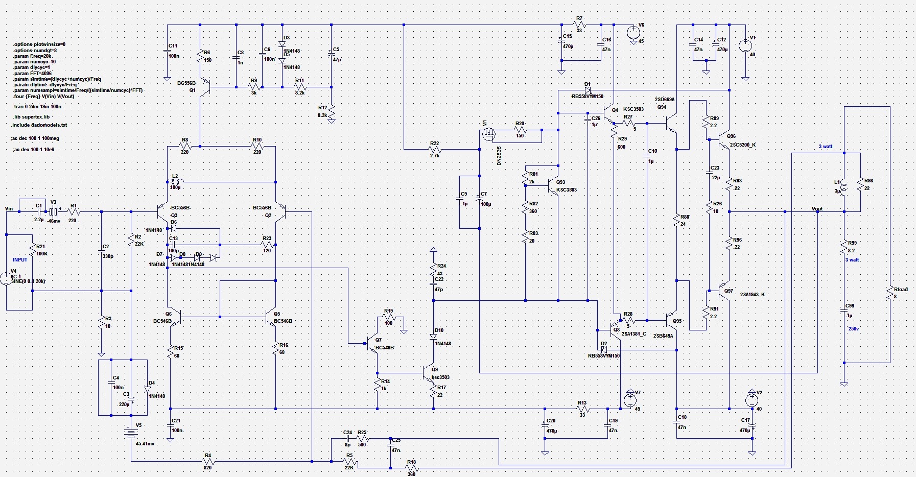

Hi i have downscaled this circuit for +-15v to be used as a headphone amp. Did without the jfet ccs for now. The thing sounds wonderful. However at +-v10 supply i get rail sticking. Offset is at 0.5v and no sound. Tried increasing ccs resistors ect. but no success. I havent learned ltspice yet so im in the dark 🙁
Any tips on how to get it to work at that low v?
All small transistors are bc327 337, output bd139 140. Gain x3
Wow thank you!
I see that youve added some bells and whistles. In order to simply things so that i can p2p on my existing pcb, which components are responsible for making low voltage operation possible? Im thinking R41 R30 and their adjascent components.
Thank you again.
