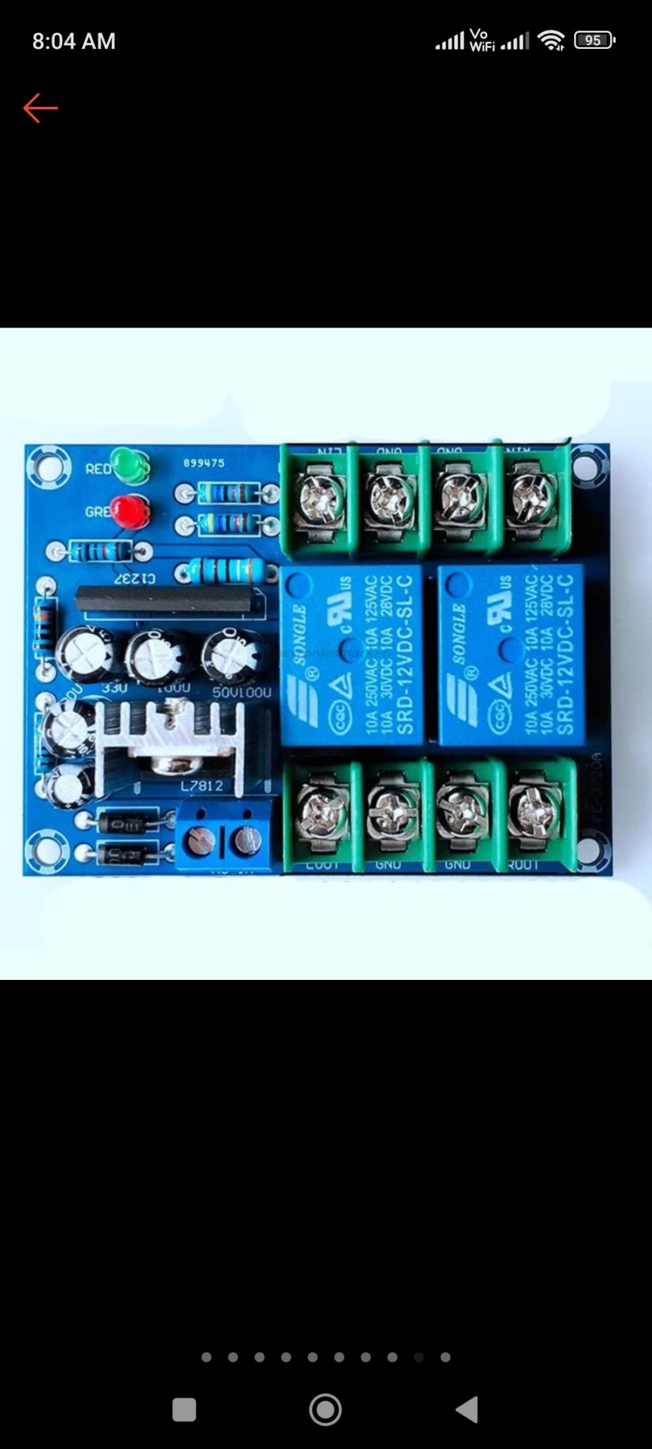

Nico, this is my personal project, a replacement actually from a failed one, and exactly the same reason why I wanted a very low dc offset at least in sim because in the actual build that is not what you can expect to get as per sim. I am actually using a cheap speaker protection.

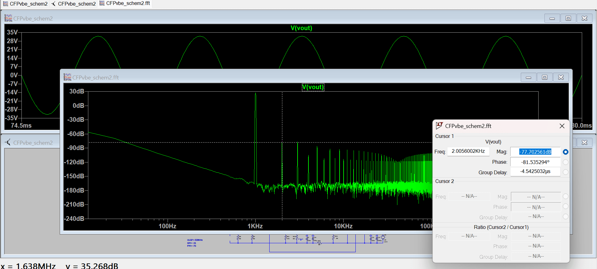

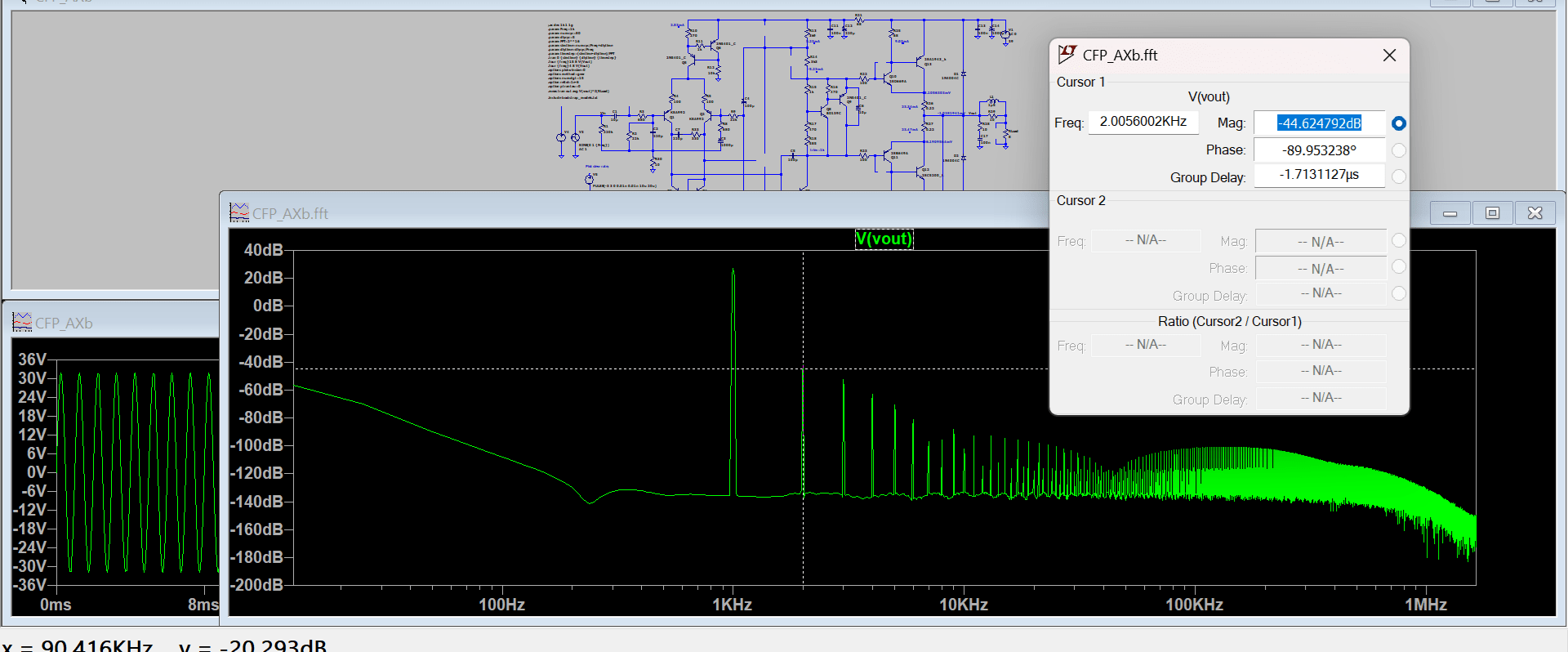

I think we may all agree to loose Q14, I am now presenting you 2 schematic for choosing. Schematic1 was the first and original, schematic 2 contains VAS helper (2nd transistor as propsed by member steveu). Now I am seeing two different patterns, I am showing the results for 1KHz FFt window, because the comparison here can be clearly seen. Both simulated with equal bias current the same input amplitude at the same output power level (63w) with both having 30dB of closed loop gain.
Notice the amount of harmonics on each window preferably the 2nd harmonic. Is there a correlation to loudness in the ouput sound of the amp on the level of harmonics?. Say the one with higher level of harmonics is much louder? While the schematic with the 2nd VAS transistor shows 000% THD but the measured dB is higher. Help me to decide which one would be a 'better one'.
Thank you!

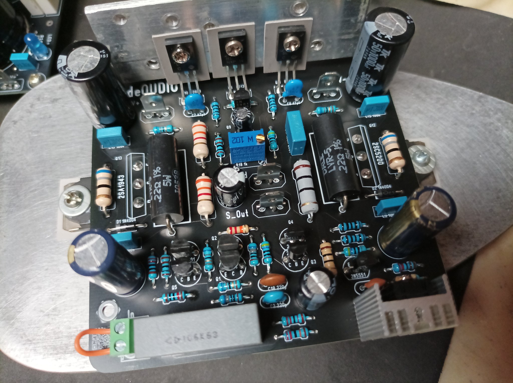

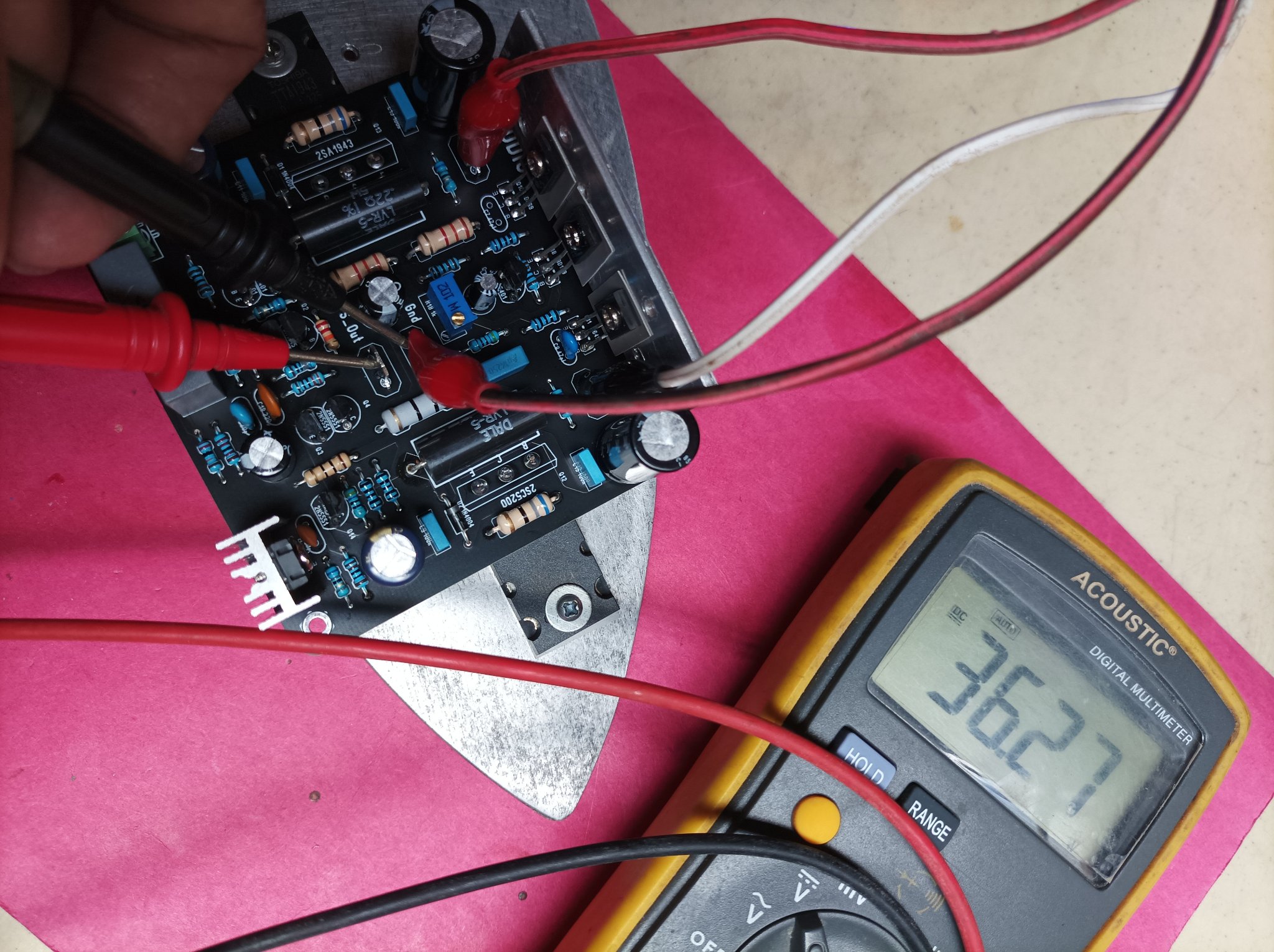

So I built the amp, but it is outputting the rail voltage (+37vdc) I have no idea why, my first encounter on such error. Any ideas where to check for fault?

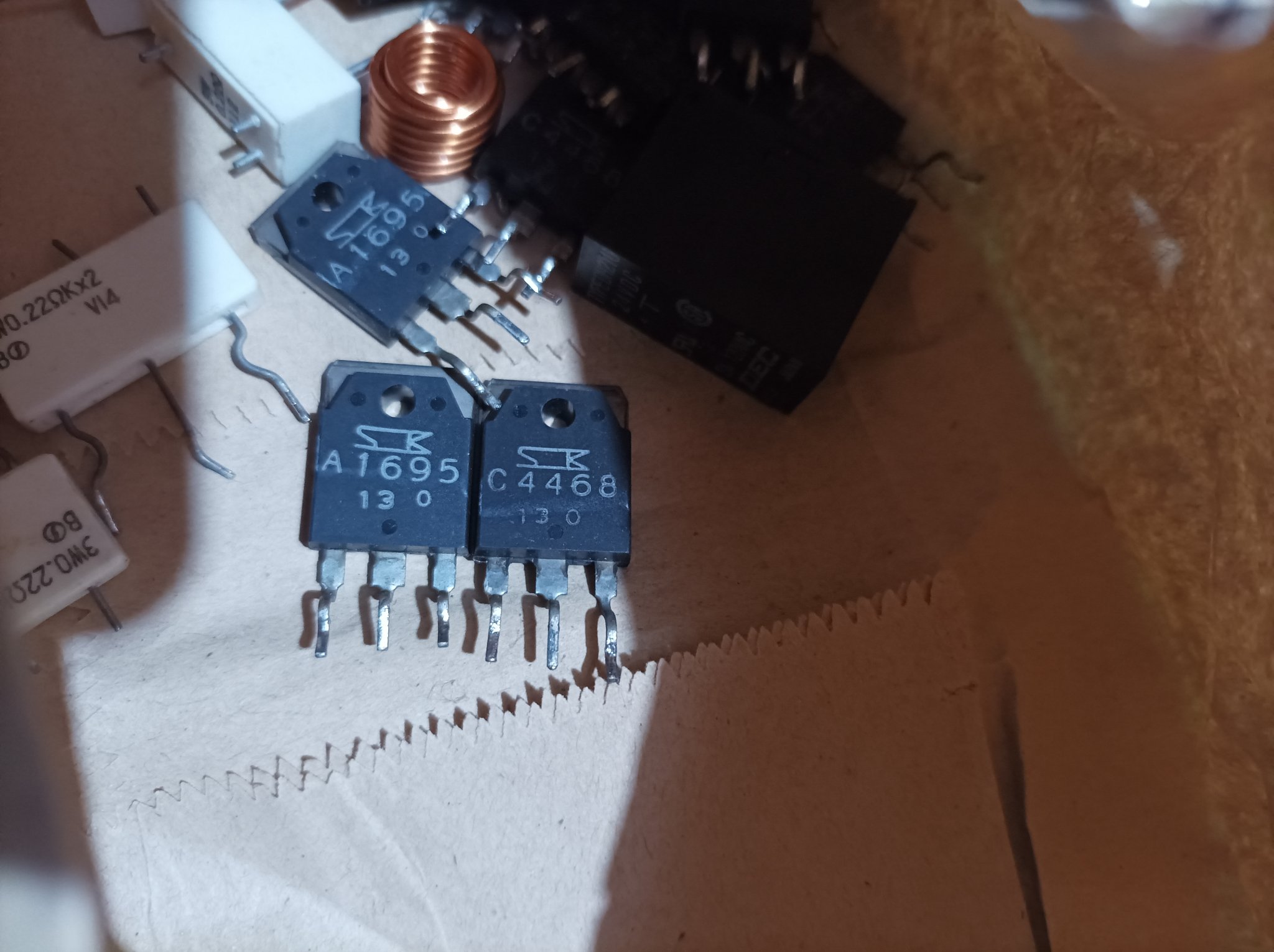

In the schematic I replaced the 2SC5200/SA1943 with Sankens. I happen to have 3 pairs of them (taken from an old amplifier). I am not so sure though if the replacement Sanken output transistors causes the trouble.

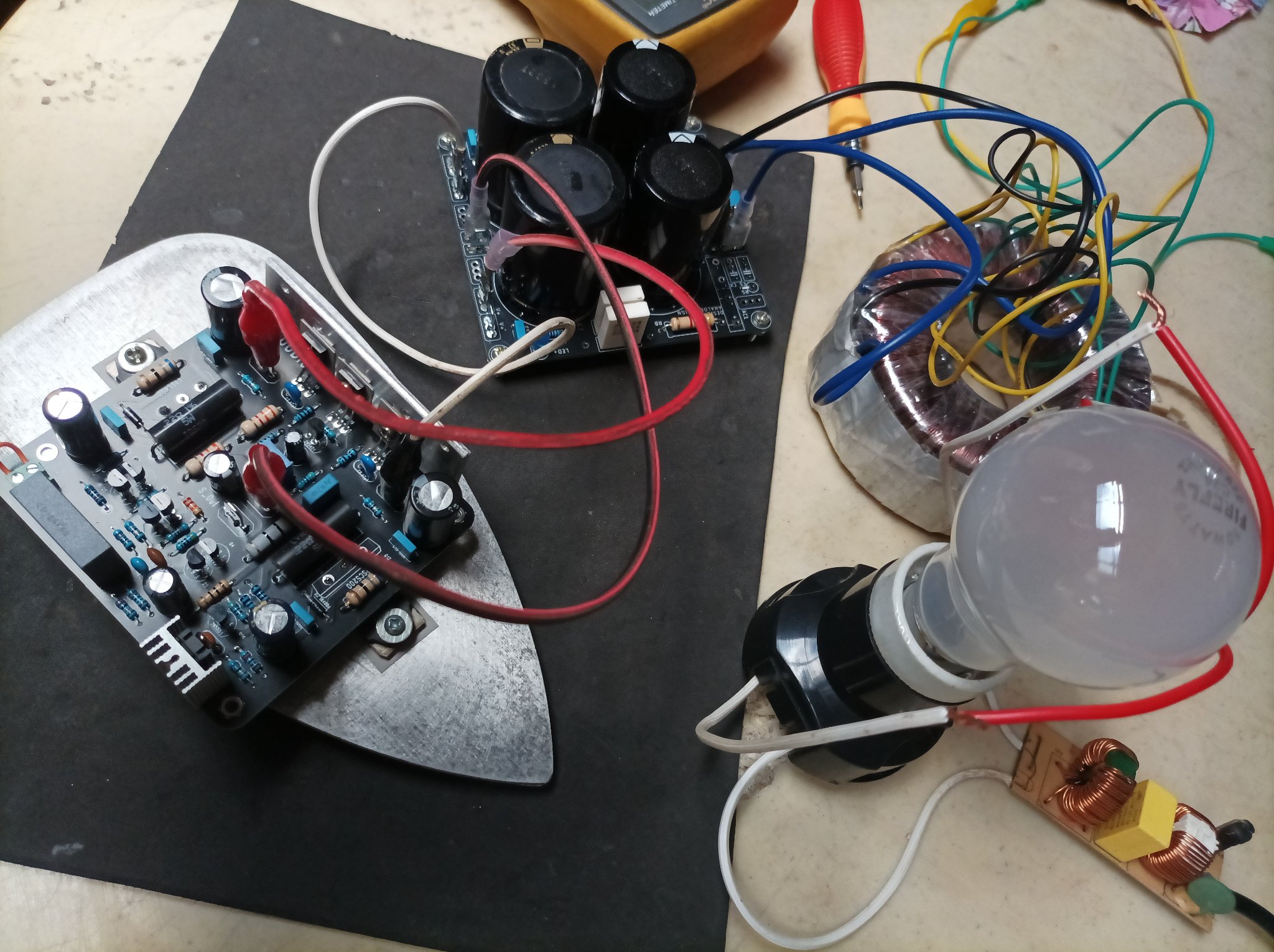

Is it biased in class A? That is why you will use it as a clothes iron? 🤣
Hi Nico,
The Sankens was there the first time I powered on the amp. The flat iron plate looks pretty good for a test hsink for an amp with about 25ma - 50ma bias current, easier to drill holes and is made of pure aluminum. I think member Borys also used flat iron plates on his amp tests.
Sorry for the joke, I have just never seen a clothes iron for heat sink! Are you married, I hope not! Your wife will beat you over the head if she sees what you have done.
I'm 53yrs old, married of course 🙂 wifey won't care about the flat iron plate as long as the flat iron in the house is in place 😁, but she will be delighted if this amp will sing beautifully. She loves music, the type of Bee Gees, we are the opposites as I'm more on the rock/metal stuff, from the likes of Led Zep - Alice in Chains - Dream Theater. I was born in the silicon age 😄 that is why I am passionate about building class AB amps.

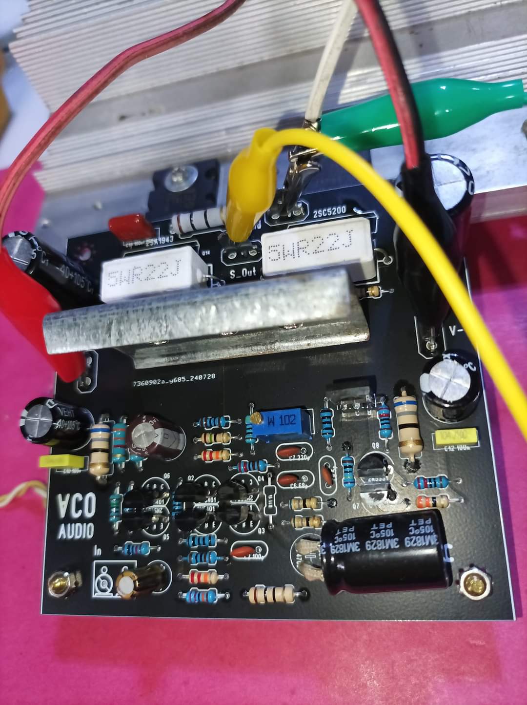

...built the second channel following the original schematic using 2SC5200/SA1943 for the outputs. Surprisingly the same error occured, both channels had identical errors. They both have DC voltages (rail voltage) on the speaker out. Judging from both scenario I suspect that the fault could possibly lie in the circuit design. I'm thinking that if the fault lies in the PCB, chances are the amp will self oscillate and or a shortage may occur, but at power on the lamp bulb will flash momentarily then the brightness slowly goes away. Pretty normal I guess for a PSU with a cap banks of 40,000uf.
I actually made a few component adjustment for my last attempt of testing for the day but at power on, still the same error occurs. This is going to be one tough job and can be really frustrating.

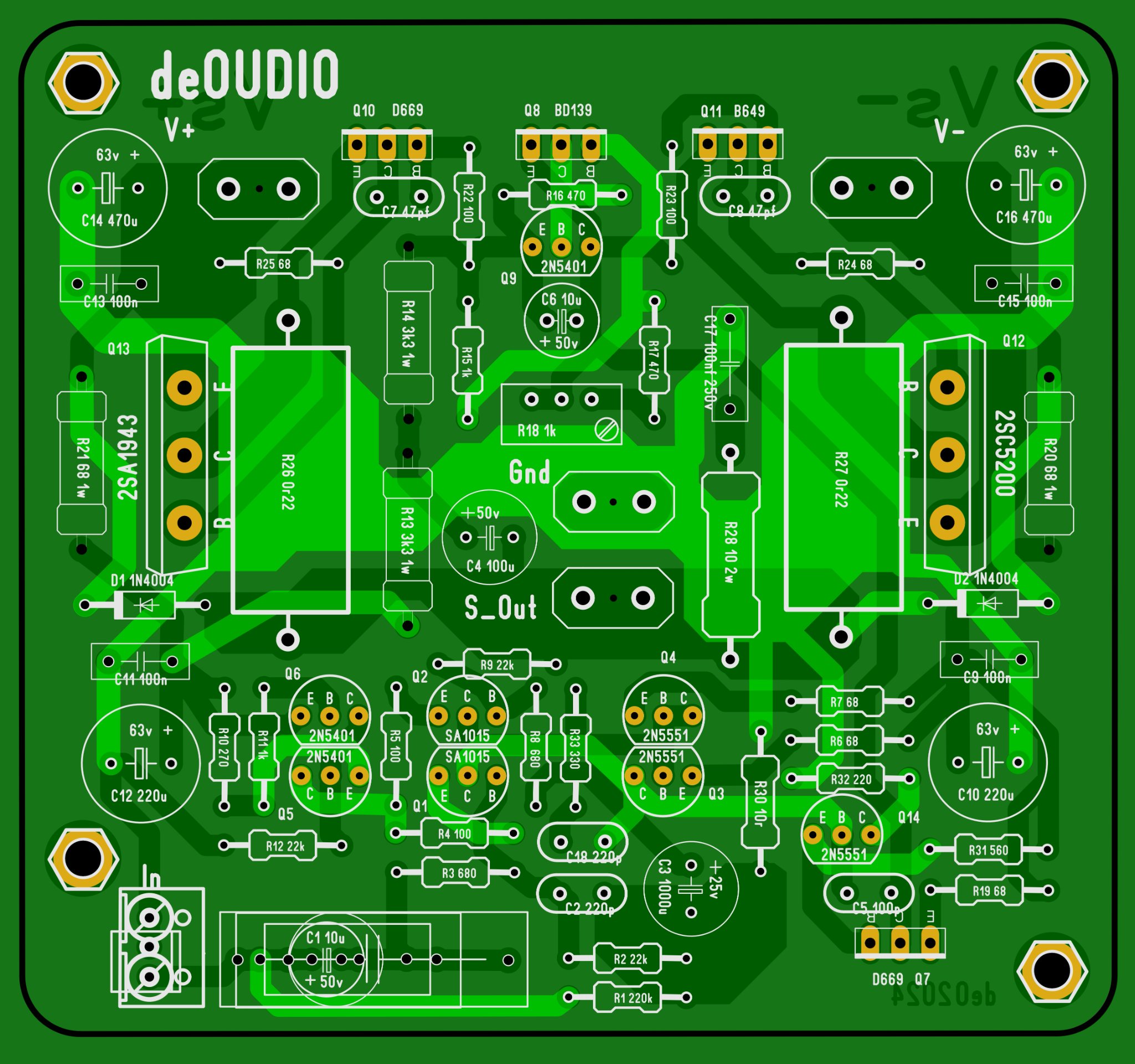

I am attaching the latest schematic with the adjustments that I made and also the PCB photoview for you to check if there are errors made with the routing of tracks.

The amp looks pretty normal and the simulation says that it does work. According to the simulation both output currents are the same so the output voltage is at zero. There is no indication that the schematic is incorrect in a way that you describe. Are you sure that you have not got a transistor wrong way round somewhere. You cannot always believe the silkscreen.
It looks like you are using MicroCAP simulator. Turn on the voltage display and probe you circuit to see if it corresponds to the simulator. Maybe just start with checking the output and driver transistors E/C junction for a short. Did you use the specified components, not that Q1 and Q2 pinout is different that the other transistors, so you cannot put anything in its place.

I'm using LTSpice, all the components that I've used are brand new (well mostly except maybe for the small filter caps on board) but of course most of them are China made. For the transistors I made a quick analog test for their BCE junctions, they look fine to me except maybe one or a few failed while in circuit. I will double check my work again and compare the component placement per the PCB and schematic.

I checked your PCB as well as I could and don't see any mistakes. Can you also check the two protection diodes if there might a short across it. I notice all MC12 sites are down or has other rubbish attached. I have the completer zipped file but is 59MB but cannot attach it here. Maybe DIYaudio could create an archive to dump all the useful software packages into for everyone to access.
