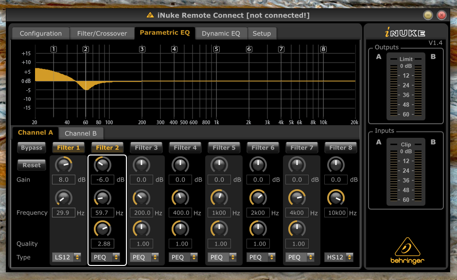

Hi Sintek, sorry I took so long. I think you should try this one out. It's shaping the eq more like a linkwitz transform curve with an 8dB boost down low.
Welter is right about EQ making excursion go bananas but I have a feeling that you'll be alright with your setup. If you Behringer is anything like my PEQ from them, it'll start rolling off around 20Hz pretty steep anyway. Just don't be a volume hog when you first run through some source material that goes loud down low. Make sure it ain't clacking.
See if you can move the 60Hz up or down in freq and increase and decrease the Q of it until you think the slow sweeps by ear sound the least "peaky".

edit: Did you intend to leave the first band filter as LS12? In the drop down box on the bottom, you can choose from PEQ, LS12, LS6, etc.

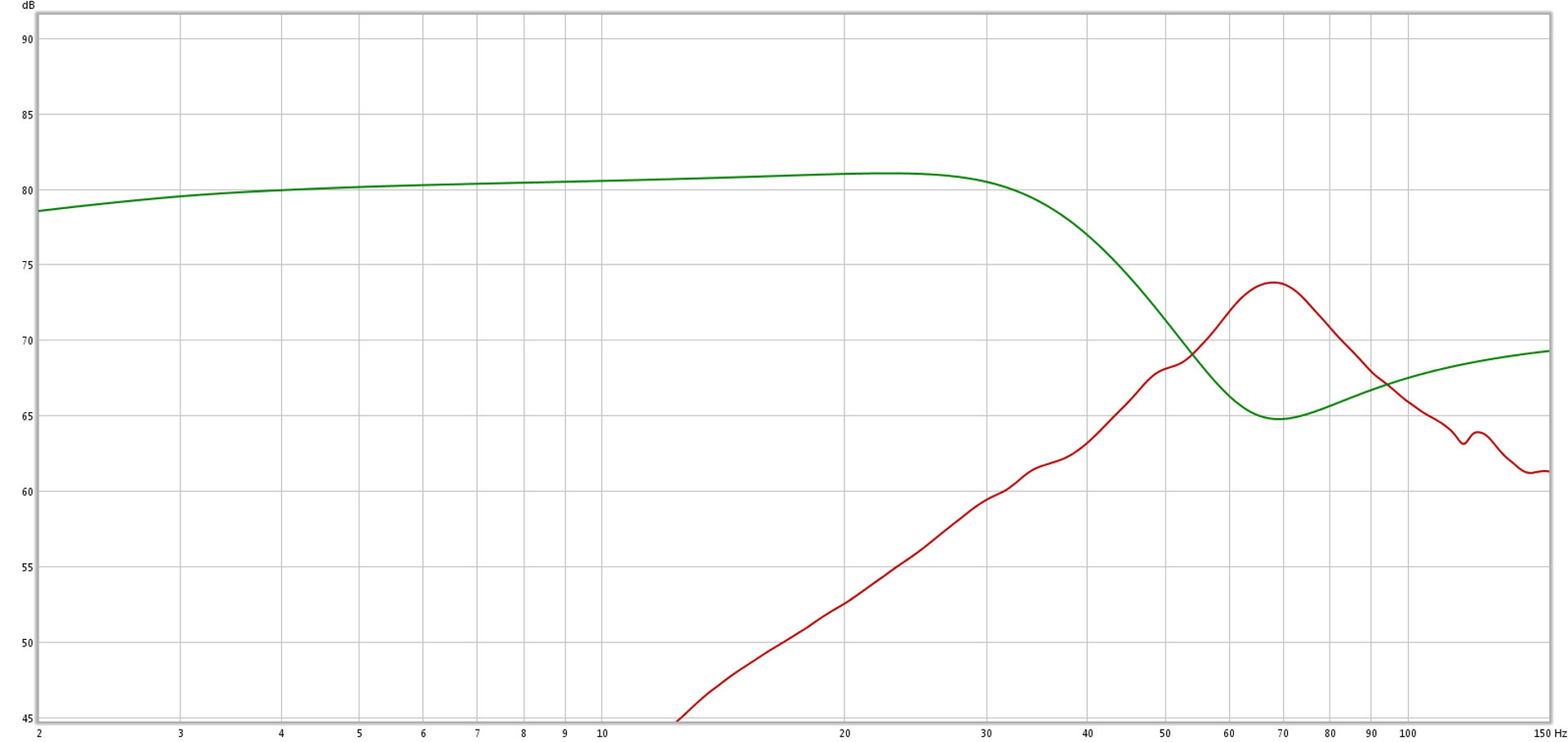

Yeah, I guess that's a low shelf filter 12dB per octave? It was intentional. I like it way better than a PEQ filter because it interferes less with the 60Hz filter at the same time boosting ALL of the stuff where your sub is falling off.

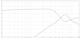

If you look at this pic I attached:
The idea is to give your sub the opposite of it's close mic response in eq. Pull down it's peak and match it's rolloff down low with boost. Ideally the end result is a flatter sub response that stretches lower in frequency. Your room is going to throw a curve ball or two but you can start dealing with that when you get your mic.

I ran a few sweeps. Just a little problem in the 60hz area where there's a null. Watched a few scenes of Olympus Has Fallen; an explosion lit up 3 of the 4 clip LEDs at not that loud of a volume, so I may back down the boost a little.
Excursion looks fine at 25hz, but then its output is still fairly low. I'm thinking about pulling out some of the fill material. It's been some time since I tinkered with the box. I thought I had only put in around 2 pounds, but I can't find the rest of it so I'm thinking I used all or most of it which is closer to 2 3/4 pounds.
