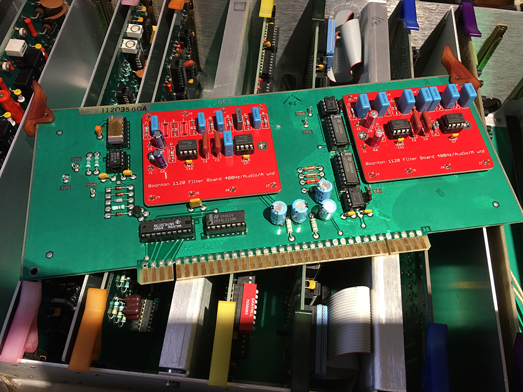

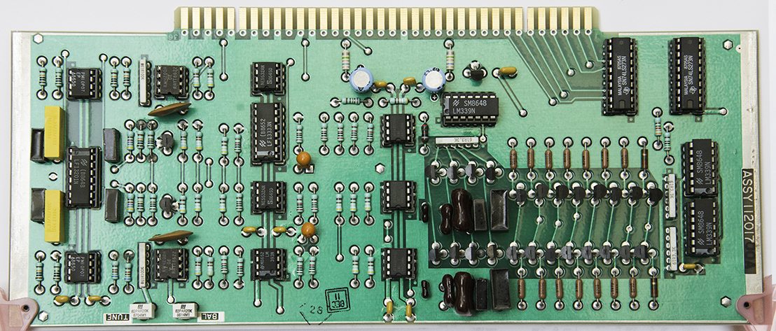

I’ve recently bought a Boonton 1120 and thanks to the excellent work done by Demian and Mike I’ve followed some of the mods you’ve suggested. My notch board is an earlier version I think, 112017, and the resistor values around the tune and balance circuit are slightly different (R42/43 1k, R47/50 47k7, R48/49 100k), so I haven’t done that part yet. Replacing the 5532/4s with 49710/20s has improved lowest distortion measurement from 0.0015% to 0.0008% using Viktors’ oscillator and with the new R42/3 values, the null adjustment is much easier. Does anyone have a schematic for this version?
Using the layout suggested my Demian, I’ve done an Eagle layout and built a 440Hz and audio board, and these are working well (see photo).
I have one problem though: whatever filter I put in the left hand position on the board, the level and distortion measurement read low (level 2v instead of 3v). Both boards work fine in the right hand position. I’ve entered the special codes from the manual to show which board is in which position, but I’m wondering of the codes are different on my model, or I’m doing something wrong. Any Suggestions?
