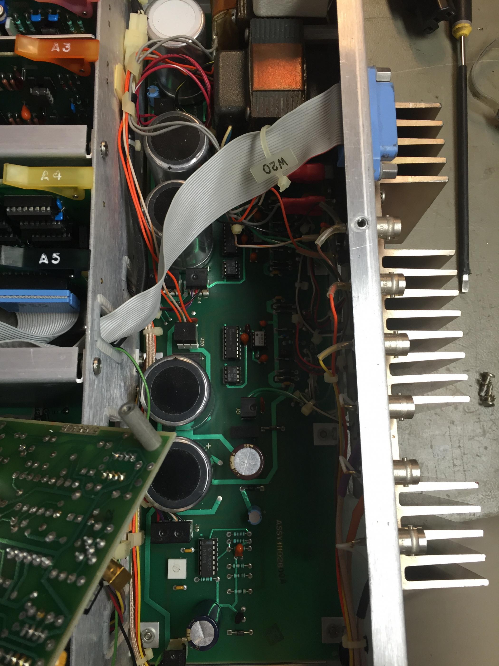

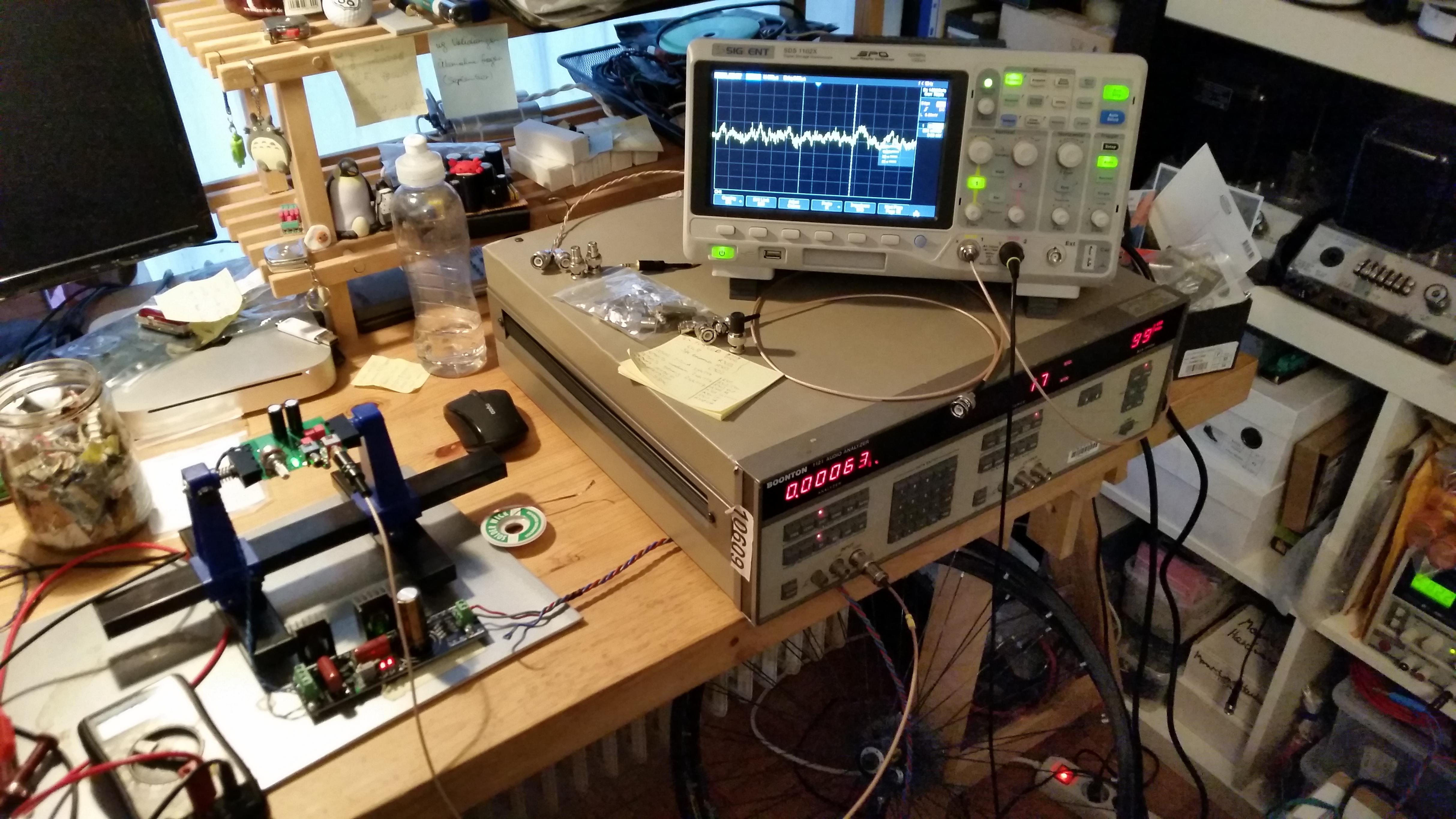

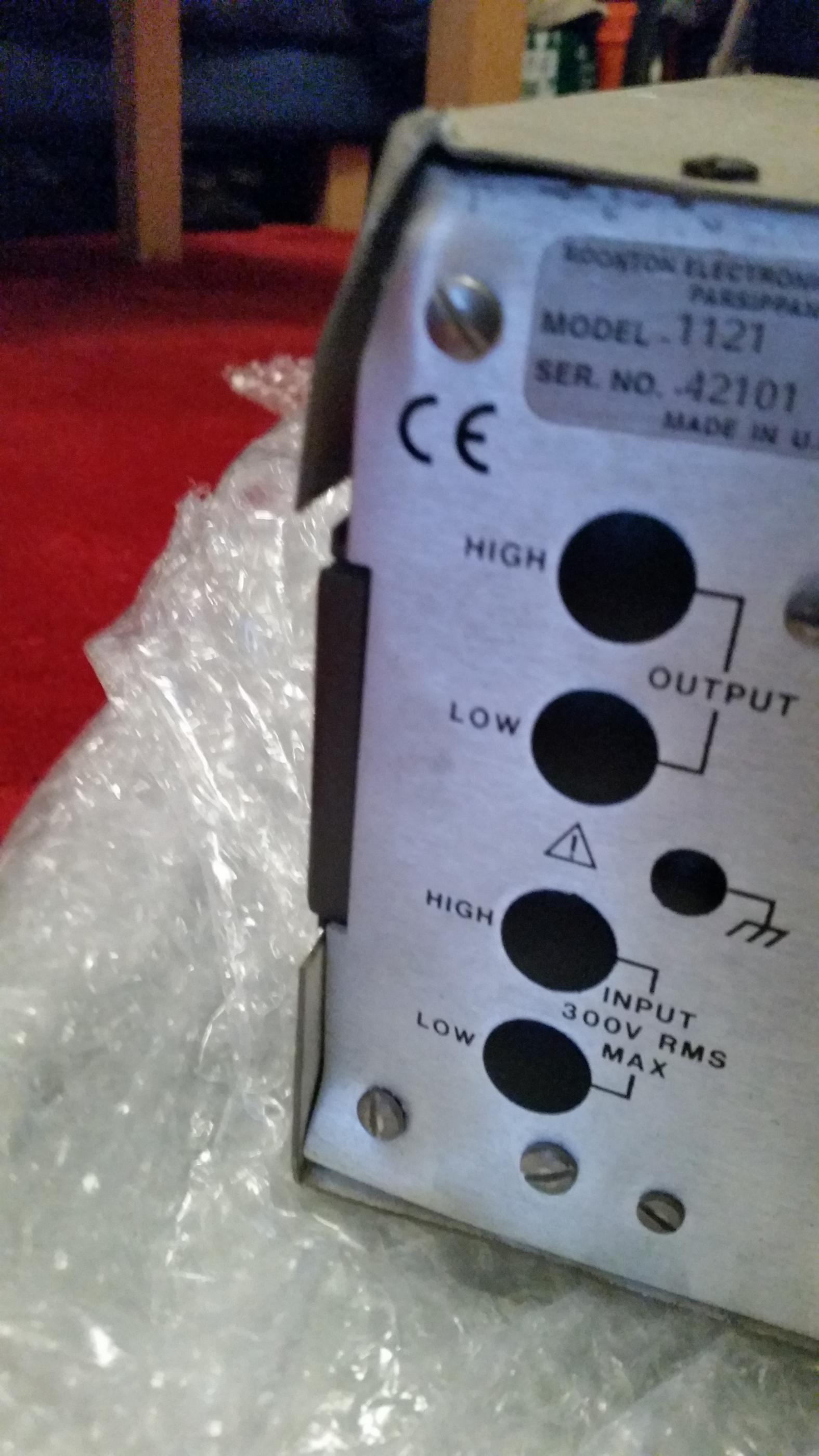

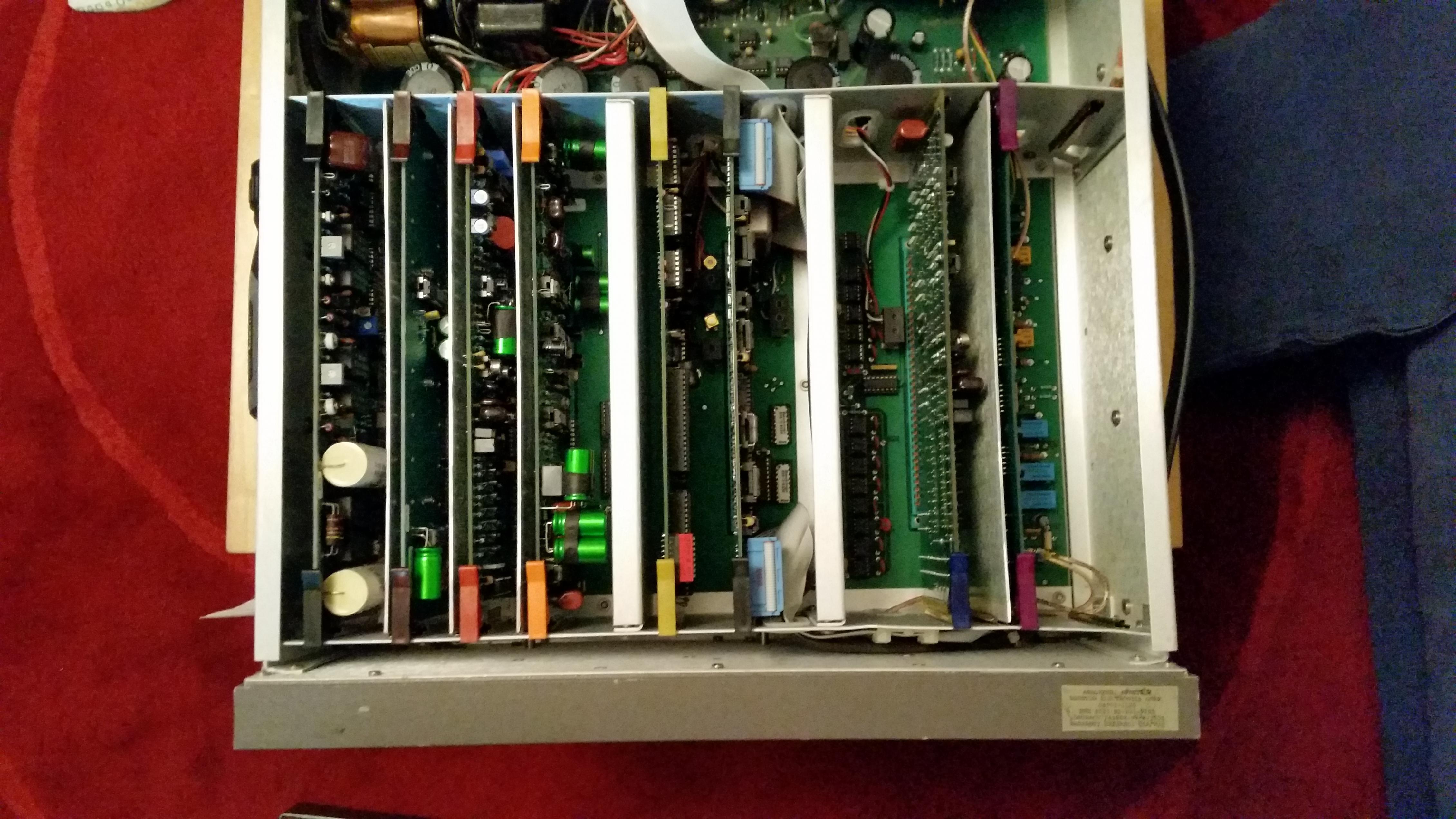

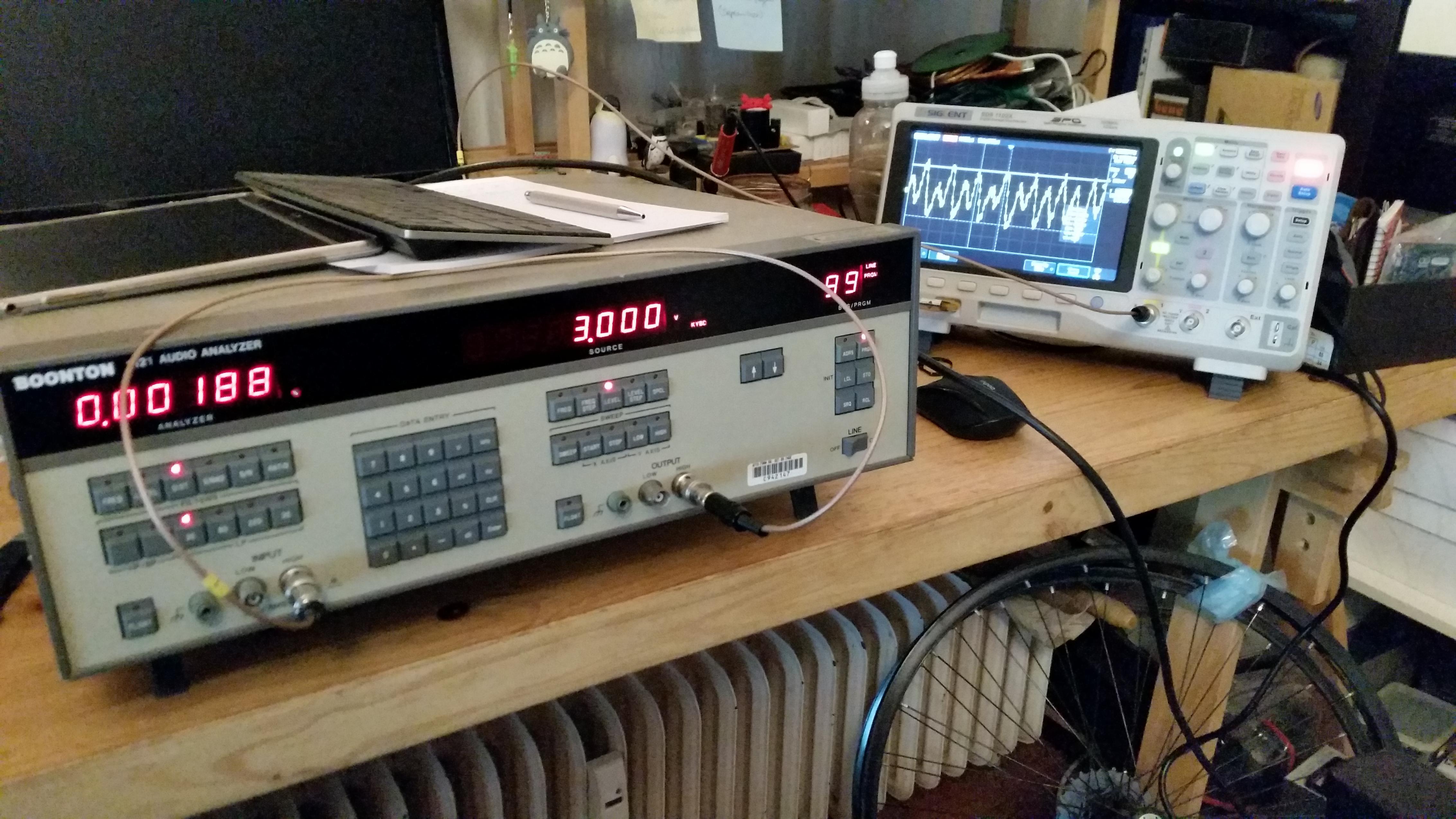

Finally got the 1121 working again!

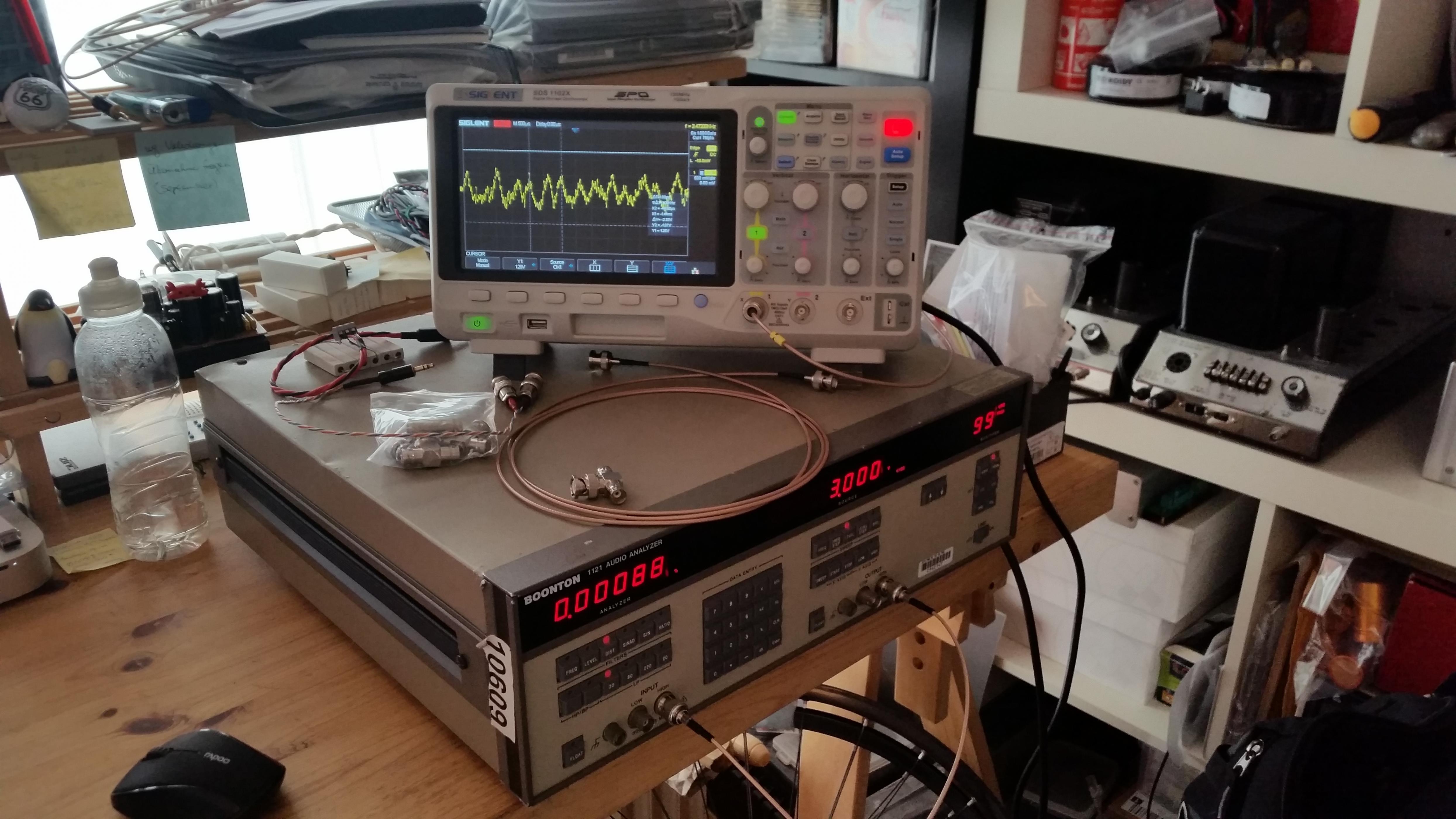

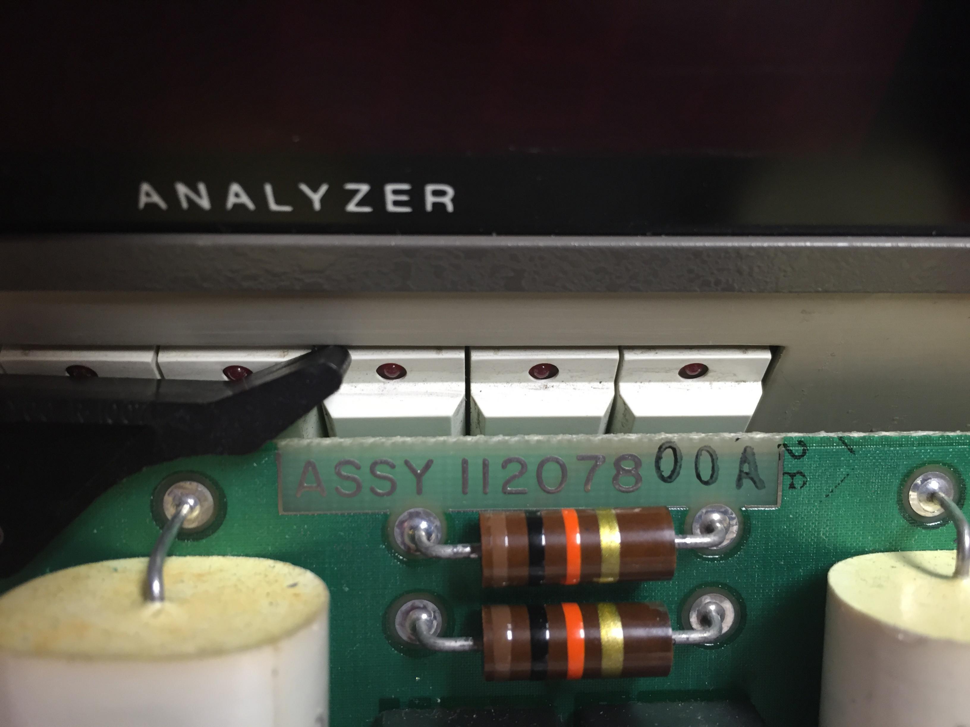

The first two pictures show how badly beaten up the 1121 got during shipping. The third picture was taken after doing the mods, but before straightening out the chassis. The unit wasn't reliably working because the frame was so bent out of shape that the daughter boards wouldn't properly contact the sockets. So I decided to completely disassemble the 1121, bent every single piece back into shape and then reassemble it again, hoping it would cure the issues. And it did 🙂

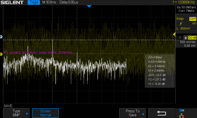

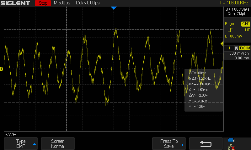

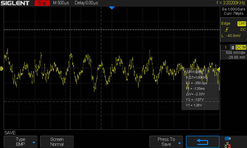

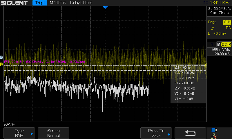

The fourth picture shows the 1121 operating in its unaltered state. The scope is connected to the monitor output, a screendump of which is shown in the 5th picture, along with an FFT in the 6th picture.
The 7th pic shows the 1121 operating in its modded state, after straightening out the chassis. All electrolytic caps were replaced with new ones, all coupling caps were replaced with non-polar ones and all the NE5534/32 were replaced with LME49710/20 (see post #80). I also reduced R52 and R54 from 10 ohms to 2 ohms, as was suggested in post #33. The monitor output and an FFT thereof are shown in the 8th and 9th picture. Scaling and settings are identical between the oscilloscope pics. The improvements can be clearly seen. Distortion is still mostly 2nd harmonic.

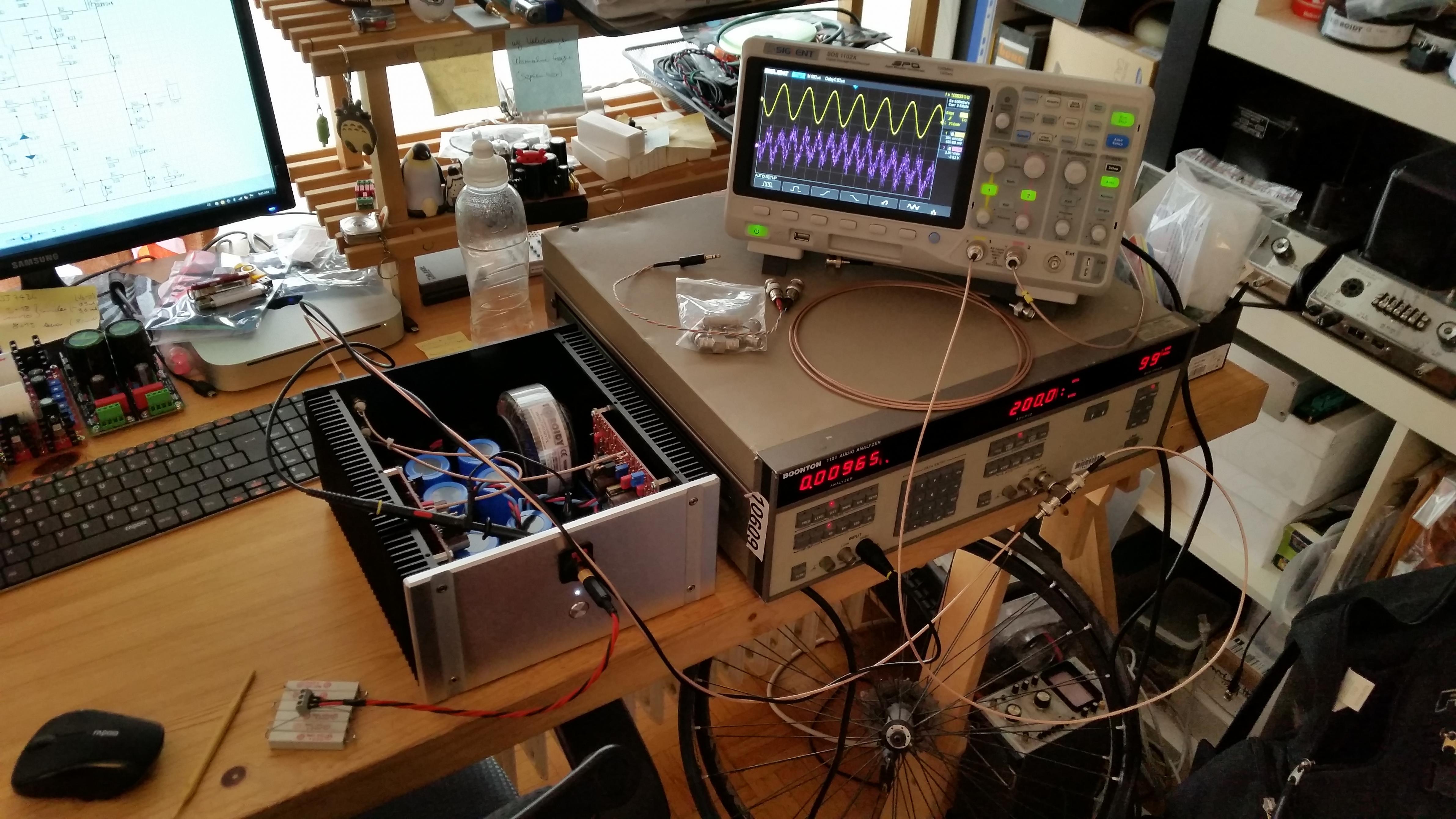

And finally, the last (10th) pic is showing the 1121 in action. I used it to set the AC current gain of my Aleph Headphone amp (see http://www.diyaudio.com/forums/pass-labs/244954-aleph-h-schematic-revealed-last-3.html#post4351290) for minimum distortion. The yellow trace is the output signal of the 1121, and the violet (magenta?) trace is the monitor output of the 1121 with the amp's output connected to the 1121's input.
I noticed some 50/100Hz modulation of the monitor output for small signal levels, as can also be seen in the last pic. Any input/suggestions on that?

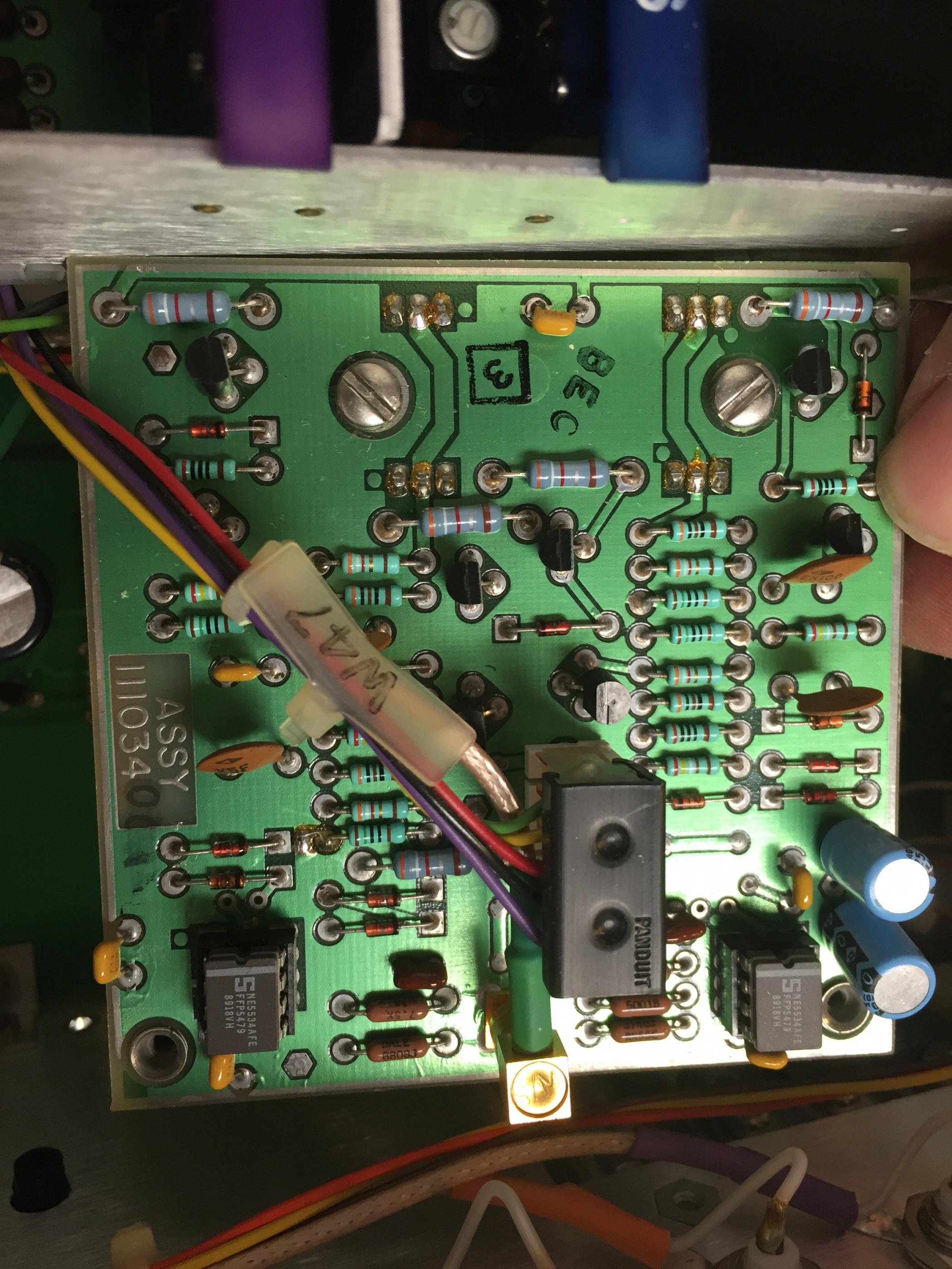

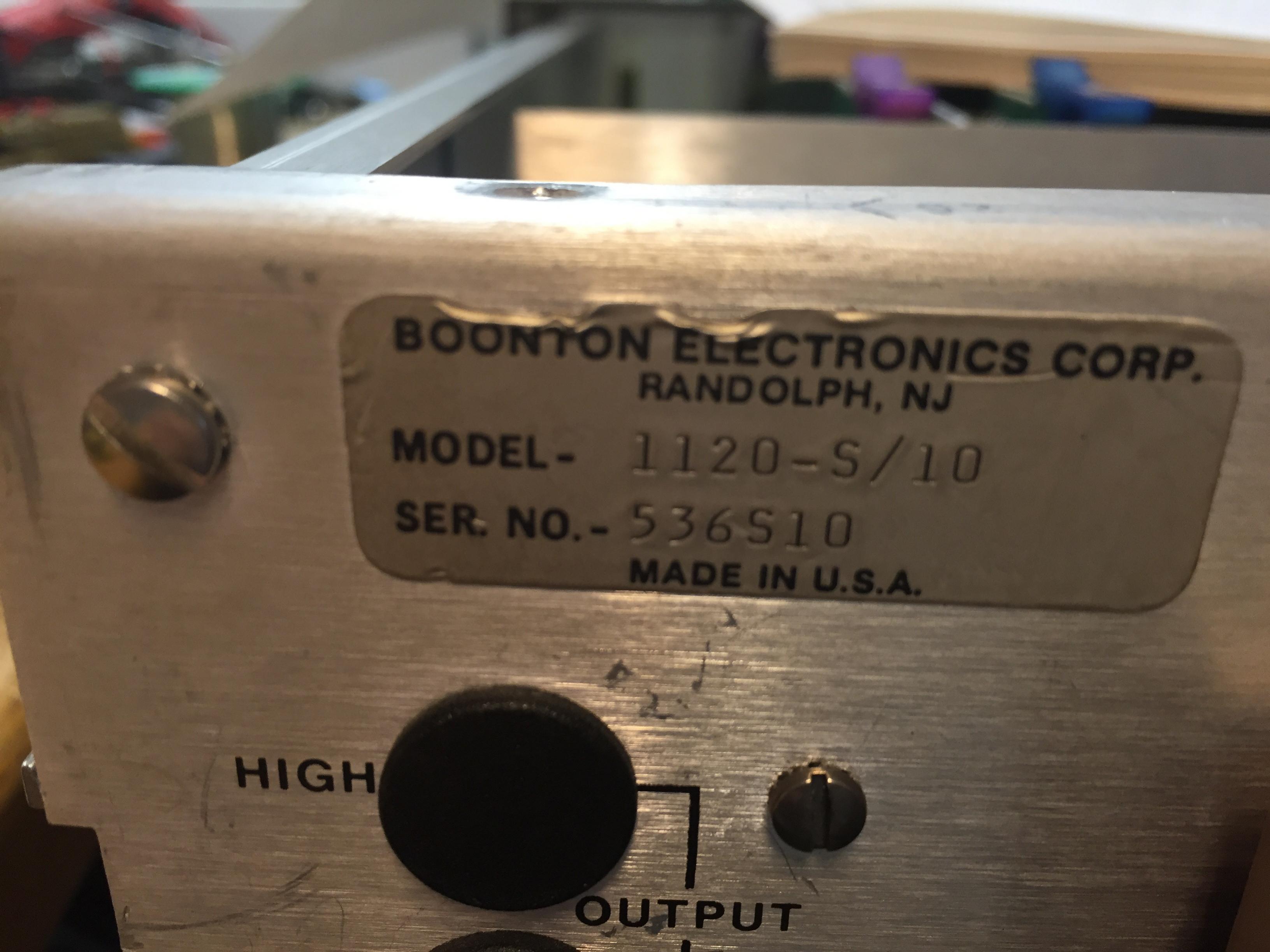

1120/ S10

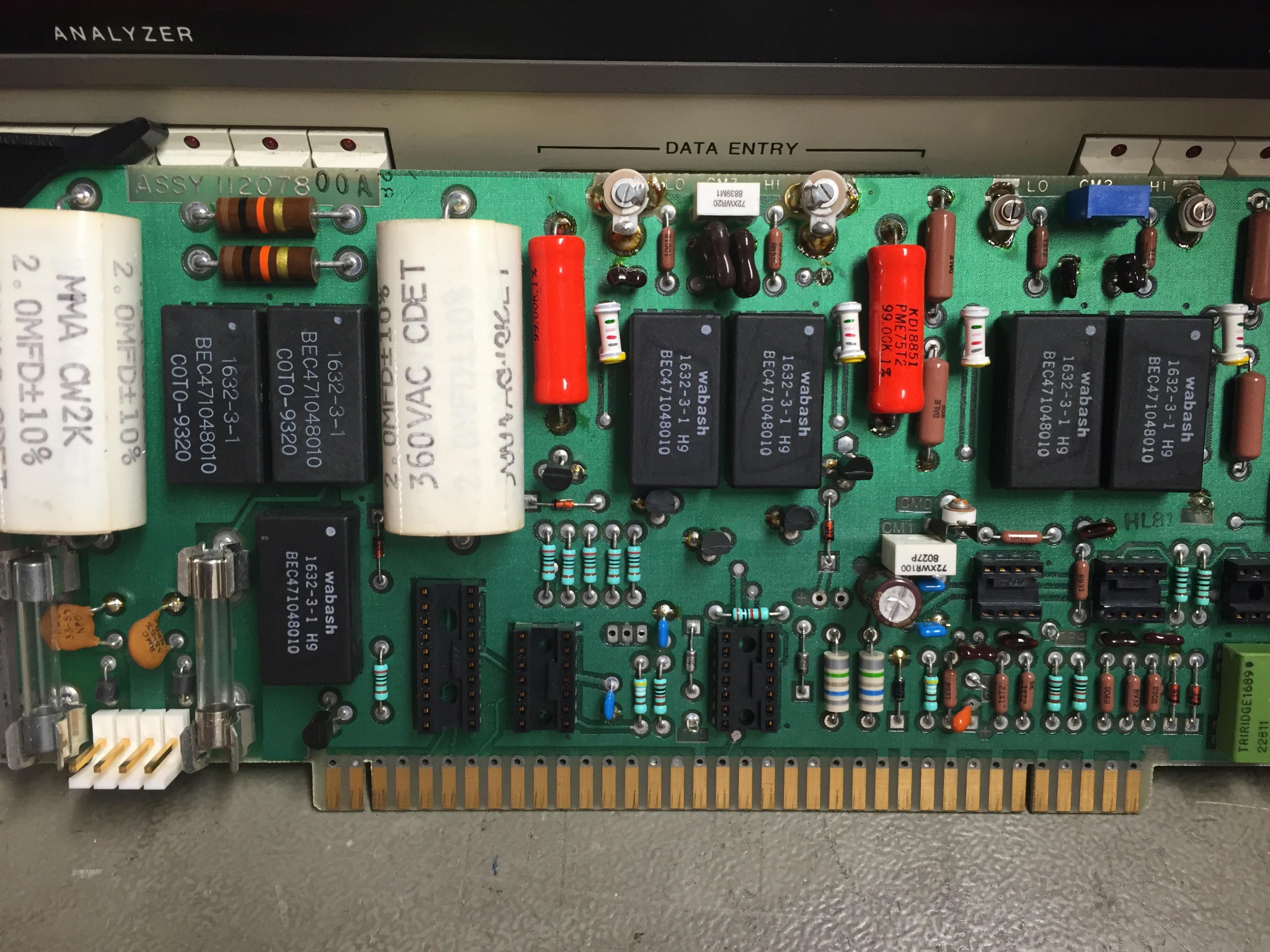

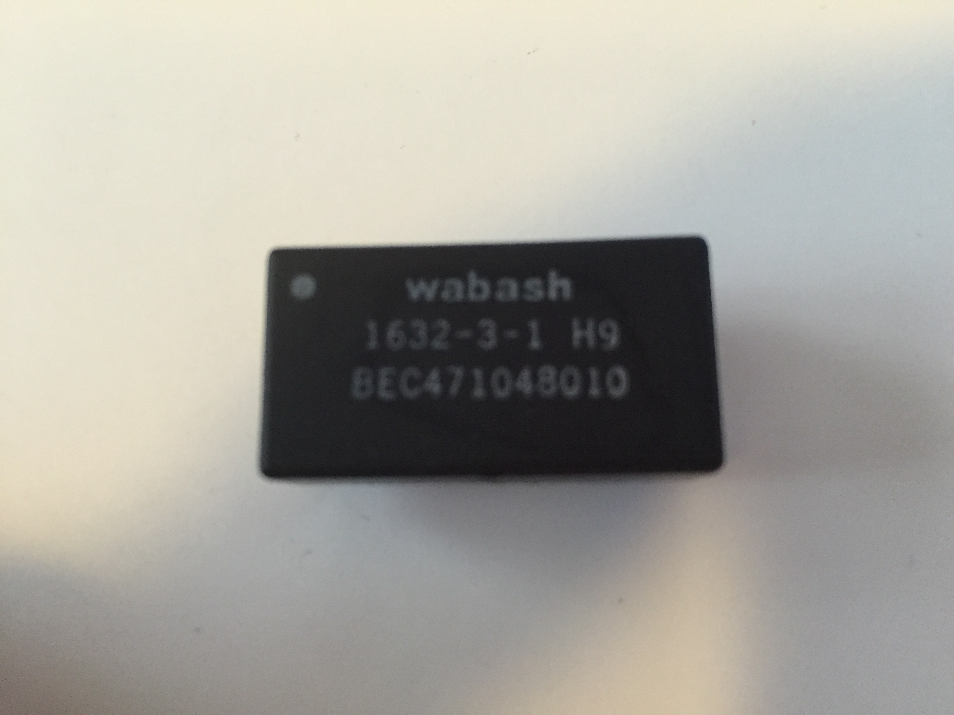

Anybody got schematics for the output amp on a S10? I also need schematic on a input board no 1120 117800A. Something is loading the 5V line down to 2,8V, and as you can proably imagine, Error 34-33-31 and all that nuisance.
The source works just fine when the input board is pulled.
Roar

Its listed in both the 1120 and 1121 manual as a 15V pseudo form C reed relay, part number Wabash 1632-3-1 which seems to be a dead end. Later units have an identical relay labeled Coto. Functionally K9 is a single form C relay and it seems a Coto 7141 12V relay would fit and work in that location. Here is a link to a datasheet http://cotorelay.com/wp-content/uploads/2014/09/7000_series_reed_relay_datasheet.pdf Digikey has what seems to be the wrong version: 7141-12-1011 Coto Technology | Relays | DigiKey I think the desired part would be 7141-12-11XX but i need someone else checking. If bending leads is an OK option then more alternatives exist- 12V spdt relay . The coil is top to bottom. Check the PCB layout for the contact arrangement but it is based on reed relays so they are straight across.
Thanks for your digging Demian. I searched for the relay myself, with the same result as you. I have also mailed Boonton in the hope of getting some parts from them, but no result thus far.
I might end up buying complete input board from Israel.

At the price they are asking vs. cost of the relays alone its worth doing. There are a few small changes between models.
Another immediate fix would be to pull K3 and install for K9. K3 just shorts the neg input and causes more problems than it helps. Just short the neg input externally for single ended input at the DUT, lower noise anyway. I have replaced fuses too often and fried 2 of the K3 relays.
