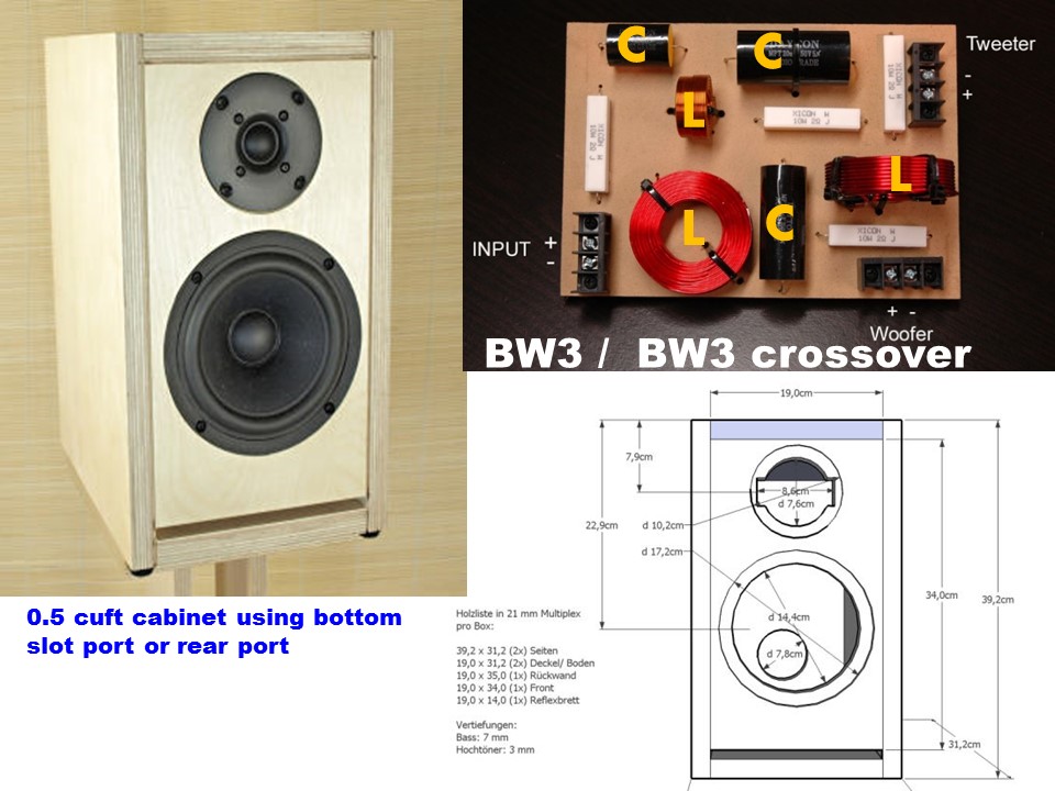

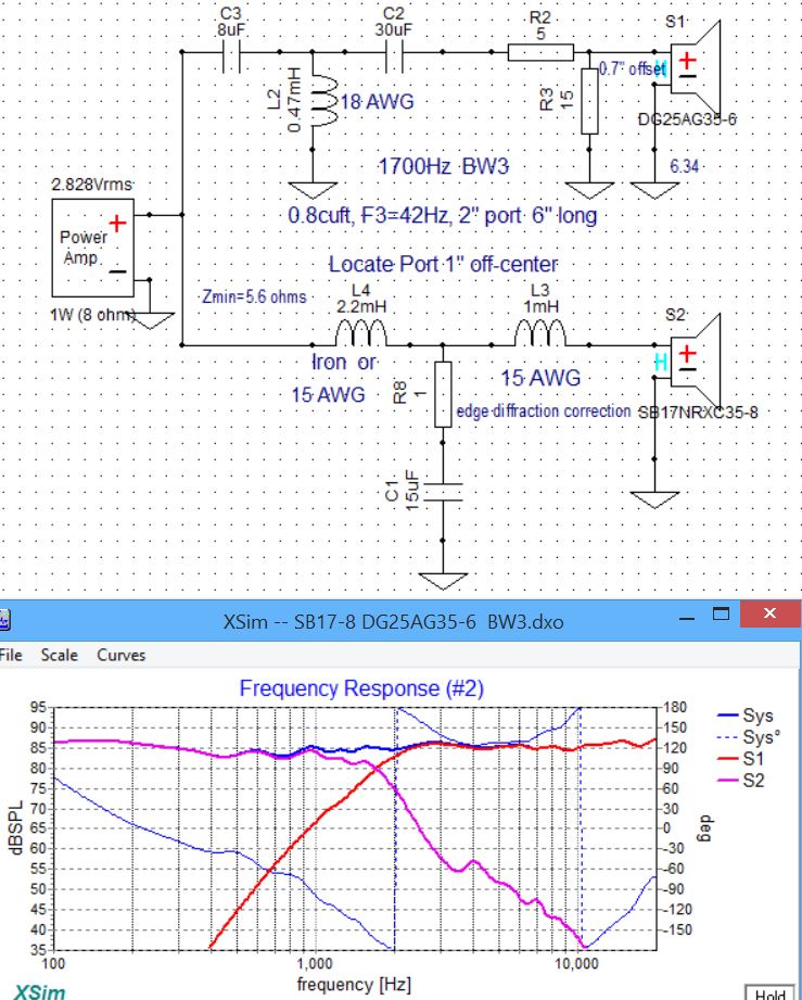

Seems correct, although one resistor is missing respect to the previous photo. I don't see a problem in the cap/coil placement in the upper left, but you can place them apart easily positioning the coil in the mid point between the two blocks of HP caps.See photo attached.
A bass reflex box usually needs some acoustic damping, but you have to try. Start applying some on the walls.I’m thinking about buying some “egg crate” acoustic foam to stick inside my mdf bass reflex enclosures.
