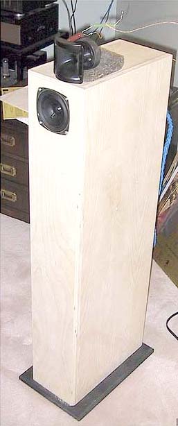

I'm not all that familiar with the VIFA line... Madisound has a similar tweeter* for about $25, and the P13 is $37. Add a cap and you are in the $130 region for a set of drivers. You could even add a 2nd bass driver (use on the back for BSC) and still be just over $200 ... i haven't heard the Frias design, but it would have to be very good to beat this combo.
*the trick is to get one of the chambered ones that goes low, is the same sensitivity, and doesn't have any nasties to worry about. I'm sure that their are a few others that would fit the criteria.
The TLb uses this combo.
And my buddy Chris replaced the ceramic Linn Tweeters on his Dalines with a tweaked set of the same tweeters (amazing what a little TLC will do). He started out with an optimum flat, many part XO, and ended up with a single cap (in his words, the "trick XO strangled the life out of em").
Lynn Olsen uses the same VIFAs in his Aerials with a big buck ScanSpeak tweeter (the tweaked VIFA is a lot closer to the ScanSpeak than they would like you to know).
Still, the VIFA/VIFA combo still doesn't do some of the things that the FE103A does in a Buschorn -- pictured below with the Radio Shack version of the FE103 -- with or without a supertweeter (and that represents $20 to $100 in drivers depending on how you score your FE103As and what tweeter you use --Chris's Dalines have been relegated to the HT downstairs). The not quite as good, but available FE103E is $32 each and the FE108ES is $85 (In a head to head the predessesor of this -- the FE108Sigma -- is very close, but different, to the FE103A, it's a toss-up). The FE206 is about the same price as the FE108ES-- just have a look here and the FR Forum for comments on this.
dave
